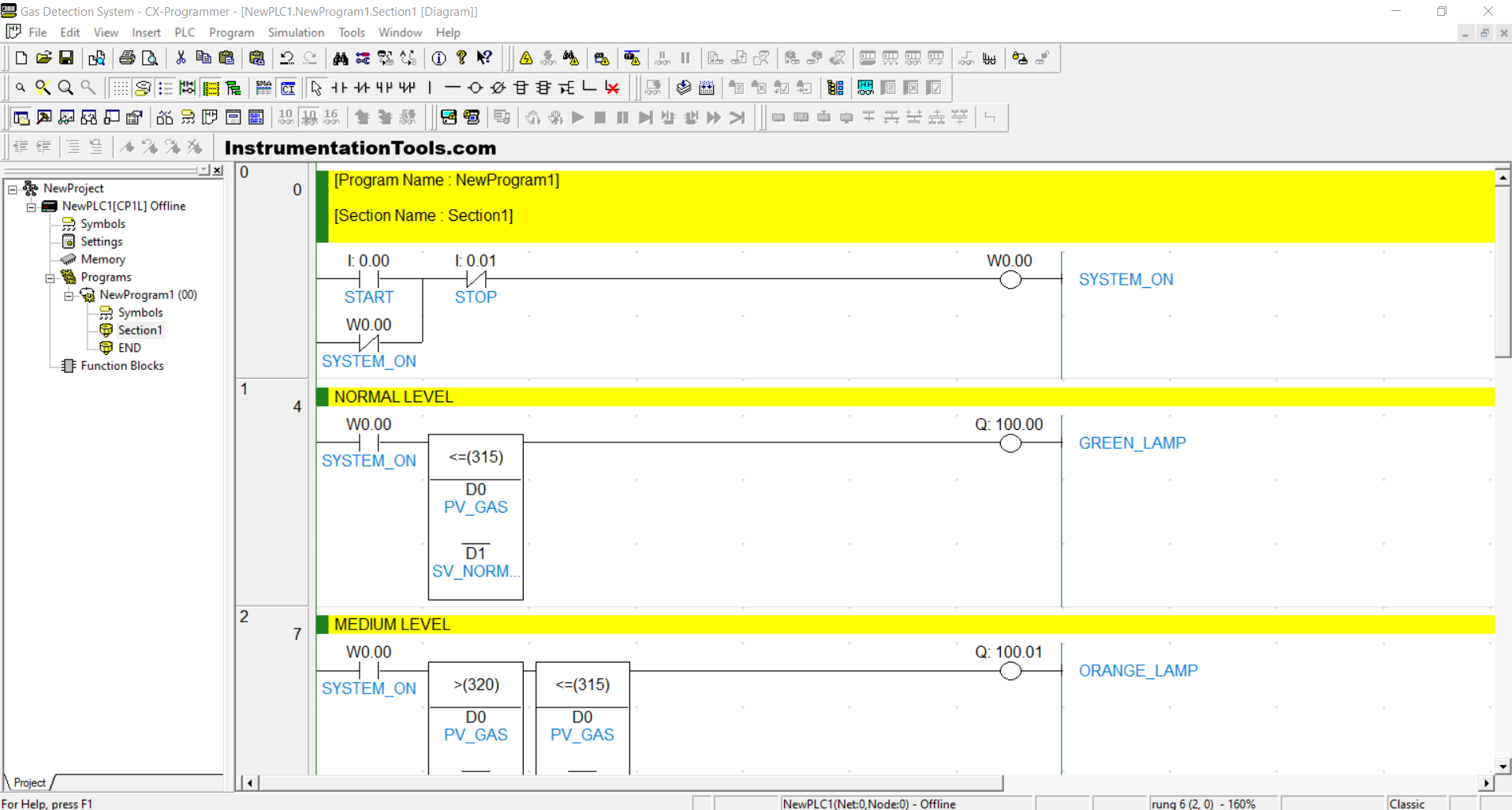

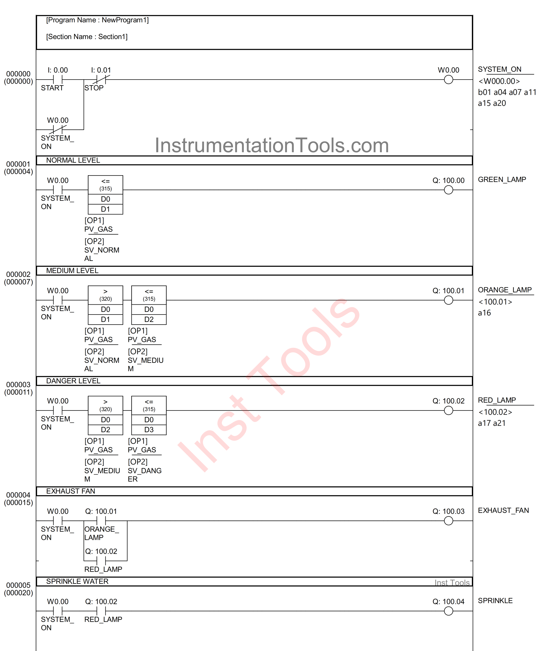

RUNG 0
In this Rung, if the START (0.00) button is pressed, then the memory bit SYSTEM_ON (W0.00) will be in a HIGH state. Because it uses Latching, the memory bit SYSTEM_ON (W0.00) will remain in a HIGH state even though the PB_START (0.00) button has been released.
The memory bit SYSTEM_ON (W0.00) will return to a LOW state if the STOP (0.01) button is pressed.
RUNG 1 (NORMAL LEVEL)
In this Rung, when the NO contact of the memory bit SYSTEM_ON (W0.00) is in a HIGH state and the value in the memory words PV_GAS (D0) is Less Than Or Equal To SV_NORMAL (D1), then the GREEN_LAMP (100.00) output will be ON.

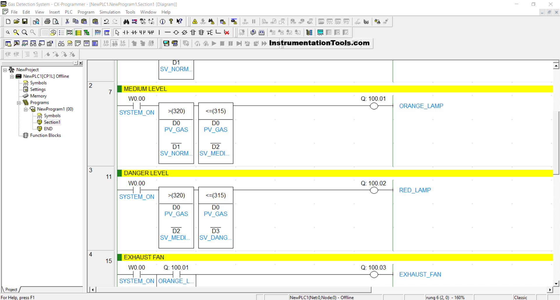

RUNG 2 (MEDIUM LEVEL)
When the NO contact of the memory bit SYSTEM_ON (W0.00) is in the HIGH state and the value of the memory words PV_GAS (D0) is Greater Than SV_NORMAL (D1) and Less Than Or Equal To SV_MEDIUM (D2), the ORANGE_LAMP (100.01) output will be ON.

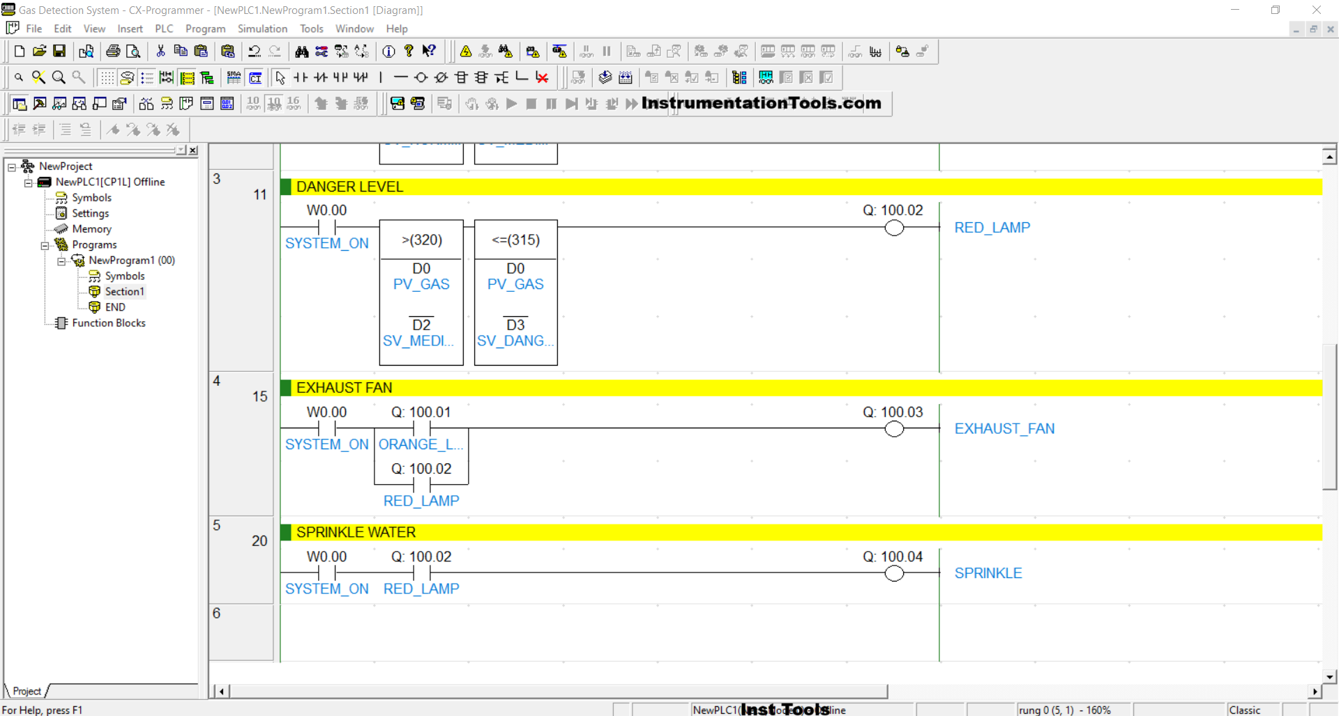

RUNG 3 (DANGER LEVEL)
When the NO contact of the memory bit SYSTEM_ON (W0.00) is in the HIGH state and the value of memory words PV_GAS (D0) is Greater Than SV_MEDIUM (D2) and Less Than Or Equal To SV_DANGER (D3), the RED_LAMP (100.02) output will be ON.
RUNG 4 (EXHAUST FAN)
In this rung, when the NO contact of the memory bit SYSTEM_ON (W0.00) and either the NO contact of ORANGE_LAMP (100.01) or RED_LAMP (100.02) are in a HIGH state, the output EXHAUST_FAN (100.03) will turn ON.
RUNG 5 (SPRINKLE WATER)
In this Rung, when the NO contact of the memory bit SYSTEM_ON (W0.00) and RED_LAMP (100.02) are in the HIGH state, then the SPRINKLE (100.04) output will be ON.
