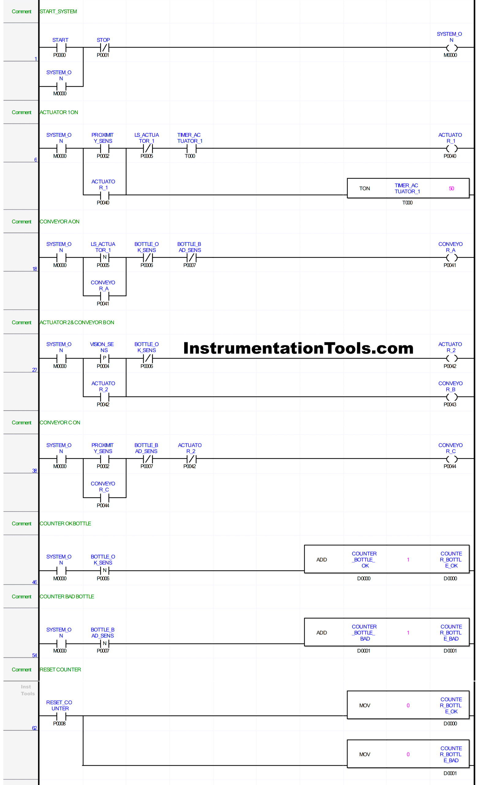

PLC Program

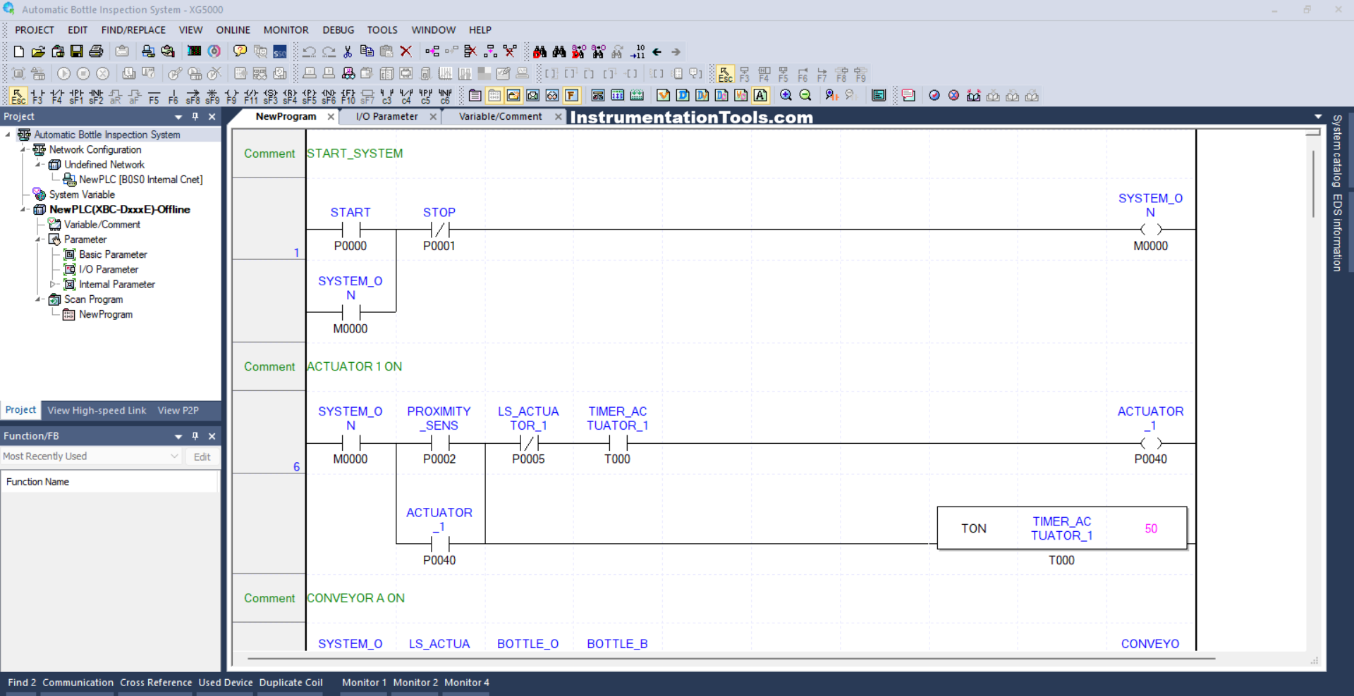

RUNG 1 (START_SYSTEM)
In this Rung, the memory bit SYSTEM_ON (M0000) will be in the HIGH state when the START (P0000) button is Pressed. Because it uses Latching, the memory bit SYSTEM_ON (M0000) will remain in the HIGH state even though the START (P0000) button has been Released.
The memory bit SYSTEM_ON (M0000) will be in the LOW state if the STOP (P0001) button is Pressed.
RUNG 3 (ACTUATOR 1 ON)
In this Rung, when the NO contact of memory bit SYSTEM_ON (M0000) and sensor PROXIMITY_SENS (P0002) are in the HIGH state, the TIMER_ACTUATOR_1 (T000) Timer will Start counting up to 5 seconds.
After Timer TIMER_ACTUATOR_1 (T000) has finished counting, the output ACTUATOR_1 (P0040) will be ON. Because it uses Latching, the ACTUATOR_1 (P0040) output will remain ON even though the NO contact of the sensor PROXIMITY_SENS (P0002) is in the LOW state.
The output ACTUATOR_1 (P0040) will return OFF if the NC contact of Limit Switch LS_ACTUATOR_1 (P0005) is in the HIGH state.

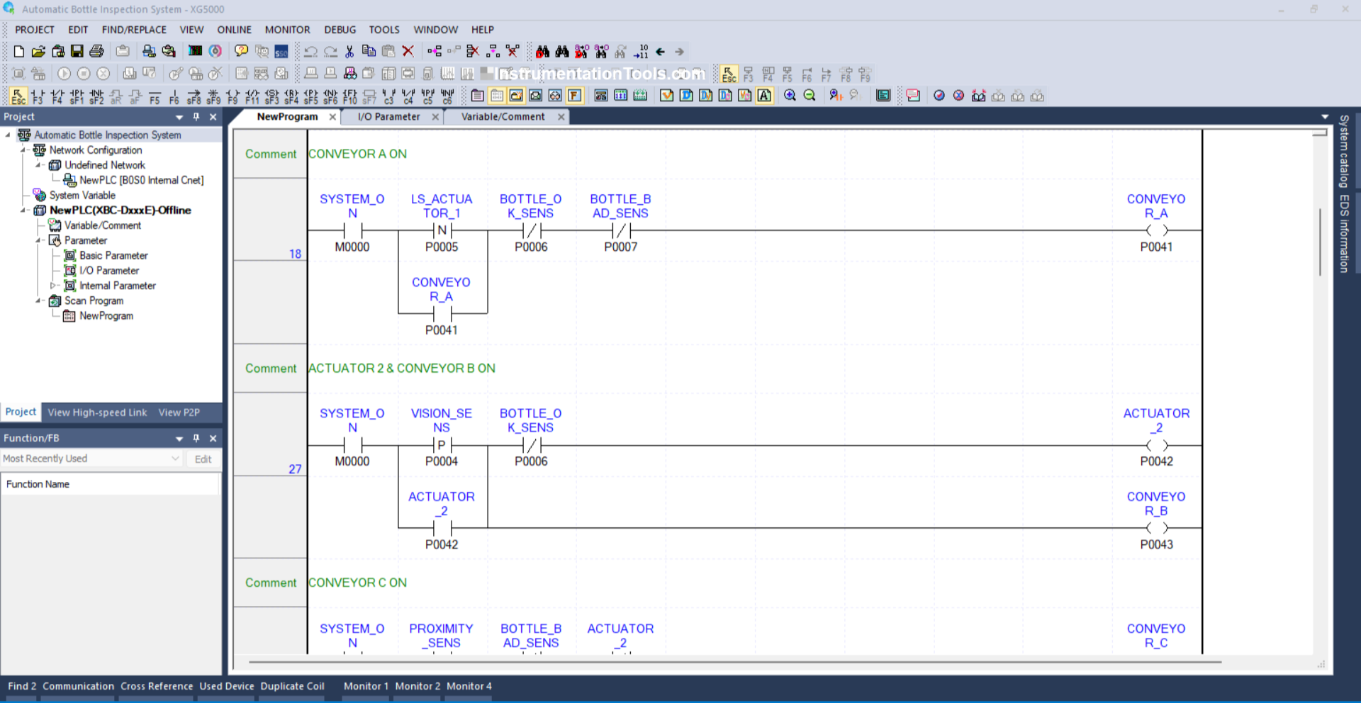

RUNG 18 (CONVEYOR A ON)
In this Rung, if the NO contact of memory bit SYSTEM_ON (M0000) and the Limit Switch LS_ACTUATOR_1 (P0005) are in the HIGH state, then the CONVEYOR_A (P0041) output will be ON. Because it uses Latching, the CONVEYOR_A (P0041) output will remain ON even though the NO contact of the Limit Switch LS_ACTUATOR_1 (P0005) is in the LOW state.
The CONVEYOR_A (P0041) output will return OFF if the NC contact of Sensors BOTTLE_OK_SENS (P0006) and BOTTLE_BAD_SENS (P0007) are in the HIGH state.
RUNG 27 (ACTUATOR 2 & CONVEYOR B ON)
When the NO contact of memory bit SYSTEM_ON (M0000) and sensor VISION_SENS (P0004) are in the HIGH state, the outputs CONVEYOR_B (P0042) and ACTUATOR_2 (P0042) will be ON. Because it uses Latching, the outputs CONVEYOR_B (P0042) and ACTUATOR_2 (P0042) will remain ON even though the NO contact of Sensor VISION_SENS (P0004) is in the LOW state.
The outputs CONVEYOR_B (P0042) and ACTUATOR_2 (P0042) will be OFF when the NC contact of Sensor BOTTLE_OK_SENS (P0006) is in the HIGH state.

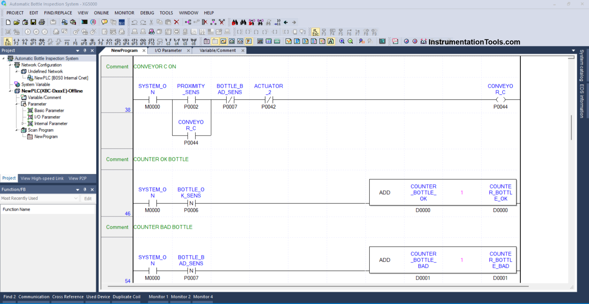

RUNG 38 (CONVEYOR C ON)
When the NO contact of memory bit SYSTEM_ON (M0000) and Sensor PROXIMITY_SENS (P0002) are in the HIGH state, the CONVEYOR_C (P0044) output will be ON. Because it uses Latching, the CONVEYOR_C (P0044) output will remain ON even though the NO contact of Sensor PROXIMITY_SENS (P0002) is in the LOW state.
The CONVEYOR_C (P0044) output will be OFF when the NC contact of Sensors BOTTLE_OK_SENS (P0006) and ACTUATOR_2 (P0042) are in the HIGH state.
RUNG 46 (COUNTER OK BOTTLE)
When the NO contact of memory bit SYSTEM_ON (M0000) and the BOTTLE_OK_SENS (P0006) Sensor are in the HIGH state, the value in the memory word COUNTER_BOTTLE_OK (D0000) will increase (+1). Because it uses the ADD Instruction.

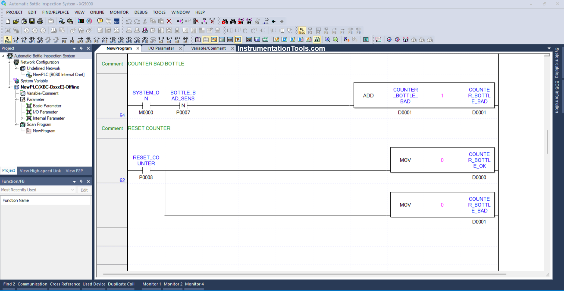

RUNG 54 (COUNTER BAD BOTTLE)
When the NO contact of memory bit SYSTEM_ON (M0000) and Sensor BOTTLE_BAD_SENS (P0007) is in the HIGH state, the value in the memory word COUNTER_BOTTLE_BAD (D0001) will increase (+1). Because it uses the ADD Instruction.
RUNG 62 (RESET COUNTER)
When the RESET_COUNTER (P0008) button is Pressed, the values in the memory words COUNTER_BOTTLE_OK (D0000) and COUNTER_BOTTLE_BAD (D0001) will be reset to zero “0”. Because the MOV instruction moves the zero value “0” to the memory words COUNTER_BOTTLE_OK (D0000) and COUNTER_BOTTLE_BAD (D0001).
