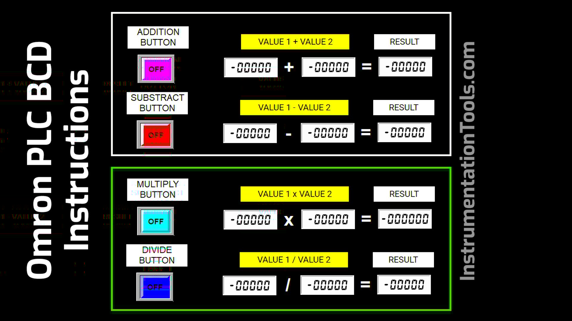

Testing Video
In the video below, we tested this Omron PLC program and displayed the results.
BCD Add, Subtract, Multiply, Divide

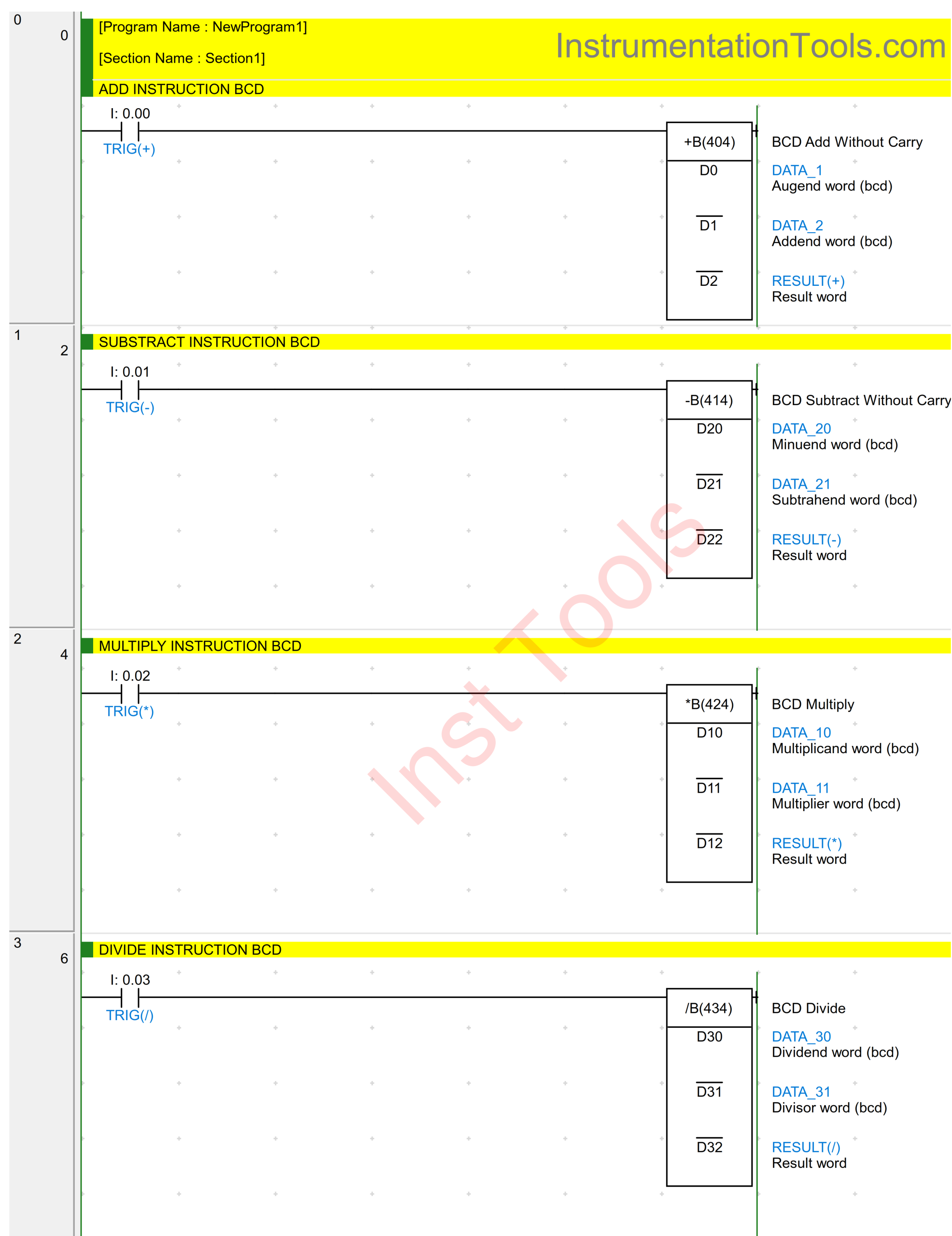

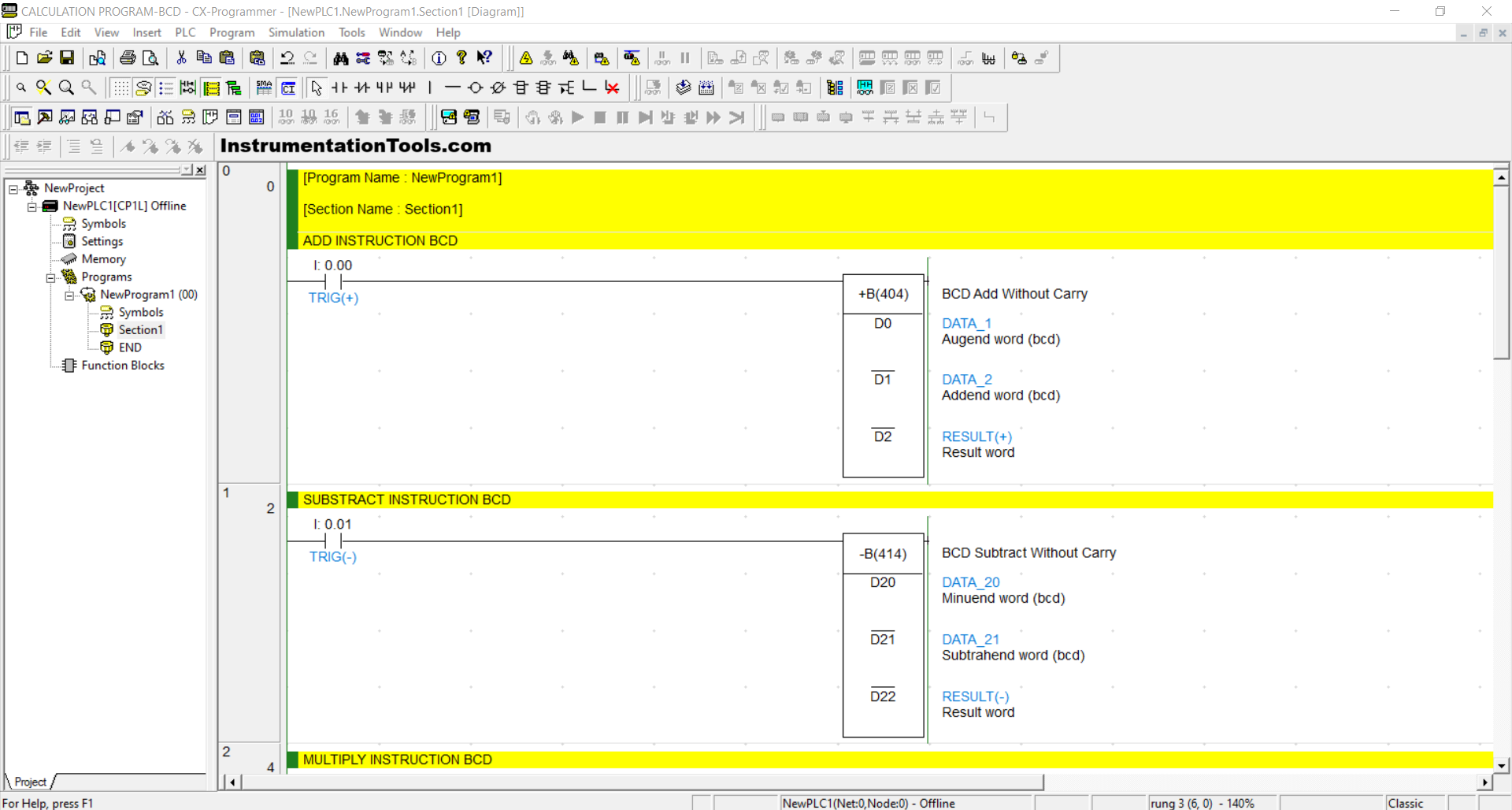

RUNG 0 (ADD INSTRUCTION BCD)
In this Rung, the +B(404) instruction will add the value in the memory word DATA_1 (D0) with the value in the memory word DATA_2 (D1) memory word when the TRIG(+) (0.00) button is pressed. The calculated result value will be entered into the memory word RESULT(+) (D2).
RUNG 1 (SUBSTRACT INSTRUCTION BCD)
In this Rung, the -B(414) instruction will subtract the value in the memory word DATA_20 (D20) from the value in the memory word DATA_21 (D21) when the TRIG(-) (0.01) button is pressed. The calculated result value will be entered into the memory word RESULT(-) (D22).

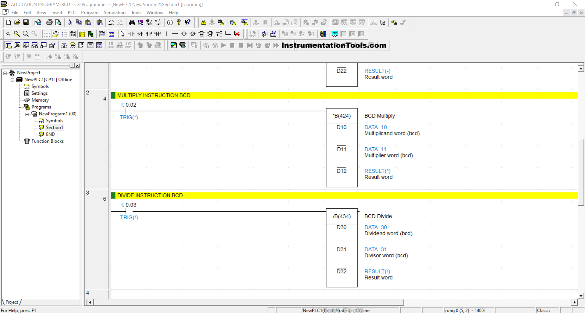

RUNG 2 (MULTIPLY INSTRUCTION BCD)
In this Rung, the *B(424) instruction will multiply the value in the memory word DATA_10 (D10) by the value in the memory word DATA_11 (D11) when the TRIG(*) (0.02) button is pressed. The calculated value will be entered into the memory word RESULT(*) (D12).
RUNG 3 (DIVIDE INSTRUCTION BCD)
In this Rung, the /B(434) instruction will divide the value in the memory word DATA_30 (D30) by the value in the memory word DATA_31 (D31) when the TRIG(/) (0.03) button is pressed. The calculated value will be entered into the memory word RESULT(/) (D32).
