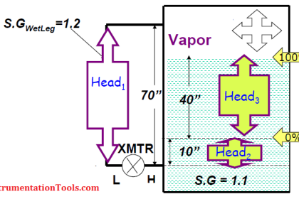

Double Remote Seal Application
Double Remote Seal Application to Measure Level
Calibration Range
LRV or 4mA point = Phigh – Plow
LRV = Head2 – Head1
LRV = (0.9*30”) – (0.9*100”)
LRV = -63”H2O
URV or 20mA Point = Phigh – Plow
URV = (Head2 + Head3) – Head1
URV = [(0.9*30”) + (1.1*50”)] – (0.9*100”)
URV = -8”H2O
Cal. Range = -63 to -8 in H2O
