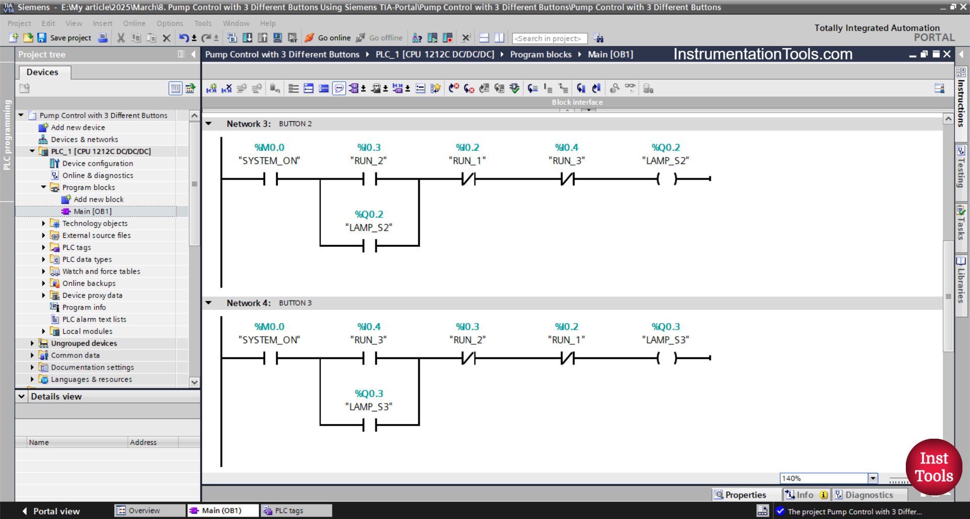

NETWORK 2 (BUTTON 1)
The LAMP_1 (Q0.1) output changes to the ON state, when the NO contact of the memory bit SYSTEM_ON (M0.0) is in a HIGH state and the RUN_1 (I0.2) button is pressed.
Because it uses Latching, the LAMP_1 (Q0.1) output will remain ON even though the RUN_1 (I0.2) button has been released.
When the RUN_2 (I0.3) button or the RUN_3 (I0.4) button is pressed, the LAMP_1 (Q0.1) output will be OFF.
NETWORK 3 (BUTTON 2)
The LAMP_2 (Q0.2) output changes to the ON state when the NO contact of the memory bit SYSTEM_ON (M0.0) is in the HIGH state and the RUN_2(I0.3) button is pressed.
Because it uses Latching, the LAMP_2 (Q0.2) output will remain ON even though the RUN_2 (I0.3) button has been released.
The LAMP_2 (Q0.2) output will be OFF when the RUN_1 (I0.2) button or the RUN_3 (I0.4) button is pressed.
NETWORK 4 (BUTTON 3)
When the NO contact of the memory bit SYSTEM_ON (M0.0) is in the HIGH state and the RUN_3 (I0.4) button is pressed, the LAMP_3 (Q0.3) output changes to the ON state.
Because it uses Latching, the LAMP_3 (Q0.3) output will remain ON even though the RUN_3 (I0.4) button has been released.
The LAMP_3 (Q0.3) output will be OFF if the RUN_1 (I0.2) or RUN_2(I0.3) button is pressed.

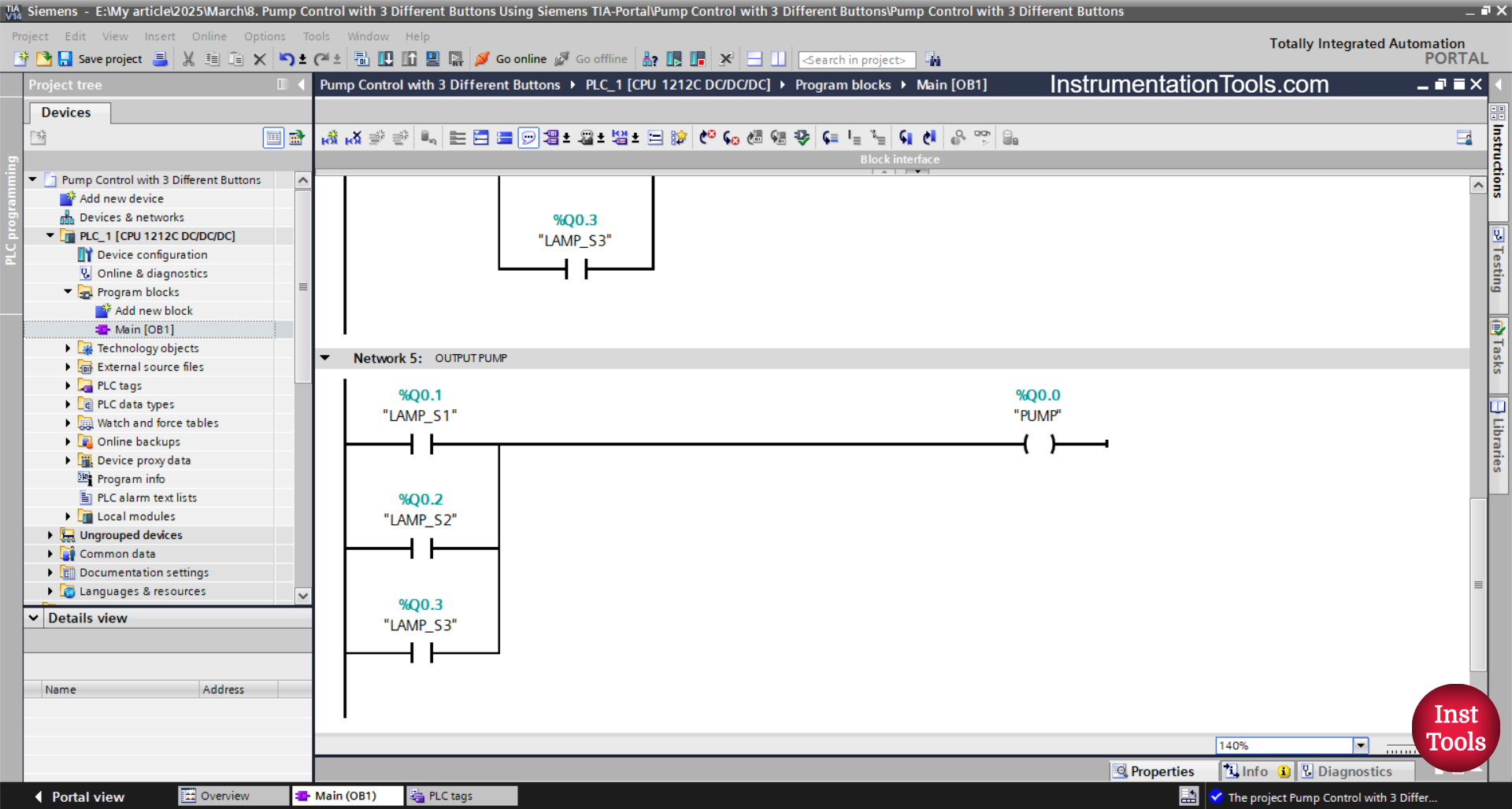

NETWORK 5 (OUTPUT PUMP)
In this network, the output PUMP (Q0.0) turns ON if any one of the NO contacts from LAMP_1 (Q0.1), LAMP_2 (Q0.2), or LAMP_3 (Q0.3) is in a HIGH state.
