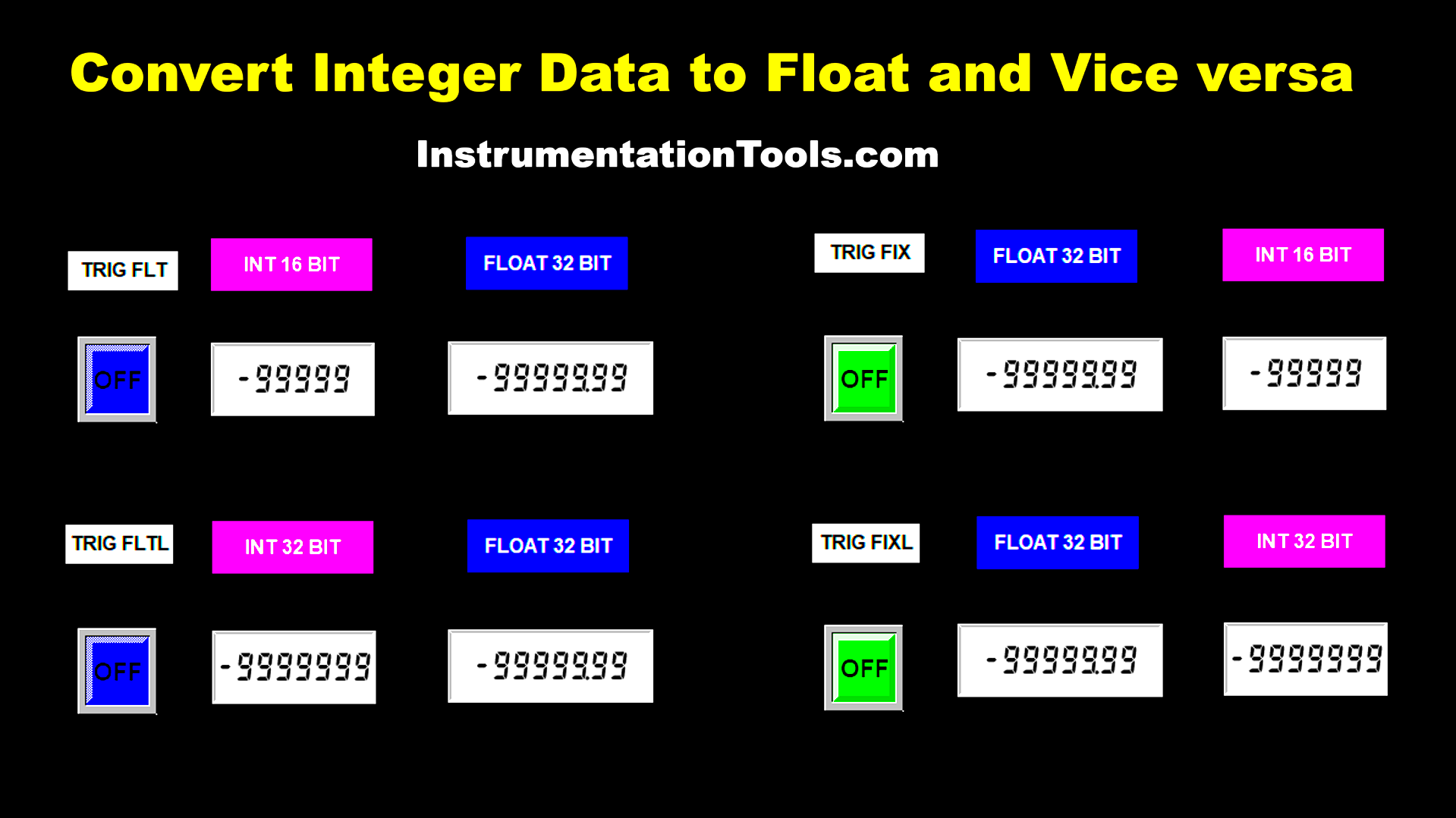

In this program, each instruction will be used to convert values from integer to float and from float to integer. Each instruction has its own trigger, and the given values can be configured.

RUNG 0 (SIGNED BINARY 16 BIT TO FLOAT 32 BIT)
In this Rung, if the TRIGGER_FLT (0.00) button is pressed, the FLT(452) instruction will convert the 16-bit Signed Binary Integer value in the memory word INT_16BIT_DATA1 (D0) to a 32-bit Floating-point value. The converted value will be placed in the memory word FLOAT_32BIT_DATA1(D10).
RUNG 1 (SIGNED BINARY 32 BIT TO FLOAT 32 BIT)
In this Rung, if the TRIGGER_FLTL (0.01) button is pressed, the FLTL(453) instruction will convert the 32-bit Double Signed Binary Integer value in the memory word DINT_32BIT_DATA2 (D2) to a 32-bit Floating-point value. The converted result value will be placed in the memory word FLOAT_32BIT_DATA2 (D16).
RUNG 2 (FLOAT 32 BIT TO SIGNED BINARY 16 BIT)
In this Rung, if the TRIGGER_FIX(0.02) button is pressed, the FIX(450) instruction will convert the 32-bit Floating-point value in the memory word FLOAT_32BIT_DATA3 (D4) to a 16-bit Signed Binary Integer value. The converted value will be placed in the memory word INT_16BIT_DATA3 (D20).
RUNG 3 (FLOAT 32 BIT TO SIGNED BINARY 32 BIT)
In this Rung, if the TRIGGER_FIXL(0.03) button is pressed, the FIXL(451) instruction will convert the 32-bit Floating-point value in the memory word FLOAT_32BIT_DATA4 (D6) to a 32-bit Signed Binary double-integer value. The converted value will be placed in the memory word DINT_32BIT_DATA4 (D26).
