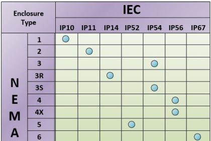

Explain Basic UL / CSA / NEMA Enclosure Types ?
Type 3 : An enclosure which is intended for outdoor use primarily to provide a degree of protection against windblown dust, rain, sleet and damage from external ice formation
Type 3R : An enclosure which is intended for outdoor use primarily to provide a degree of protection against falling rain and damage from external ice formation
Type 3S : An enclosure which is intended for outdoor use primarily to provide a degree of protection against rain, sleet, windblown dust, and to provide for operation of external mechanisms when ice laden
Type 4 : An enclosure which is intended for indoor or outdoor use primarily to provide a degree of protection against windblown rain and dust, splashing water, hose directed water and damage from external ice formation
Type 4X : An enclosure which is intended for indoor or outdoor use primarily to provide a degree of protection against corrosion, windblown rain and dust, splashing water, hose directed water and damage from external ice formation
Type 6 : An enclosure which is intended for indoor or outdoor use primarily to provide a degree of protection against falling dirt, hose directed water, the entry of water during occasional temporary submersion at a specified depth and damage from external ice formation.
Type 6P : An enclosure which is intended for indoor or outdoor use to primarily to provide a degree of protection against falling dirt, hose directed water and the entry of water during prolonged submersion at a specified depth and damage from external ice formation.
