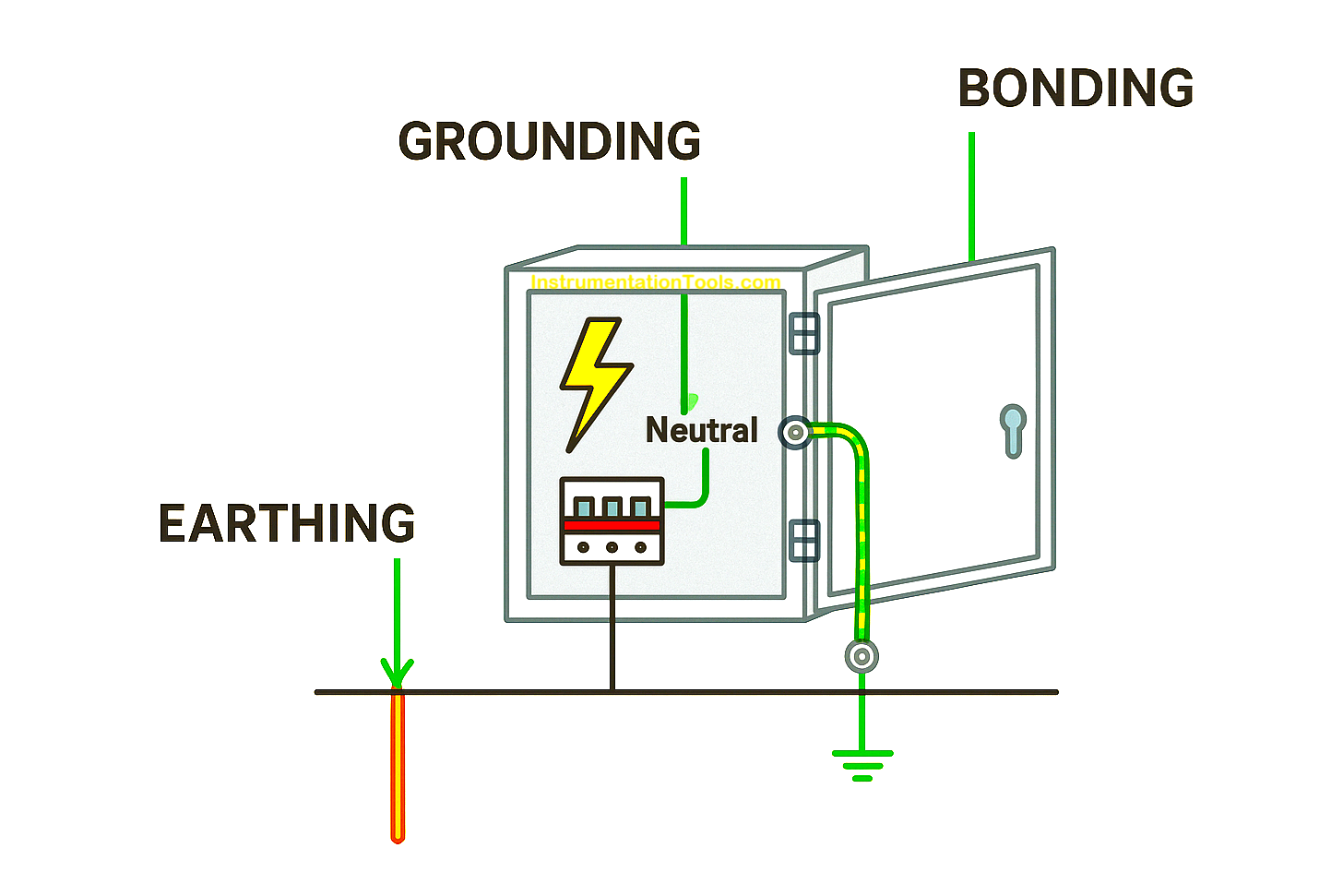

Difference between earthing, grounding, and bonding
Now, we must understand the three terms before discussing our topic: earthing, grounding, and bonding. Refer to the image below for more understanding. In the image, you see a circuit breaker. The circuit breaker is a live component that controls the flow of current through it and trips the circuit in case of any fault. The circuit breaker will have a point for an earthing connection. The panel in which the breaker is mounted too has a screw point for connecting earthing wire. Now, the door is a metallic part, making it easy to conduct current. The door must thus be connected to the panel earth point, to make it available to the ground path. This is done by joining a metallic conductor or wire; the process is called bonding.
What is Electrical Panel Door Earth Bonding? Explained
So, basically, earthing and grounding are the same terms and concepts, as both connect to the earth pit. But to be precise, according to IEC standards, when you connect a non-current-carrying part like a panel body to the earth, it is called earthing. When you connect a live, current-carrying part, like the breaker to the earth, it is called grounding. When you connect two parts, either current-carrying or non-current-carrying, with each other, so that both of them are at the same earth potential, then it is called bonding. All the terms are related to each other, with only a slight difference between them. Bonding is just a way to join two parts, and is not actually connected directly to the earth point. This ensures that all the points are at the same earth potential.
