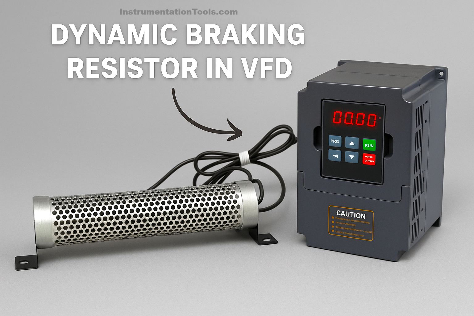

What is a dynamic braking resistor?
Dynamic Braking Resistor in VFD
A dynamic braking resistor, or DBR, is a component that acts as a resistance for blocking the flow of current through it. It is used to consume the dissipated regeneration energy from the motor when it stops. A VFD has two terminals: DC+ and DC-. The DBR is connected to this DC bus, and not between the AC output lines of the motor and the VFD output. Now, between the inverter in VFD and the three-phase output, a braking chopper is used. When the regeneration energy comes from the motor, the chopper detects it and diverts this energy into the DC bus terminal, where the DBR will absorb it. Due to this, the current will not flow further, and the heat and power have thus been dissipated safely into the DBR. Some VFDs will have in-built braking choppers, whereas some will require it externally; so, contact the VFD vendor for more details.
