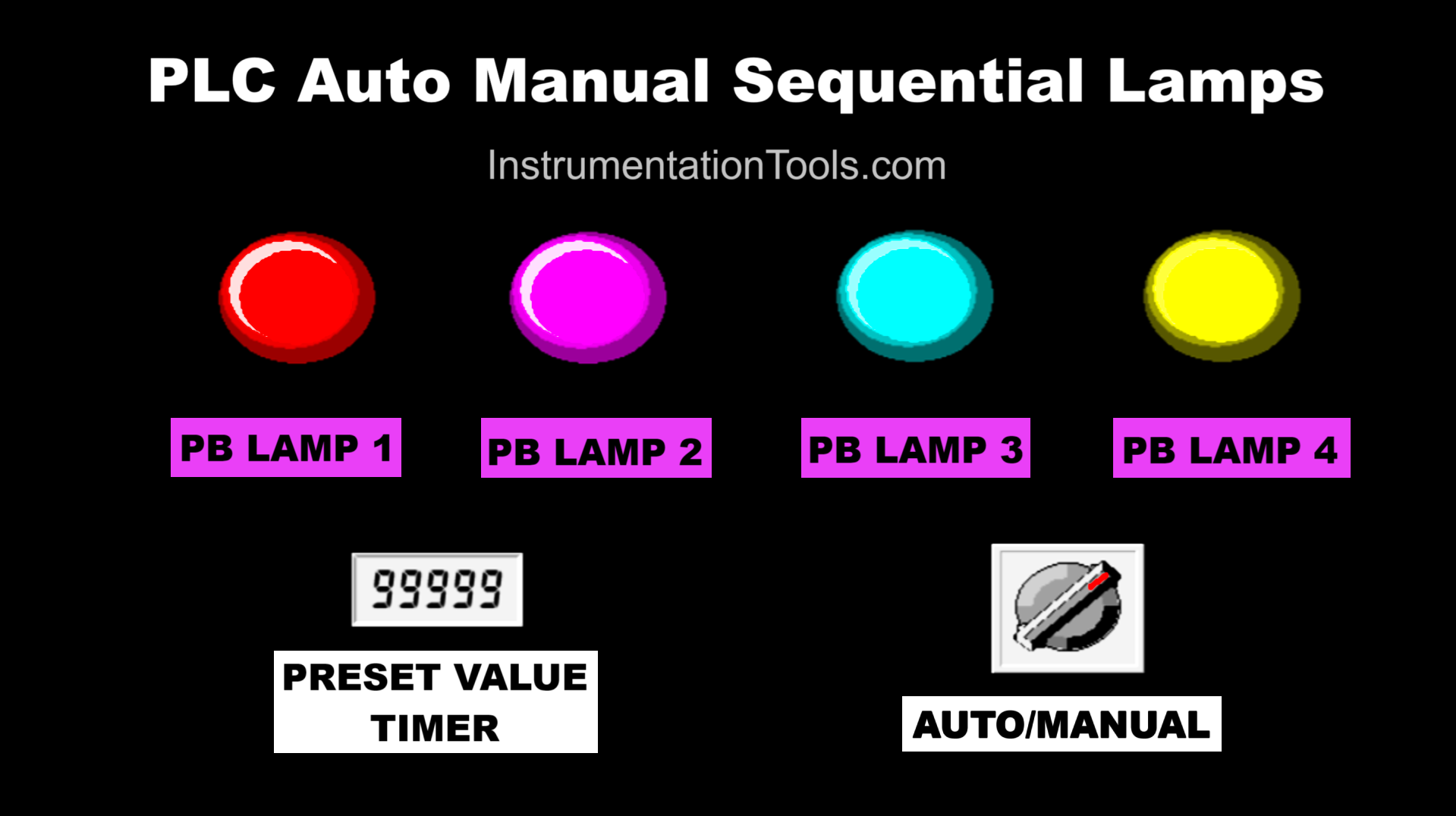

This article will discuss a Sequential Control System that can be operated in either Auto or Manual mode using XGB PLC program. The system will control four Lamps to turn on sequentially in a specific order. All lights will turn on at specific intervals, and the timer’s preset value can be adjusted. When the system is running in Manual mode, each Lamp can only be turned on using a button.
Program Objective
Sequence System:
Auto Mode: The selector switch needs to be changed to the “Auto” position to run the system in Automatic mode. In this mode, the Preset Value Timer parameter needs to be set.
Manual Mode: The selector switch needs to be changed to the “Manual” position. Each lamp can only be turned on by its corresponding button.
When the system has been run in “Auto” mode:
- Lamp-1 turns On.
- Lamp-1 turns Off and Lamp-2 turns On.
- Lamp-2 turns Off and Lamp-3 turns On.
- Lamp-3 turns Off and Lamp-4 turns On.
- All lamps will turn on again in the same sequence with the same time interval.
When the system has been run in “Manual” mode:
- Button-1 turns On Lamp-1.
- Button-2 turns On Lamp-2.
- Button-3 turns On Lamp-3.
- Button-4 turns On Lamp-4.
