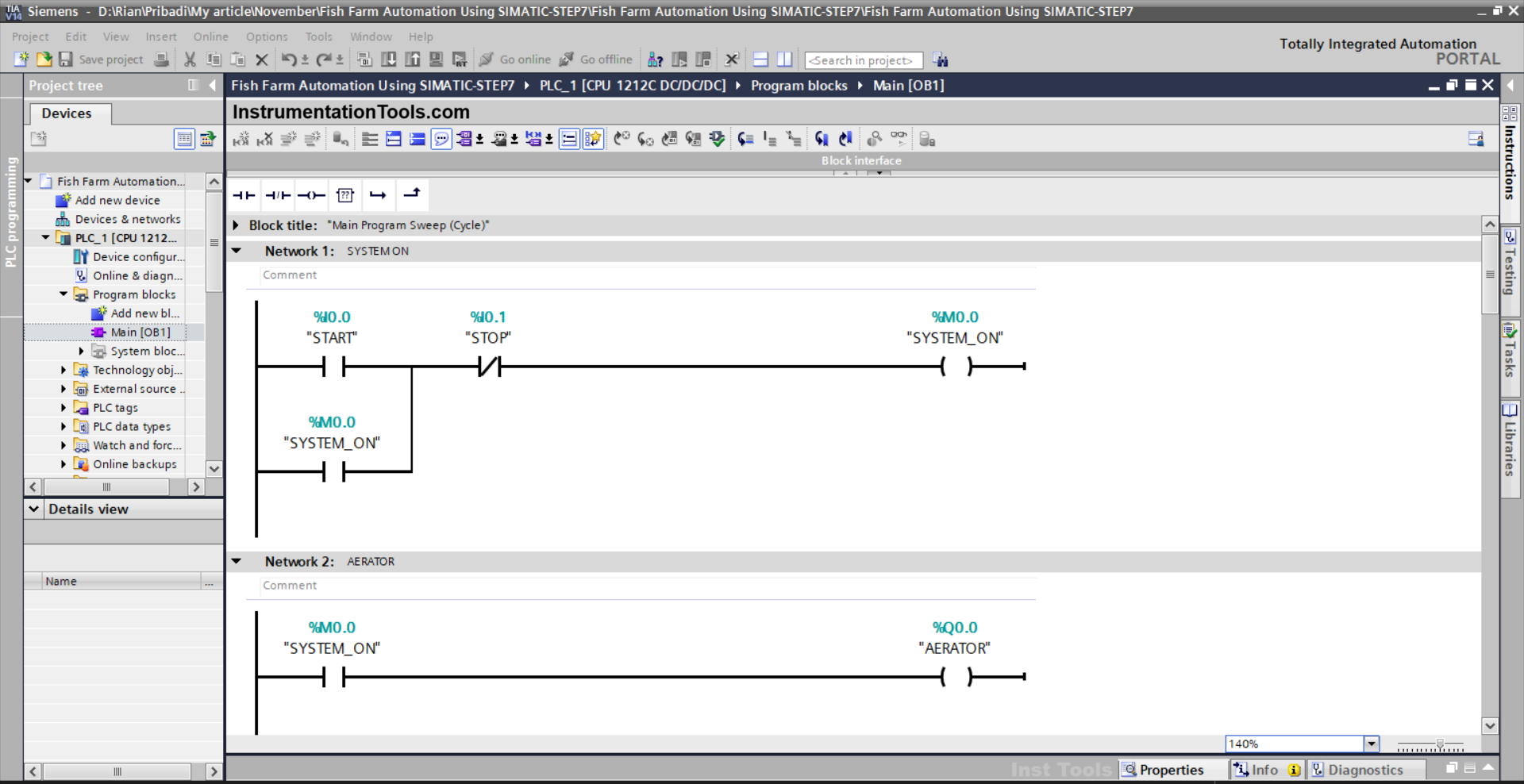

NETWORK 1 (SYSTEM ON)
In this Network, the memory bit SYSTEM_ON (M0.0) will be in a HIGH state when the PB_START (I0.0) button is pressed. Due to latching, the memory bit SYSTEM_ON (M0.0) will remain in a HIGH state even though the PB_START (I0.0) button is released.
When the PB_STOP (I0.1) button is pressed, the memory bit SYSTEM_ON (M0.0) will be in a LOW state.
NETWORK 2 (AERATOR)
In this Network, the output AERATOR (Q0.0) will be ON if the NO contact of the memory bit SYSTEM_ON (M0.0) is in a HIGH state.

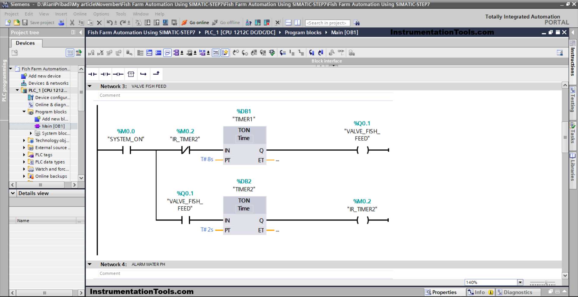

NETWORK 3 (VALVE FISH FEED)
In this Network, Timer TIMER1 (DB1) will start counting up to 8 seconds when the NO contact of the memory bit SYSTEM_ON (M0.0) is in the HIGH state, and when Timer TIMER1 (DB1) has finished counting, the output VALVE_FISH_FEED (Q0.1) will become OPEN.
Next, Timer TIMER2 (DB2) will start counting up to 2 seconds, and after it has finished counting, the memory bit IR_TIMER2 (M0.2) will be in a HIGH state.
Timer TIMER1 (DB1) will be reset, and the output VALVE_FISH_FEED (Q0.1) will return to CLOSED when the NC contact of the memory bit IR_TIMER2 (M0.2) is in a HIGH state.

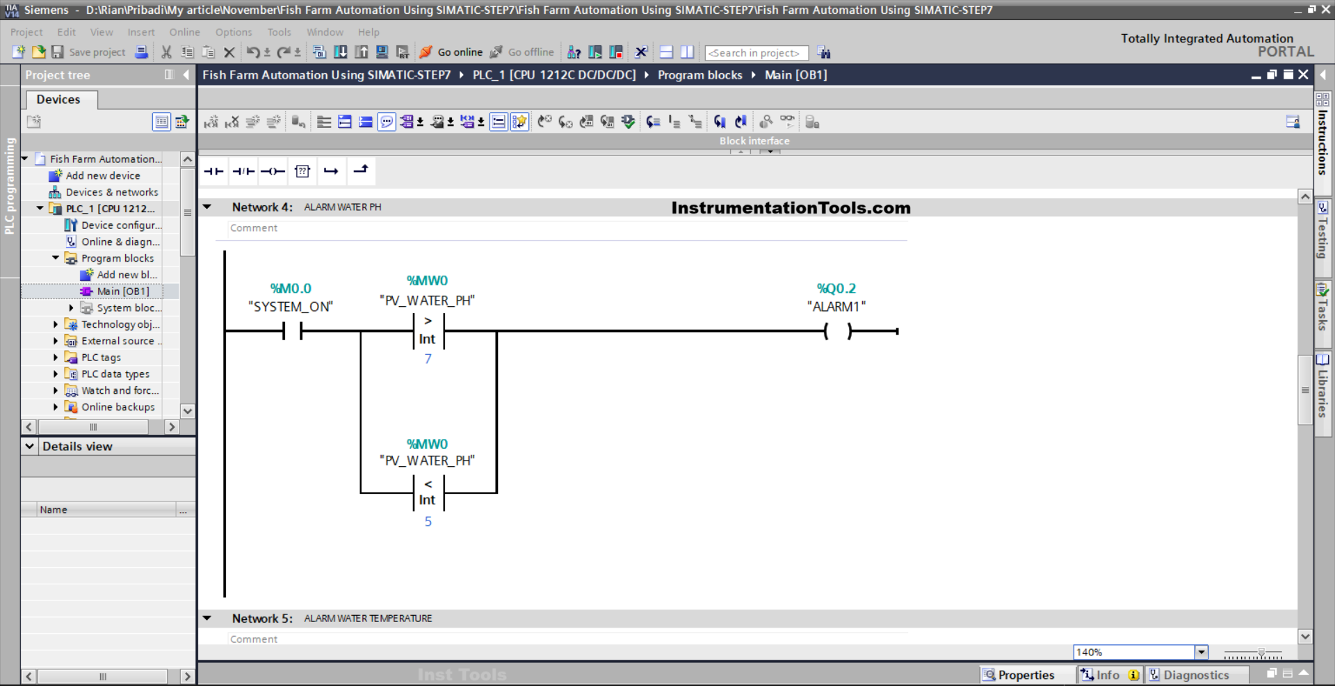

NETWORK 4 (WATER PH ALARM)
In this Network, Output ALARM1 (Q0.2) will be ON when the NO contact of the memory bit SYSTEM_ON (M0.0) in the HIGH state and the value in the memory word PV_WATER_PH (MW0) is Greater Than “7” or Less Than “5 ”.

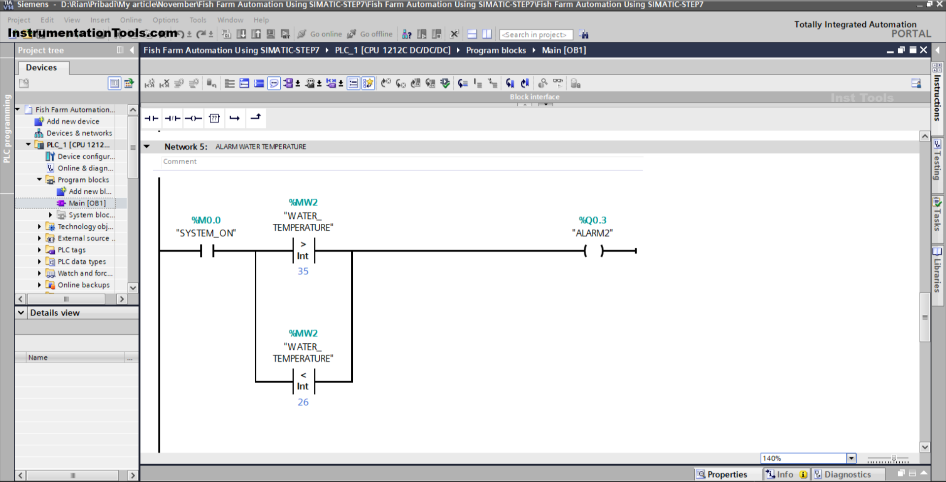

NETWORK 5 (WATER TEMPERATURE ALARM)
In this Network, Output ALARM2 (Q0.3) will be ON when the NO contact of the memory bit SYSTEM_ON (M0.0) in the HIGH state and the value of the memory word WATER_TEMPERATURE (MW2) is Greater Than “35” or Less Than “26 ”.

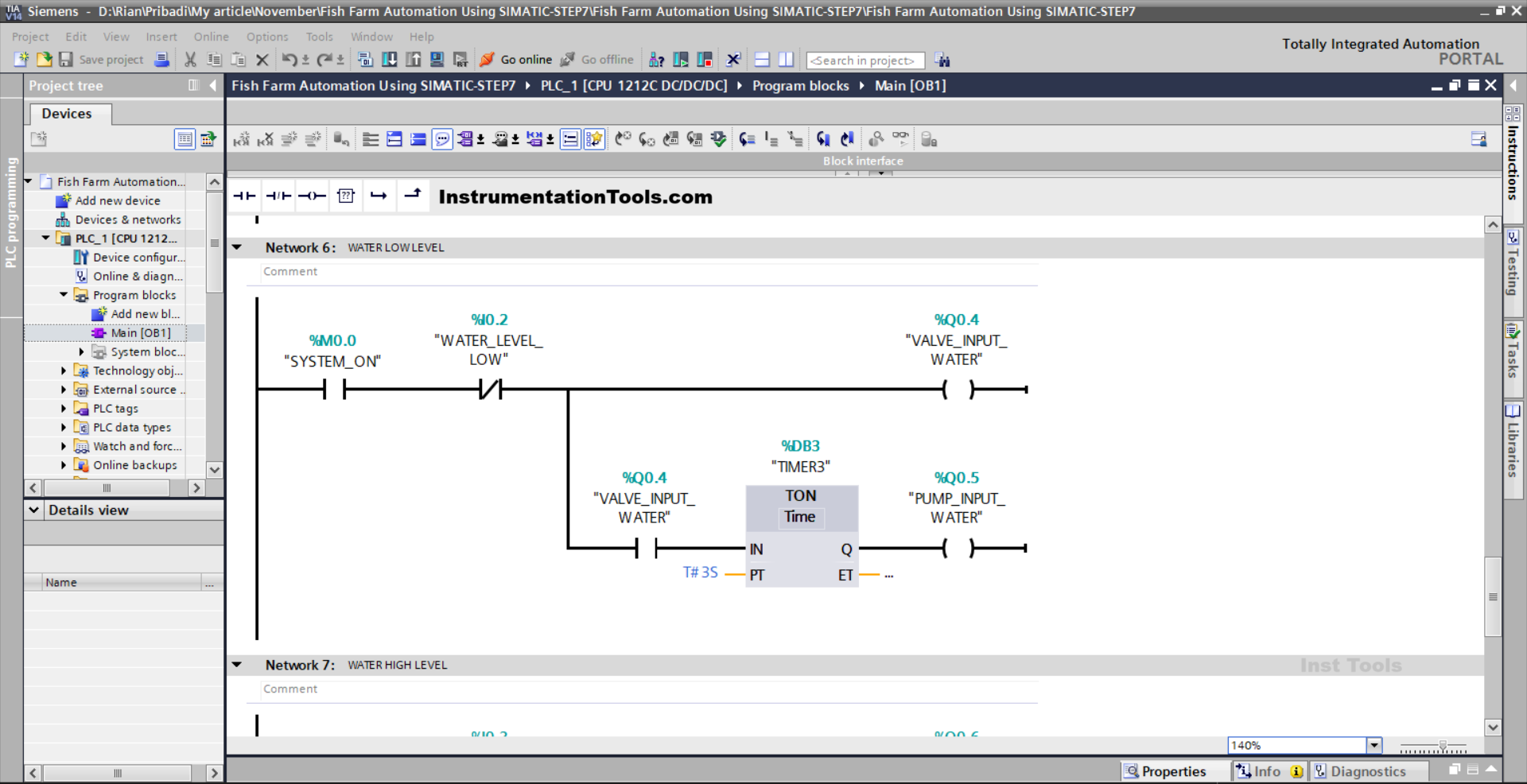

NETWORK 6 (WATER LOW LEVEL)
In this Network, the output VALVE_INPUT_WATER (Q0.4) will be OPEN when the NO contact of the memory bit SYSTEM_ON (M0.0) is in the HIGH state.
The timer TIMER3 (DB3) will start counting up to 3 seconds when the NO contact of the output VALVE_INPUT_WATER (Q0.4) is in the HIGH state.
When Timer TIMER3 (DB3) has finished counting, the output PUMP_INPUT_WATER (Q0.5) will become ON.

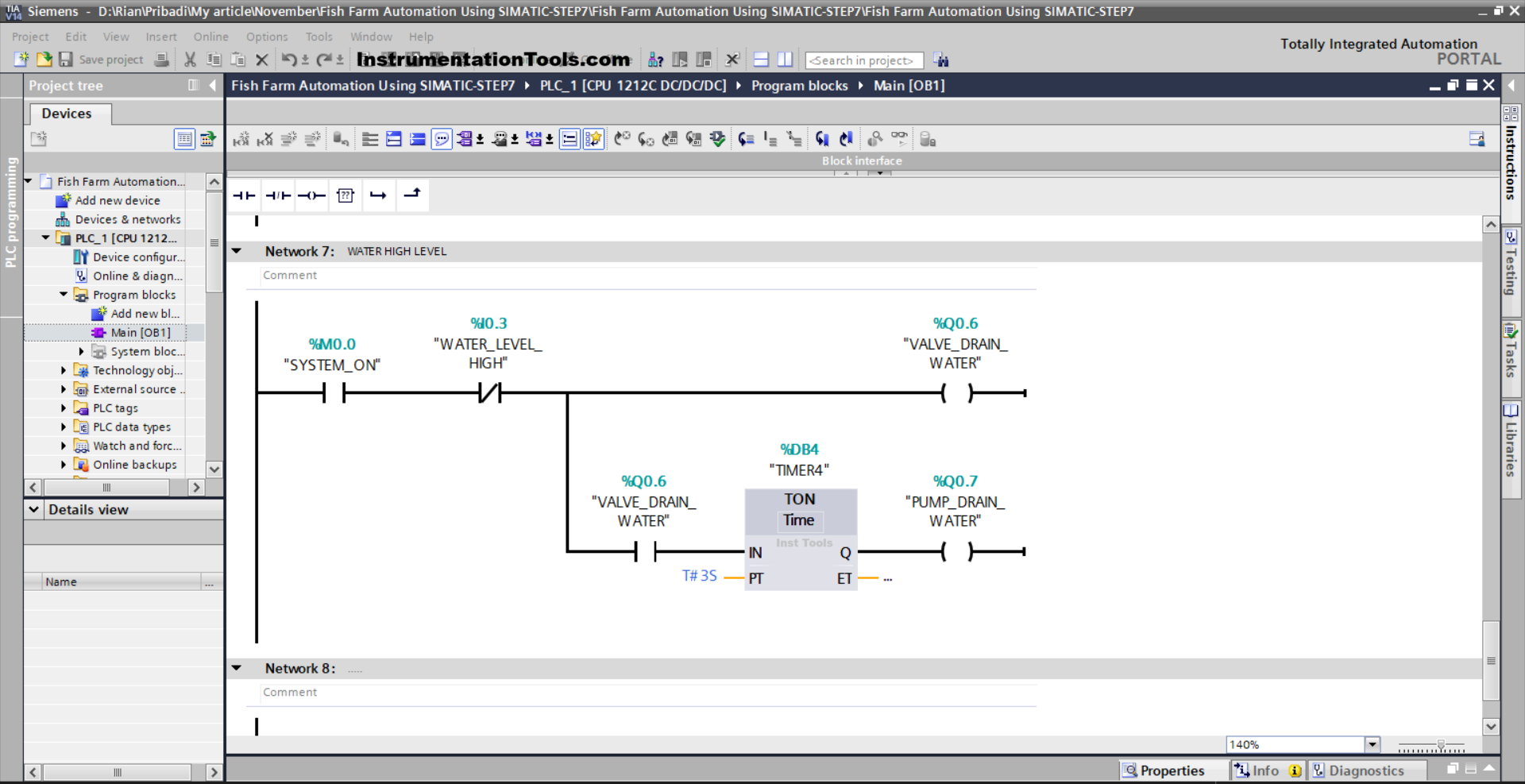

NETWORK 7 (WATER HIGH LEVEL)
In this Network, the output VALVE_DRAIN_WATER (Q0.6) will be OPEN when the NO contact of the memory bit SYSTEM_ON(M0.0) is in the HIGH state.
The timer TIMER4 (DB4) will start counting up to 3 seconds when the NO contact of the output VALVE_DRAIN_WATER (Q0.6) is in the HIGH state.
When the timer TIMER4 (DB4) has finished counting, the output PUMP_DRAIN_WATER (Q0.7) will become ON.
