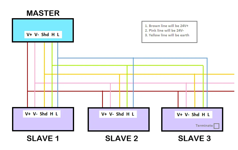

2. What is the physical connection method used in DeviceNet?
DeviceNet typically operates using a scanner-slave architecture. A DeviceNet scanner module communicates with multiple slave devices (like sensors or I/O modules). The physical topology is usually trunk-line/drop-line, where 5 wires are used:
  • V+
  • V-
  • CAN-H
  • CAN-L
  • Shield (Drain)
Power and data share the same cable, simplifying the wiring. The trunk line supplies power, and drop lines connect to devices. The network requires terminating resistors (121 Ω) at both ends of the trunk line to prevent signal reflections.
