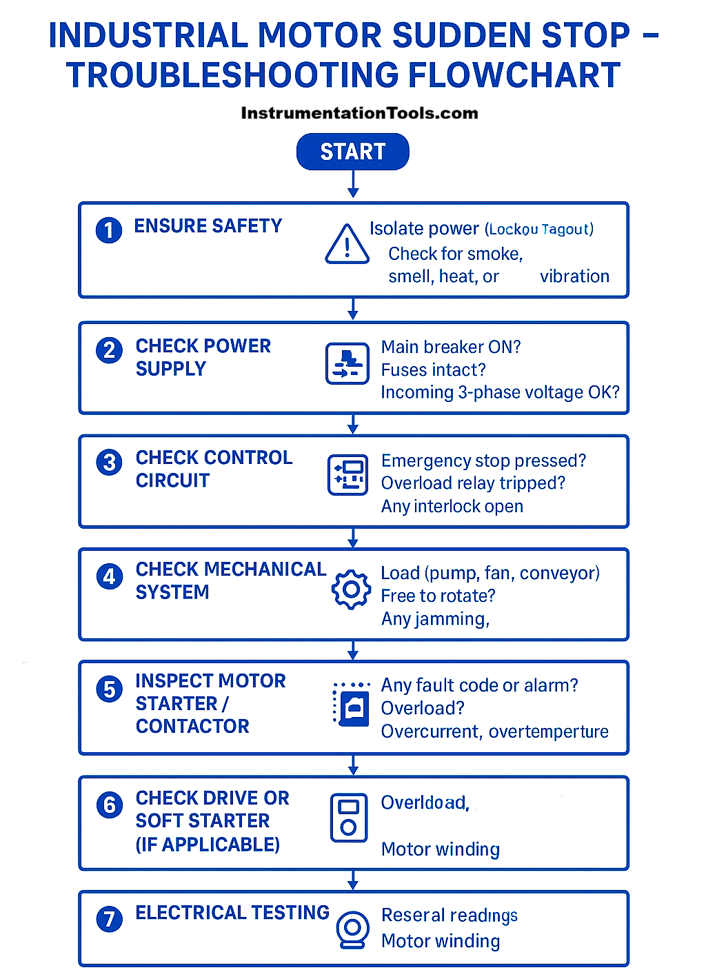

What are the steps to undertake when a motor stops?
- The very first step is to check the power supply. If the power supply is fine, turn it off first of all to ensure the safety of the personnel. Check for any burning smell or visual fire, and if any such thing is found, then immediately inform the nearby personnel. Then, check whether any breaker or fuse has tripped, or any interlock is active, or any loose connection. If you find none of these active and all are fine, then you can power on the supply to check the electrical parameters of voltage and all. Use a multimeter and Megger tester and check the required points for any short circuit, insulation resistance or phase loss.
- In power off condition earlier, if overheating is found, then check motor windings, bearings, insulation, motor housing, and rotor shaft. Also, check for motor load specifications, whether matching with motor specifications, ventilation around the motor, and the motor capacitor (especially in single-phase ones).
- If the motor is controlled by a VFD, then expect the VFD to report any fault. VFD is easy to troubleshoot because it has fault codes shown on its display. From that fault, you can try to check exactly when the fault occurred and how to solve it. You can then check the VFD IOs, communication protocol links, motor terminals, and visually inspect for any semiconductor damage from outside.
- Even if that is healthy, you can verify the methods by which the motor is controlled. This means, either by a PLC or some other controller or even an electrical control circuit. With this, you can verify the interlocks and see if any false data was triggered to stop the motor. PLC code can be checked to find out any bugs.
