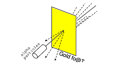

Rutherford’s Scattering
Rutherford’s scattering experiment involved bombarding a thin gold foil with positively charged alpha particles as in Figure 2.2. Young graduate students H. Geiger and E. Marsden experienced unexpected results. A few Alpha particles were deflected at large angles.
A few Alpha particles were back-scattering, recoiling at nearly 180o . Most of the particles passed through the gold foil undeflected, indicating that the foil was mostly empty space.
The fact that a few alpha particles experienced large deflections indicated the presence of a minuscule positively charged nucleus.
Figure 2.2: Rutherford scattering: a beam of alpha particles is scattered by a thin gold foil.
Although Rutherford’s atomic model accounted for experimental data better than Thompson’s, it still wasn’t perfect. Further attempts at defining atomic structure were undertaken, and these efforts helped pave the way for the bizarre discoveries of quantum physics.
