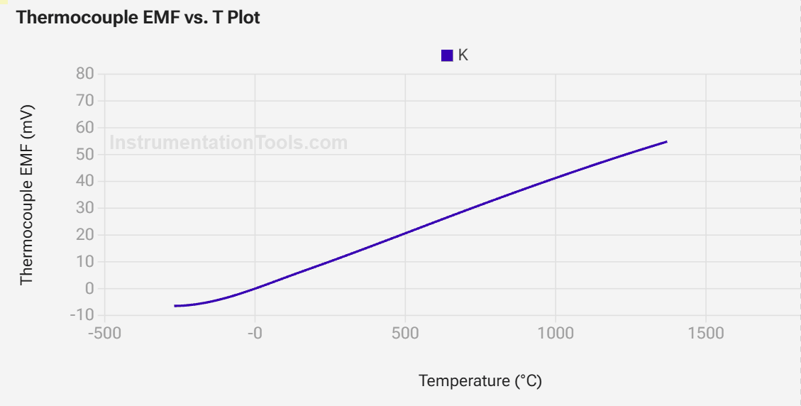

A thermocouple is formed by joining two different metal wires, creating a junction. When the junction experiences temperature differences, it generates a voltage, this phenomenon is called the Seebeck Effect. The voltage produced is usually very small (in millivolts) and varies according to the type of metals used and the temperature.
For example:
- A Type-K thermocouple at 0°C generates approximately 0 mV.
- At 100°C, it produces roughly 4.096 mV.
- At 500°C, it outputs around 20.644 mV.
Since these voltages are minute and non-linear, a reliable converter is necessary for accurate temperature interpretation.

Importance of the ITS-90 Standard in Conversion
The International Temperature Scale of 1990 (ITS-90) provides universally accepted polynomial equations and coefficients for precise conversions between millivolts and Celsius.
A typical polynomial equation from ITS-90 is:
E(T) = a0 + a1T + a2T2 + a3T3 + a4T4 + ... + anTn
Here,
- E(T) is voltage in millivolts,
- T is temperature in degrees Celsius,
- a₀, a₁, a₂…aₙ are thermocouple-specific coefficients.
Accurate conversions rely strictly on these standardized coefficients provided by organizations like NIST.
