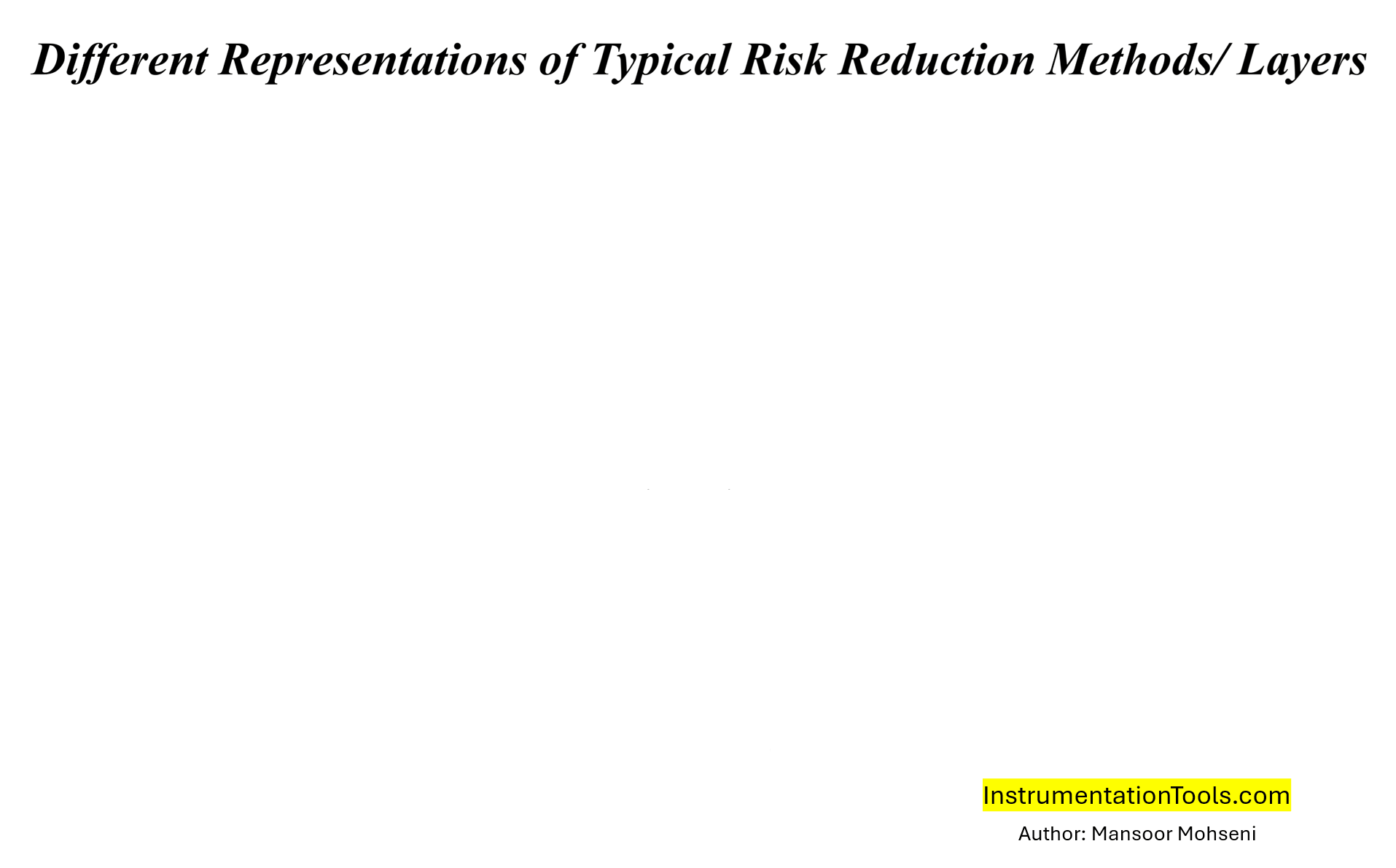

Figure-1: Different Representations of Typical Risk Reduction Methods/ Layers.

Referring to Figures 1 and 2, we can see that the Safety Instrumented System (SIS) is just one of the considered protection layers for the process plant, and to reach the desired risk reduction, we need to consider the roles of other protection layers too.
On the other hand, SIL is the characteristics (performance level) of just one of the multiple protection layers, and focusing on SIL’s best performance cannot guarantee the good performance of other protection layers. Again, repeated that for reaching the good risk reduction, other protection layers shall work properly and completely play their roles too. Therefore, we shall not expect all plant risk reduction to be related to SIL level (as the performance characteristics of SIS), and always other protection layers shall be in our concern view in parallel to SIL Level too!

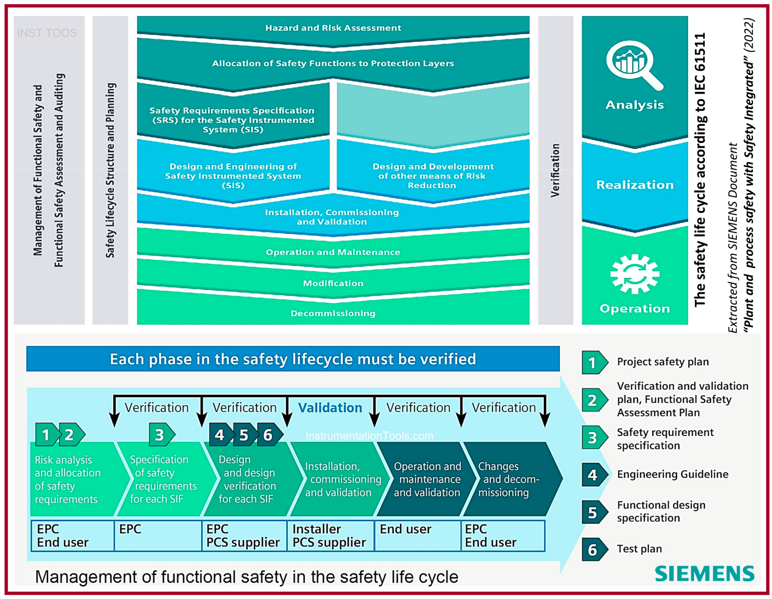

IEC-61511 (“Functional Safety – Safety instrumented systems for the process industry sector”) is the global standard for implementing SIS in the Process Plants. This standard defines, describes, and clarifies all the requirements/ specifications for establishing SIS in the Process Plants. On the other hand, proposed SIL levels of different Safety Instrumented Functions (SIF) will be valid just by following the IEC 61511 standard for complete Safety Lifecycle conditions and requirements, and focusing just on the proposed SIL Level at the design stage of an Industrial Process Plant Project may not guarantee reaching the expectations for the presuppositions.
Figure-4: Management of Functional Safety in the Safety Life Cycle. (By System Vendor’s view – SIEMENS)
Figure-4 shows a good representation of applying verification and validations during different stages of management of functional safety (SIS) in the safety lifecycle (provided by SIEMENS). From Figure-4, it is clear that SIS shall be verified and validated during the safety lifecycle by different teams and responsible positions, and guaranteeing complete satisfaction of such requirements may not be so easy.
So, simply we can say that more focus on formally proposed SIL Levels at the design Stage of an Industrial Process Plant Project will not guarantee the completeness of process plant safety. A good Process Safety Management shall have enough focus on all requirements of SIL during the whole Safety Lifecycle. Furthermore stablishing right SIS for a Process Plant needs several hidden conditions and requirements, some of which are described in followings.

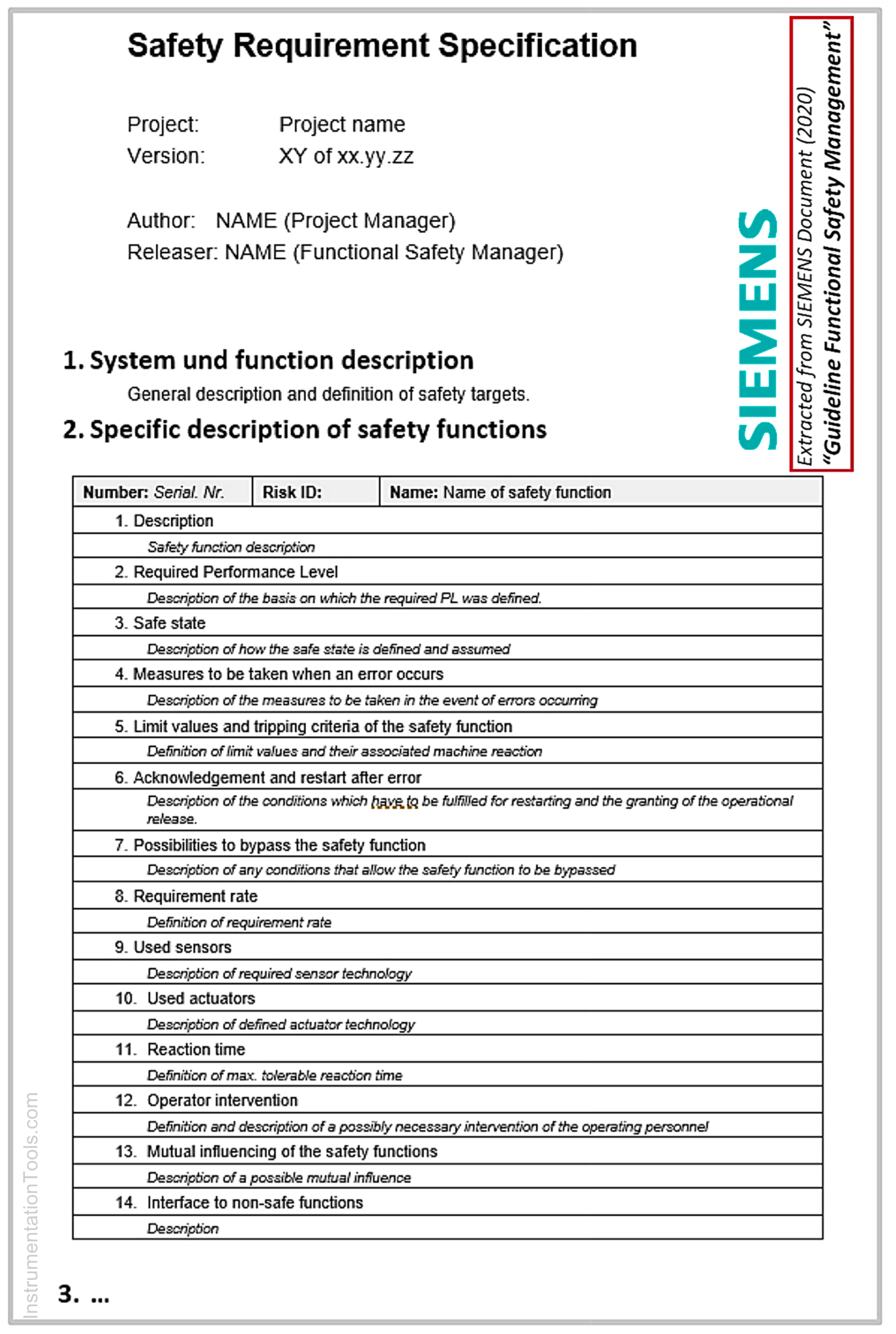

Providing the right project SRS for Process Plant SIS
Providing the right and complete data, information, documents, and procedures as the Project SRS (Safety Requirements Specifications) has the vital role for stablishing valid and effective Process Plant SIS. Figure-5 shows a sample list of SRS contents provided by the Safety System vendor (SIEMENS).
The validity and completeness of all contents of SRS shall be monitored and audited by expert Functional Safety Specialists, since they are the basis of the following site activities related to Process Safety Management.
All safety datasheets shall be provided as certified documents, and all Safety Following Activities shall have suitable procedures or guidelines. As an example, all Proof Testing activities or overriding safety functions shall have a suitable procedure or guideline.

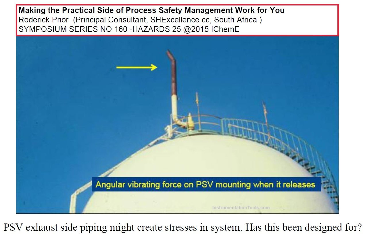

Exact Supervisions for Right Installation and Operation Check during Construction and Commissioning Phases of Safety Lifecycle
All Safety Function Loops of SIS shall have proper response in actual and realistic site conditions, and hence, following the right requirements for installation and operation check during construction and commissioning phases of the safety lifecycle is very important. Figure-6 shows a sample of tracing the safety function during the installation and commissioning phases.
Figure-5: Sample of Safety Requirements Specifications (SRS) Contents List. (By System Vendor’s view – SIEMENS)
Checking for consideration of all required installation conditions of safety function loops during the Design Stage and providing complete installation procedures and supporting items is very important for the final validity of Safety Function Loops.
However, sometimes due to site feedback or technical queries, the considered design for safety function loops may be changed or modified, too.
Figure-6: Sample of tracing the practical issues of the installation of safety function loops.

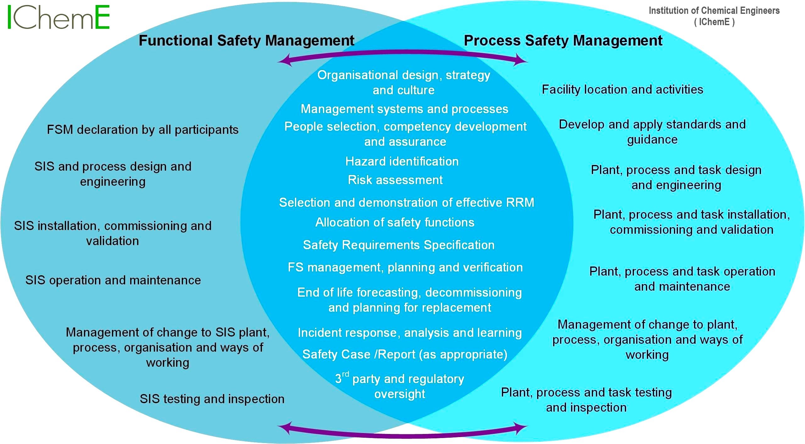

Functional Safety and Process Safety Management (FSM and PSM) Overlaps
Functional Safety Management (FSM) is a part of Process Hazard Analysis (PHA) element of Process Safety Management (PSM). It is very important to notice that to guarantee the safety and performance operations of Process Plant, the Project Management shall follow the right, and complete Process Safety Management, and focusing on just one part of one element of such requirements (SIS or accordingly SIL Level), shall not make carelessness on other important elements of safety pillars. However, Functional Safety Management and Process Safety Management generally have some main overlap concerns and relations, as shown in Figure 7, which is provided by the Institution of Chemical Engineers.
Figure-7: Concern Relations between Functional Safety Management (FSM) and Process Safety Management (PSM), provided by IChemE.

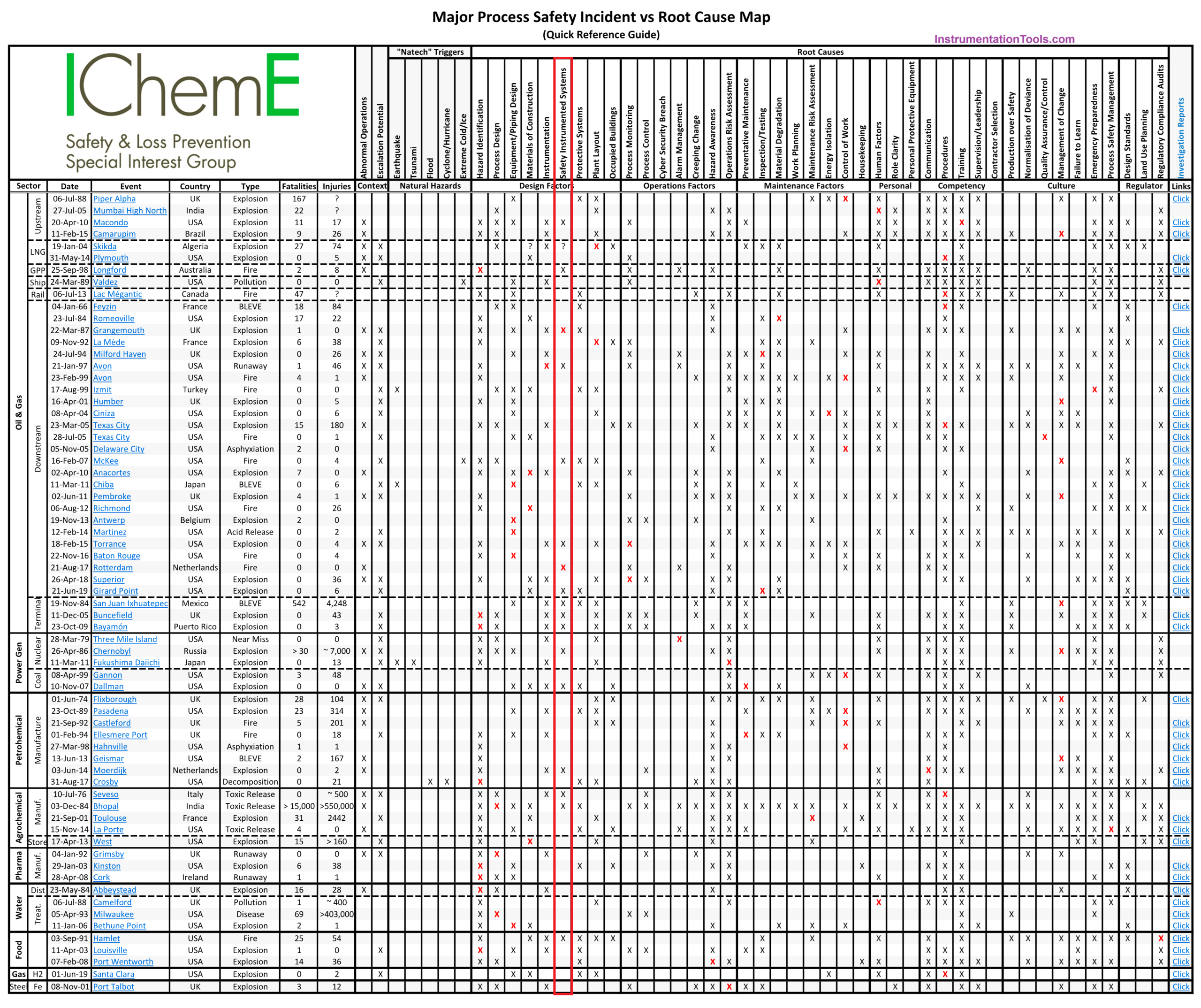

Obtained Precision Feedback from Accident Investigations
A complete and exact study feedback on the Process Plant Accidents (made by IChemE) concludes that several main factors have the effects on the accidents. As Figure-8 shows, these main factors can be listed as:
- Context (Abnormal operation, Escalation Potential).
- Natural Hazards (Earthquake, Tsunami, Flood, Cyclone/ Hurricane, Extreme Cold/ Ice).
- Design Factors (Hazard Identification, Process design, Equipment/ Piping Design, Materials of Construction, Instrumentation, Safety Instrumented Systems, Protective Systems, Plant Layout, Occupied Buildings).
- Operation Factors (Process Monitoring, Process Control, Cyber Security Breach, Alarm Management, Creeping Change, Hazard Awareness, operation Risk assessment).
- Maintenance Factors (Preventive Maintenance, Inspection/ Testing, Material Degradation, Work Planning, Maintenance Risk Assessment, Energy Isolation, Control of Work, Housekeeping).
- Personal (Human Factors, Role Clarity, Personal Protective Equipment).
- Competency (Communication, Procedures, Training, supervision/ Leadership, Contractor Selection).
- Culture (Production over Safety, Normalization of Deviance, Quality Assurance/ Control, Management of Change, Failure to Lean, Emergency Preparedness, Process Safety Management).
- Regulator (Design Standards, Land Use planning, Regulatory Compliance Audits).
Figure 8: Major Process Safety Incident vs Root Cause Map (Quick Reference Guide) provided by IChemE.
Figure-8 shows that Design Factors have a great weight effect on the occurrence of accidents inside Process Plants, and among them, Safety Instrumented System (SIS) also has an appreciable role, hence considering exact focuses on SIS during the Design Phase will have sensible reasons.
However, it shall be noticed that SIS is just one of several root causes of Process Plant accidents, and further to this root, some other roots may have greater or comparable weight to SIS’s role, and so they should be considered in any study that focuses on this.
From Figure-8, we can see that different causes or roots of accidents may exist or be initiated in different phases of a project lifecycle. However, via a more detailed view, we can see many of them can be studied during the Detail Design Phase of a project for removing or preventing such probable root causes in the future, or at least reduce the risk weight of such roots. Furthermore, by some more detailed studies, we may find that for an exact SIS design, we shall review the relation with our SIS effects on other accident roots too.
