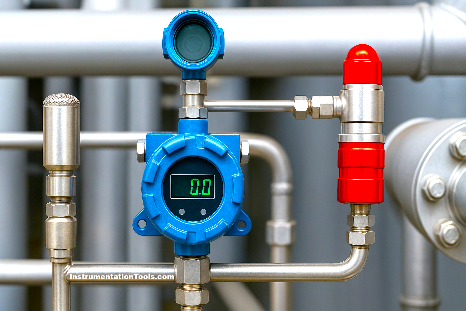

When you are using a gas detector in an industrial or domestic environment, it is necessary to know the technology used inside it for sensing them.
Sensor TechnologiesCatalytic bead gas detectorInfrared gas detectorPhoto ionization detectorElectrochemical gas detectorSemiconductor detectorUltrasonic gas detector
Sensor Technologies
Sensor Technologies in Gas Detectors
Gas detection is a complex process working inside the instrument, with a vast variety of features used in sensing the gas. Due to this, when you are choosing a detector, it is very important to know which type of technology supports which type of gas for your use. Otherwise, there is no use in buying a detector-A for gas-B. In this post, we will see the sensor technologies used in gas detectors.
