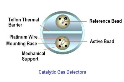

Catalytic-type gas sensor consist of two elements: a detector element (D) which contains catalytic material and is sensitive to combustible gases, and a compensator element (C) which is inert.
Combustible gases will burn only on the detector element, causing a rise in its temperature and, as a consequence, a rise in its resistance.
Combustible gases will not burn on the compensator—its temperature and resistance remain unchanged in the presence of combustible gases. ( below Figure)
