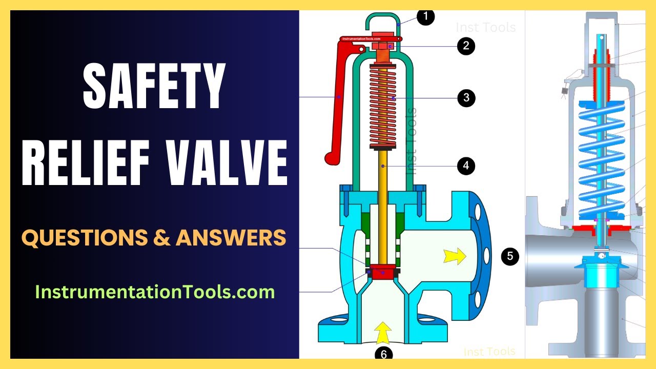

Safety Relief Valve QuizWhat is the primary function of the cap in a safety relief valve?The adjusting screw in a safety relief valve is used for what purpose?What is the function of the lock nut in a safety relief valve?What is the purpose of the upper spring plate in a safety relief valve?What role does the bonnet play in a safety relief valve?What is the spindle’s role in the safety relief valve mechanism?How does the spring contribute to the safety relief valve’s function?What is the purpose of the lower spring plate in a safety relief valve?In a safety relief valve, what is the function of the stud?What is the role of the nut in relation to the stud in a safety relief valve?How does the split ring contribute to the safety relief valve?What is the function of the gasket in a safety relief valve?How does the guide with bushing help in the operation of a safety relief valve?What is the primary function of the pin in a safety relief valve?What is the role of the ball in a safety relief valve?How does the disc function in a safety relief valve?What is the seat’s purpose in a safety relief valve?What is the primary function of the body in a safety relief valve?
Watch the safety valve video to learn more.
You can start the interactive safety valves quiz by clicking on the below blue color button.
Test your valve skills now.
Safety Valve Quiz
Question 1
A. It seals the valve body
B. It covers the valve’s internal components
C. It holds the spring in place
D. It prevents pressure buildup in the valve
Show the Answer
Question 2
A. To set the blowdown
B. To lock the valve body
C. To seal the spring chamber
D. To adjust the set pressure
Show the Answer
Question 3
A. Holds the spring plate
B. Secures the adjusting screw in position
C. Locks the valve disc
D. Prevents overpressure release
Show the Answer
Question 4
A. It adjusts the spindle position
B. It distributes spring force
C. It controls blowdown
D. It seals the valve body
Show the Answer
Question 5
A. It provides a locking mechanism for the spindle
B. It encloses the valve’s upper components
C. It directs flow through the valve
D. It seals the seat and body
Show the Answer
Question 6
A. Transfers force from the spring to the disc
B. Locks the valve in a closed position
C. Adjusts set pressure
D. Guides the fluid flow through the valve
Show the Answer
Question 7
A. It locks the valve in place
B. It provides resistance to system pressure
C. It seals the valve tightly
D. It directs fluid flow
Show the Answer
Question 8
A. Supports the disc for sealing
B. Provides a seat for the spring
C. Locks the valve in place
D. Distributes force to the valve body
Show the Answer
Question 9
A. Connects the disc to the seat
B. Holds the valve body together
C. Locks the spindle in place
D. Secures the bonnet to the body
Show the Answer
Question 10
A. Secures the stud in place
B. Locks the disc in place
C. Tightens the spring tension
D. Seals the bonnet to the body
Show the Answer
Question 11
A. Provides a flexible seal
B. Holds the valve in a closed position
C. Prevents spring displacement
D. Ensures spindle alignment
Show the Answer
Question 12
A. To support the spring
B. To seal between the valve body and bonnet
C. To prevent spindle movement
D. To regulate flow rate
Show the Answer
Question 13
A. Seals the valve tightly
B. Controls fluid flow
C. Locks the bonnet
D. Guides the spindle movement
Show the Answer
Question 14
A. Secures moving parts
B. Aligns the valve body
C. Locks the adjusting screw
D. Holds the spindle
Show the Answer
Question 15
A. Acts as a pivot point for movement
B. Controls flow rate
C. Secures the spring
D. Seals the valve seat
Show the Answer
Question 16
A. Adjusts flow rate
B. Regulates system pressure
C. Locks the valve shut
D. Opens to release excess pressure
Show the Answer
Question 17
A. Supports the spindle
B. Provides a sealing surface for the disc
C. Adjusts spring tension
D. Controls fluid flow
Show the Answer
Question 18
A. Houses and supports all internal components
B. Controls system pressure
C. Seals the valve
D. Directs flow through the valve
Show the Answer
