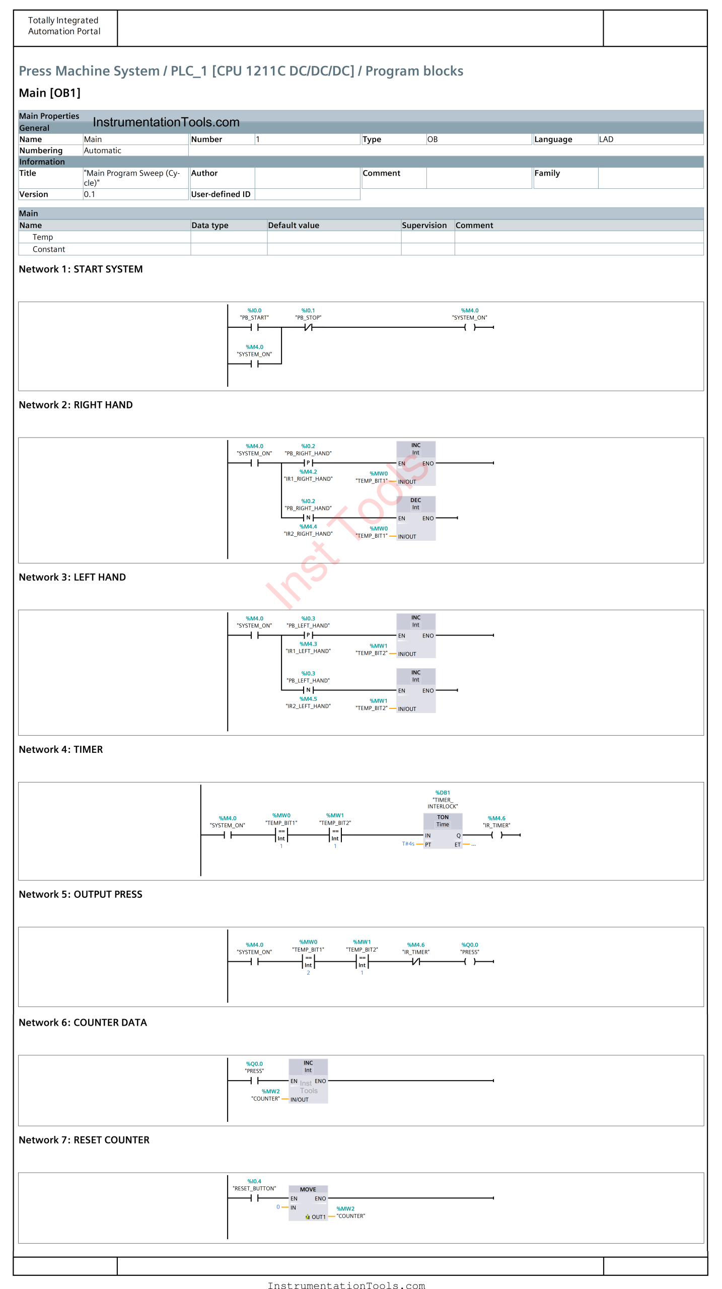

Press Machine Safety Control
NETWORK 1 (SYSTEM ON)
In this network, if the PB_START (I0.0) button is pressed, the memory bit SYSTEM_ON (M4.0) will be in the HIGH state. The memory bit SYSTEM_ON (M4.0) will remain in the HIGH state even though the PB_START (I0.0) button has been released. Because it uses Latching.
If the PB_STOP (I0.1) button is pressed, the memory bit SYSTEM_ON (M4.0) will be in the LOW state.

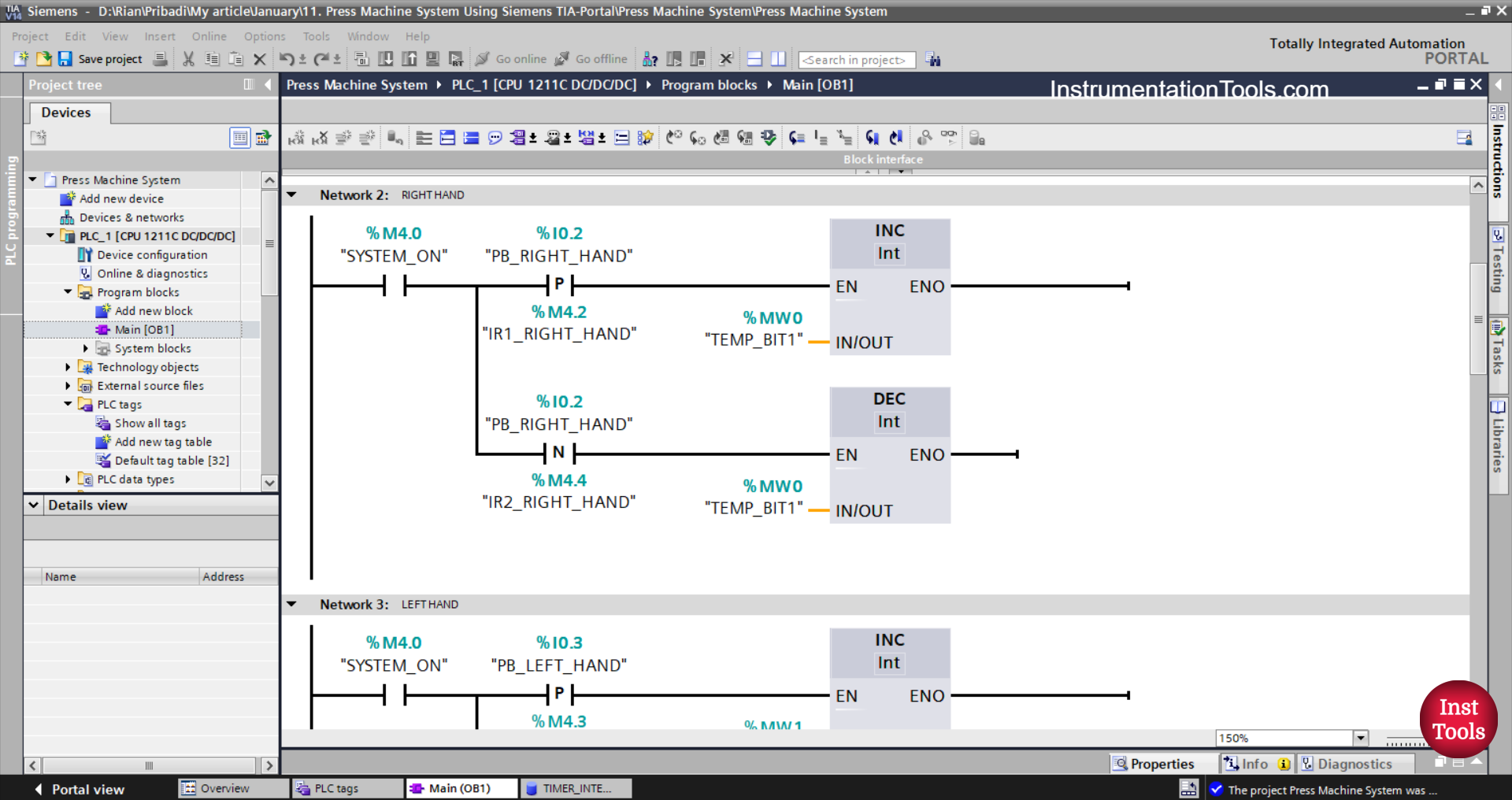

NETWORK 2 (RIGHT HAND)
In this Network, the value in the memory word TEMP_BIT1 (MW0) will increase by (+1) if the NO contact of the memory bit SYSTEM_ON (M4.0) is in the HIGH state and the PB_RIGHT_HAND (I0.2) button is pressed.
The value in memory word TEMP_BIT1 (MW0) will decrease by (-1) when the PB_RIGHT_HAND (I0.2) button is released.

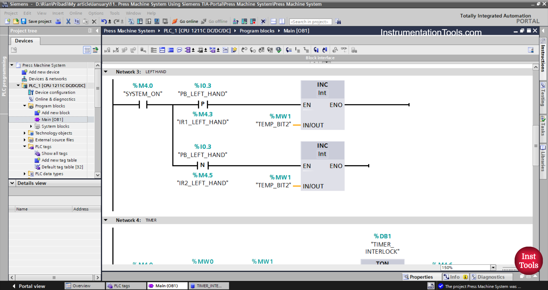

NETWORK 3 (LEFT HAND)
In this network, the value in the memory word TEMP_BIT2 (MW1) will increase by (+1) when the NO contact of the memory bit SYSTEM_ON (M4.0) becomes HIGH state and the PB_LEFT_HAND (I0.3) button is pressed.
The value in memory word TEMP_BIT2 (MW1) will decrease by (-1) when the PB_LEFT_HAND (I0.3) button is released.

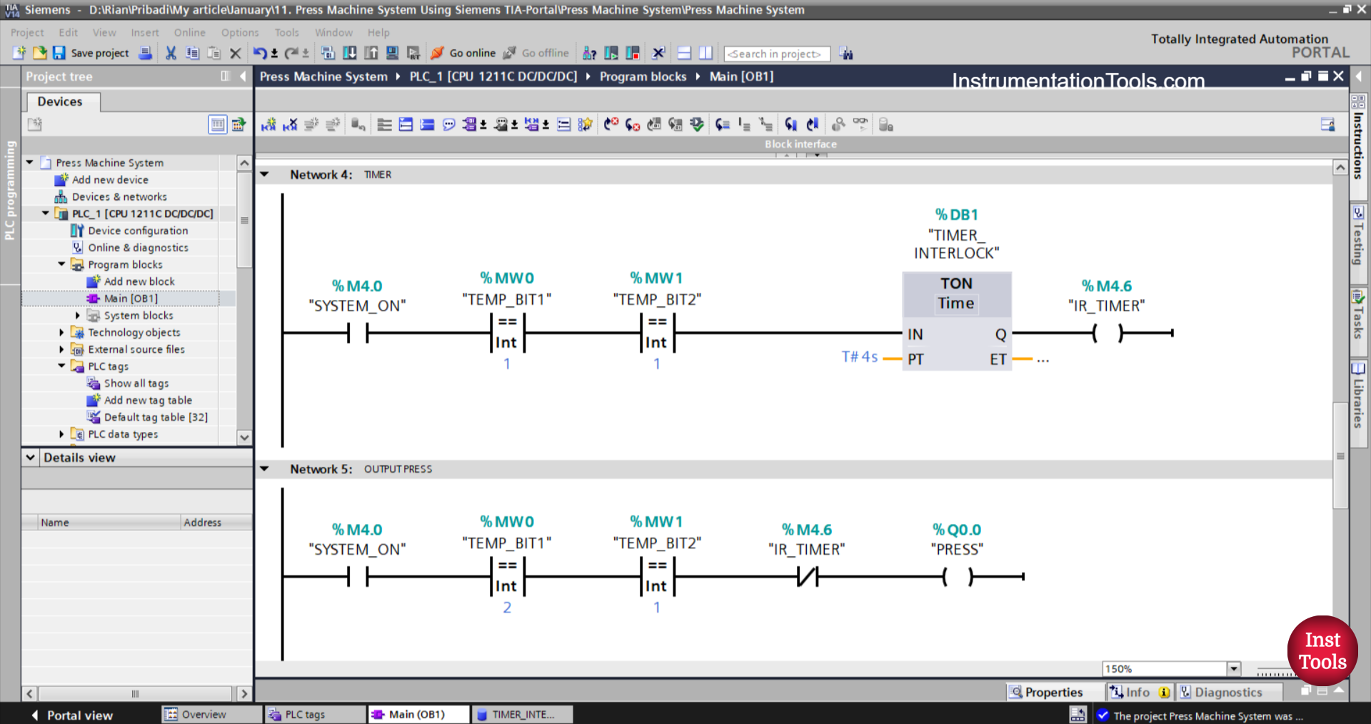

NETWORK 4 (TIMER)
The TIMER_INTERLOCK (DB1) timer will count up to 5 seconds When the NO contact of the memory bit SYSTEM_ON (M4.0) becomes in the HIGH state and the value in the memory words TEMP_BIT1 (MW0), TEMP_BIT2 (MW1) is Equal To “1”. After the TIMER_INTERLOCK (DB1) timer has finished counting, the memory bit IR_TIMER (M4.6) will be in the HIGH state.
NETWORK 5 (PRESS OUTPUT)
When the NO contact of the memory bit SYSTEM_ON (M4.0) becomes in the HIGH state and the value in the memory word TEMP_BIT1 (MW0), TEMP_BIT2 (MW1) is Equal To “1”, then the PRESS (Q0.0) output will be ON.
If the NC contact of the TIMER_INTERLOCK (DB1) timer is in the HIGH state, then the PRESS (Q0.0) output will be OFF.

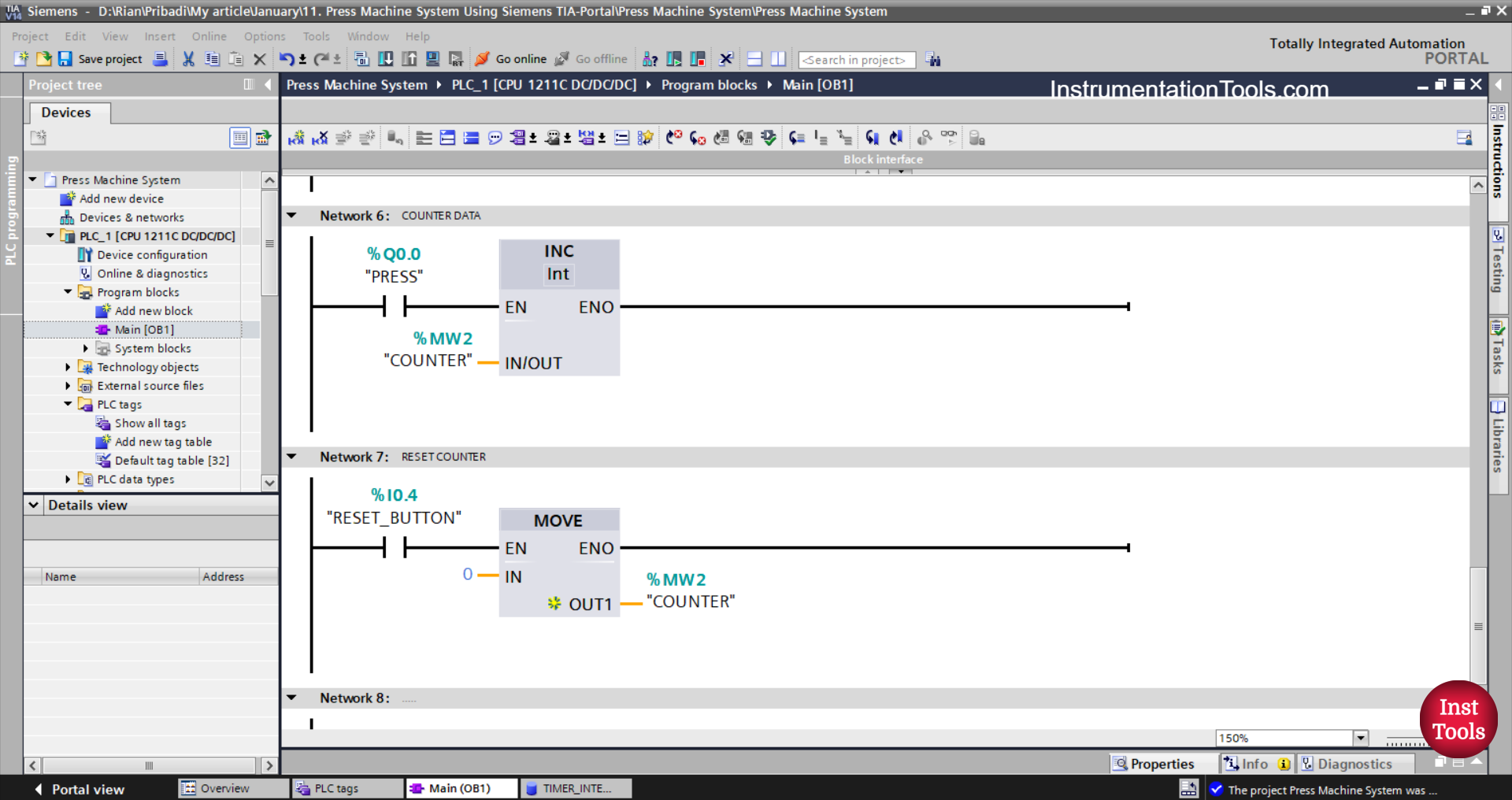

NETWORK 6 (COUNTER)
The value in the memory word COUNTER (MW2) will increase by (+1) when the NO contact of the PRESS (Q0.0) output is ON.
NETWORK 7 (RESET COUNTER)
The value in the memory word COUNTER (MW2) will be reset to zero “0” when the RESET_BUTTON (I0.4) button is pressed.
The Move instruction moves the zero value “0” to the memory word COUNTER (MW2).
