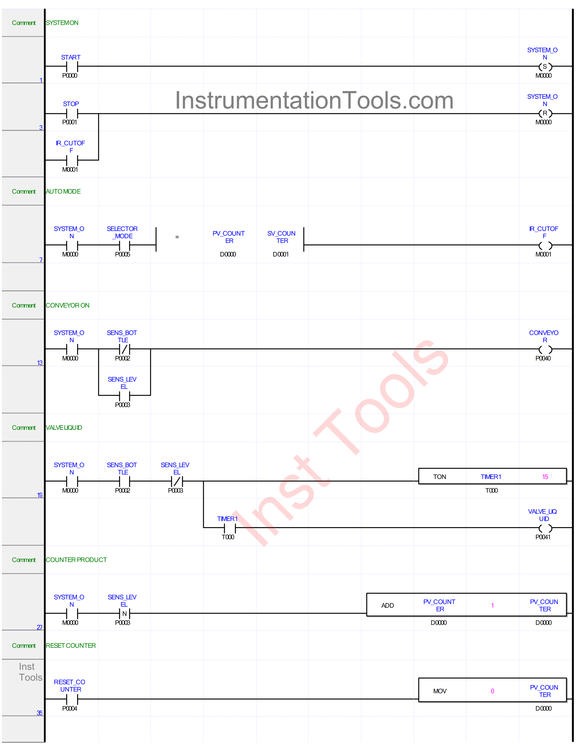

XG5000 Logic Explained
RUNG 1 (SYSTEM ON)
In this Rung, the memory bit SYSTEM_ON (M0000) will be in the HIGH state when the START (P0000) button is Pressed. Because it uses the SET Coil Instruction, the memory bit SYSTEM_ON (M0000) will remain in the HIGH state even though the START (P0000) button has been Released.
RUNG 3
In this Rung, the memory bit SYSTEM_ON (M0000) will be in the LOW state if the STOP (P0001) button is Pressed or the NO contact of the memory bit IR_CUTOFF (M0001) is in the HIGH state. Because it uses the RESET Coil Instruction.
RUNG 7 (AUTO MODE)
In this Rung, the memory bit IR_CUTOFF (M0001) will be in the HIGH state when the NO contacts of the memory bit SYSTEM_ON (M0000) and Selector Switch SELECTOR_MODE (P0005) are in the HIGH state and the value in the memory word PV_COUNTER (D0000) is Equal To SV_COUNTER (D0001).

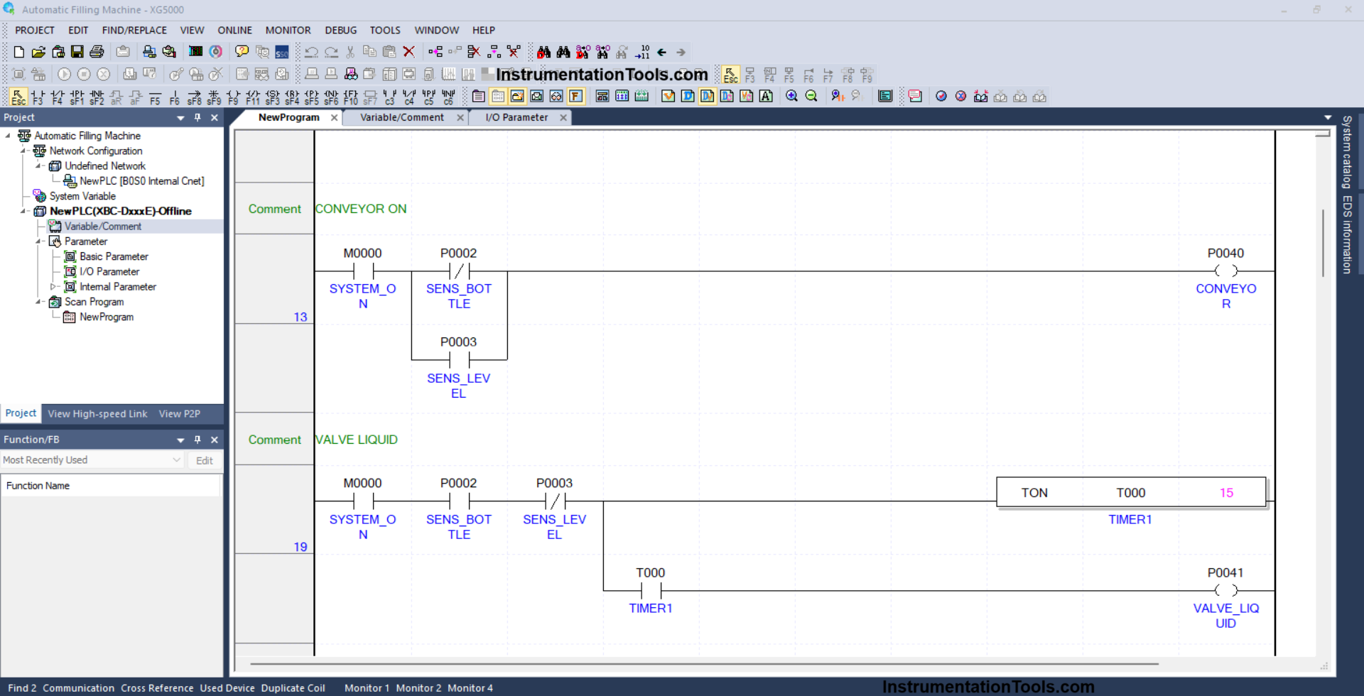

RUNG 13 (CONVEYOR)
In this Rung, the output CONVEYOR (P0040) will be ON when the NO contact of the memory bit SYSTEM_ON (M0000) is in the HIGH state and the NC contact of the sensor SENS_BOTTLE (P0002) is in the LOW state.
When the NC contact of the sensor SENS_BOTTLE (P0002) is in the HIGH state, the output CONVEYOR (P0040) will be OFF.
When the NO contact of the memory bit SYSTEM_ON (M0000) and the NO contact of the sensor SENS_LEVEL (P0003) are in the HIGH state, the output CONVEYOR (P0040) will return to ON.
RUNG 19 (VALVE LIQUID)
In this Rung, Timer TIMER1 (T000) will start counting up to “1.5” seconds when the NO contact of the memory bit SYSTEM_ON (M0000) and Sensor SENS_BOTTLE (P0002) are in the HIGH state. The output VALVE_LIQUID (P0041) will become OPEN when Timer TIMER1 (T000) has finished counting.
The output VALVE_LIQUID (P0041) will be CLOSED, and Timer TIMER1 (T000) will be OFF again when the NC contact of Sensor SENS_LEVEL (P0003) is in the HIGH state.

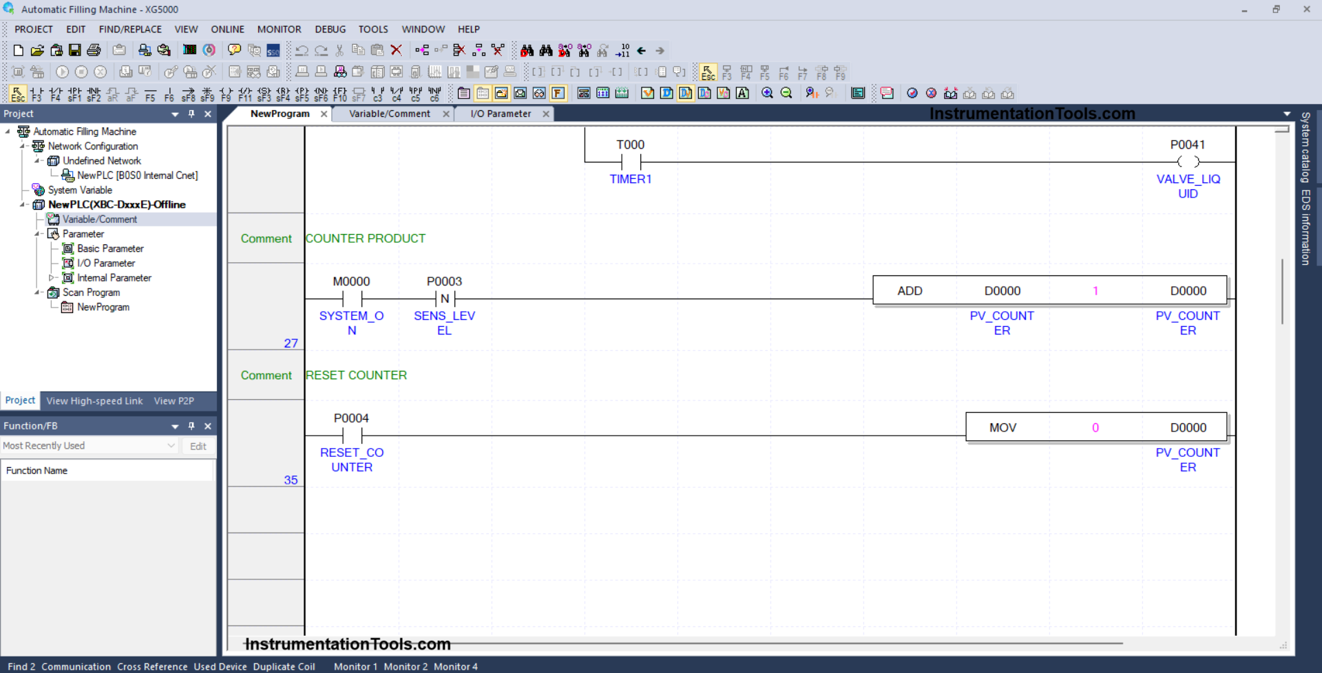

RUNG 27 (COUNTER)
In this Rung, because it uses the ADD Instruction, the value in the memory word PV_COUNTER (D0000) will increase (+1) when the NO contact of the memory bit SYSTEM_ON (M0000) and the sensor SENS_LEVEL (P0003) are in the HIGH state.
RUNG 35 (RESET COUNTER)
In this Rung, because the MOV(021) instruction is used, the value in the memory word PV_COUNTER (D0000) will be reset to zero “0” when the RESET_COUNTER (P0004) button is pressed.
