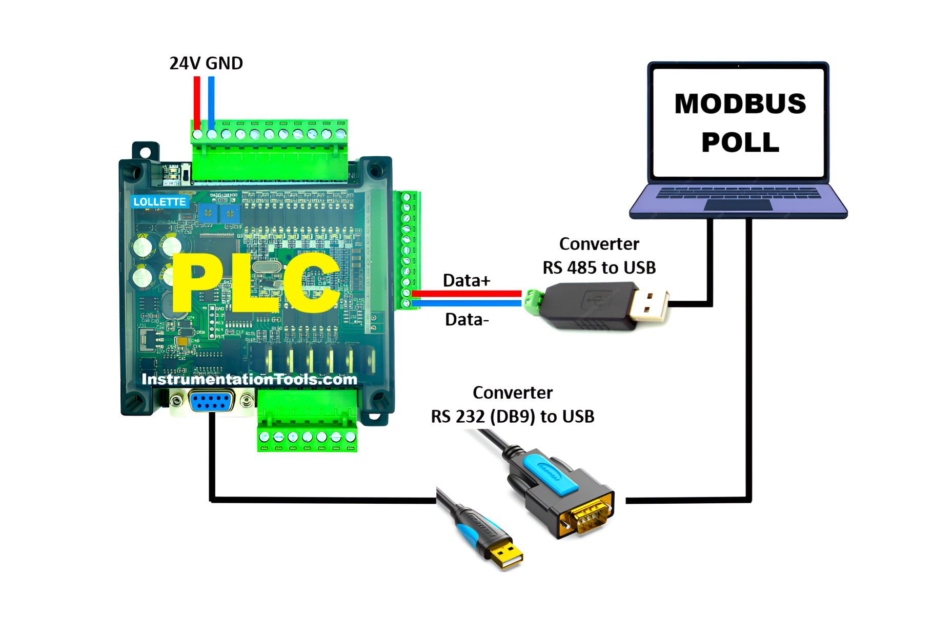

In this system, the PC communicates with the PLC through two channels. Channel 1 uses an RS485 to USB Converter, which connects the PLC to the Modbus Poll software. Channel 2 uses an RS-232 (DB9) to USB Converter to connect the PLC to the GX Works2 software for online monitoring. This setup is necessary because the RS-232 serial port only supports point-to-point communication, meaning it can only connect to one device at a time.

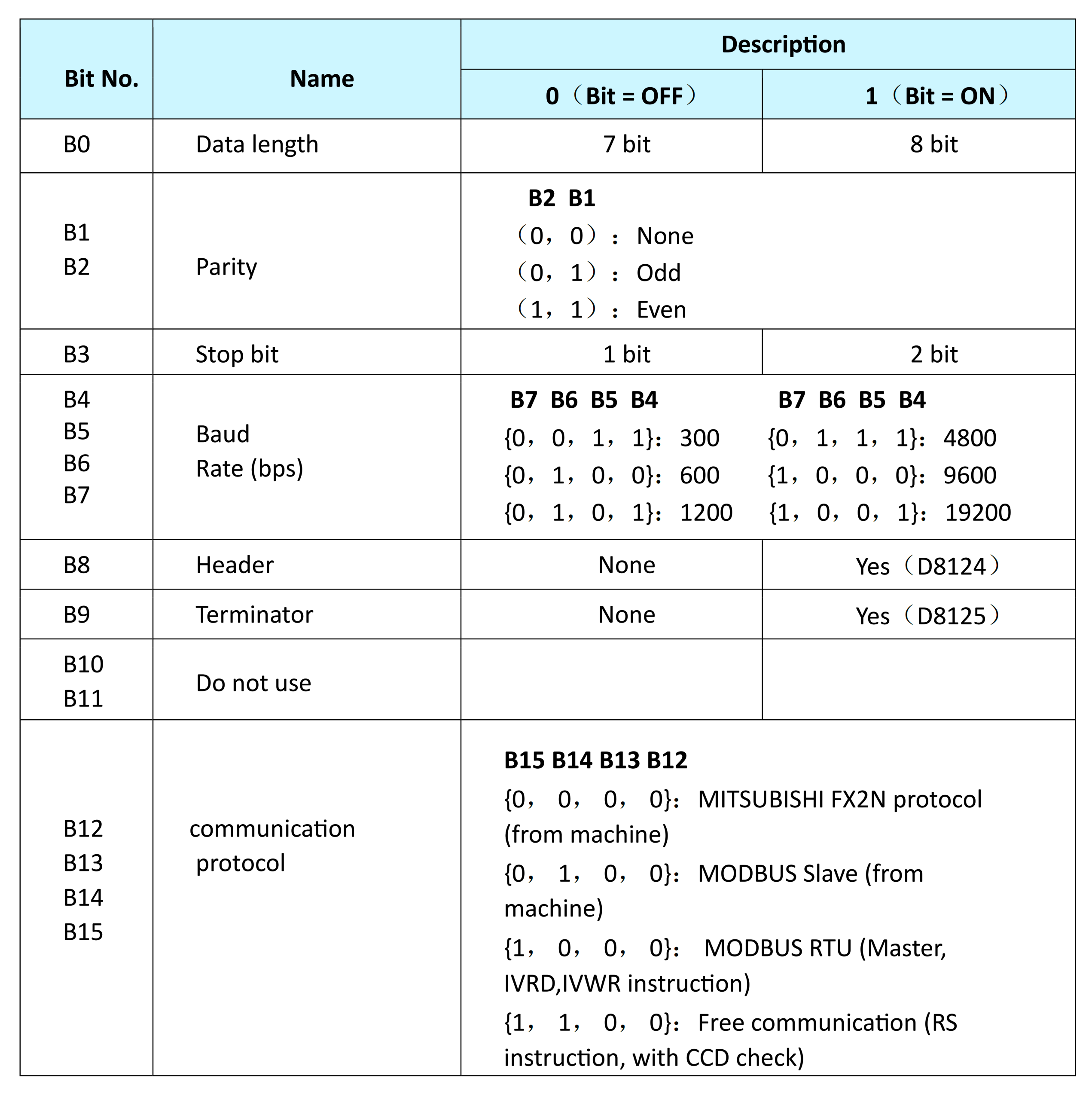

In this configuration, the Slave ID is represented in binary as K1 and is written to the D8121 register using the MOV instruction.
The parameters for Baudrate, Data Bits, Parity, Stop Bit, and Comm. Protocol are combined in hexadecimal format as H4081 and stored in the D8120 register, also using the MOV instruction. The hexadecimal value H4081 corresponds to the binary format 0100 0000 1000 0001, with each bit representing a specific communication setting. These parameter settings refer to the PLC communication configuration format described in the table below.
Communication Settings in D8120

2. Connection Between PLC and Computer
Connect the PLC to the computer using a USB to Serial RS-232 cable and an RS485 to USB converter.

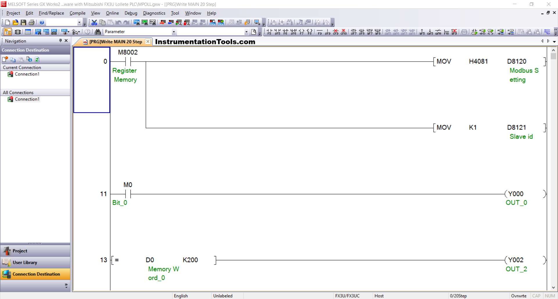

1. Create the Following Program

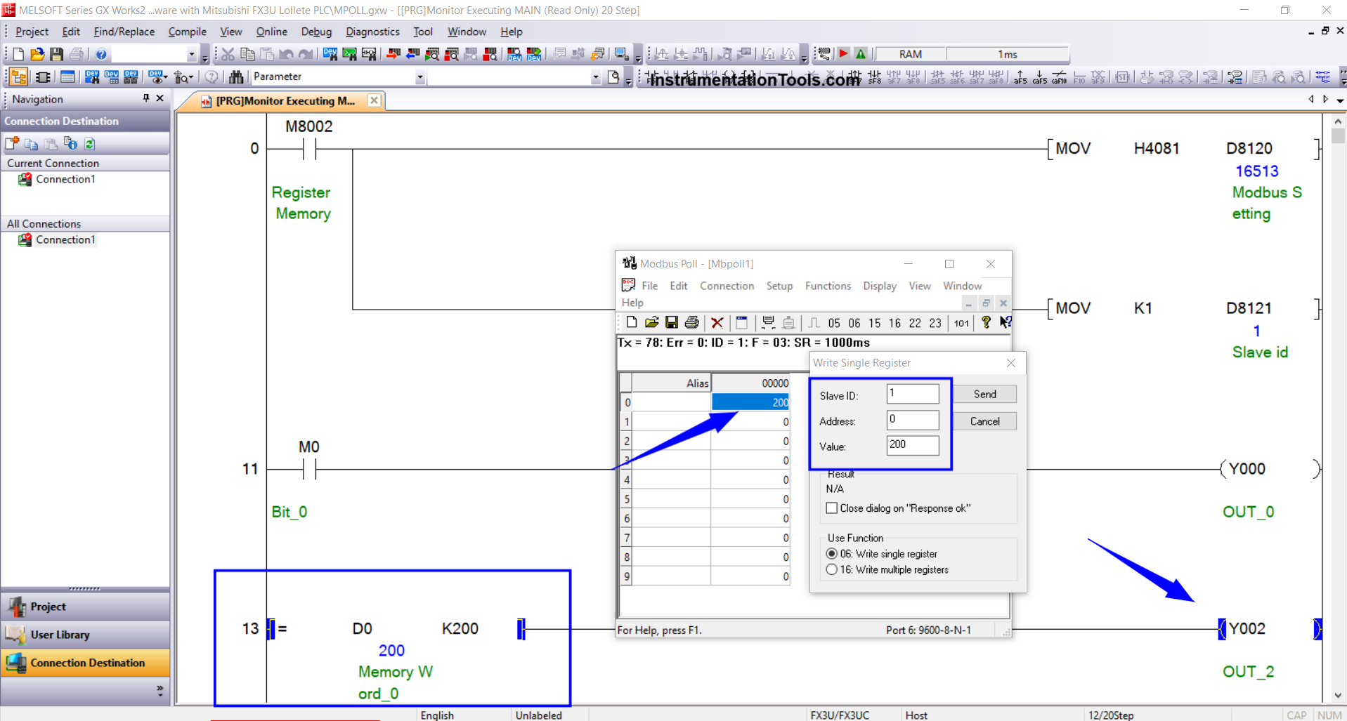

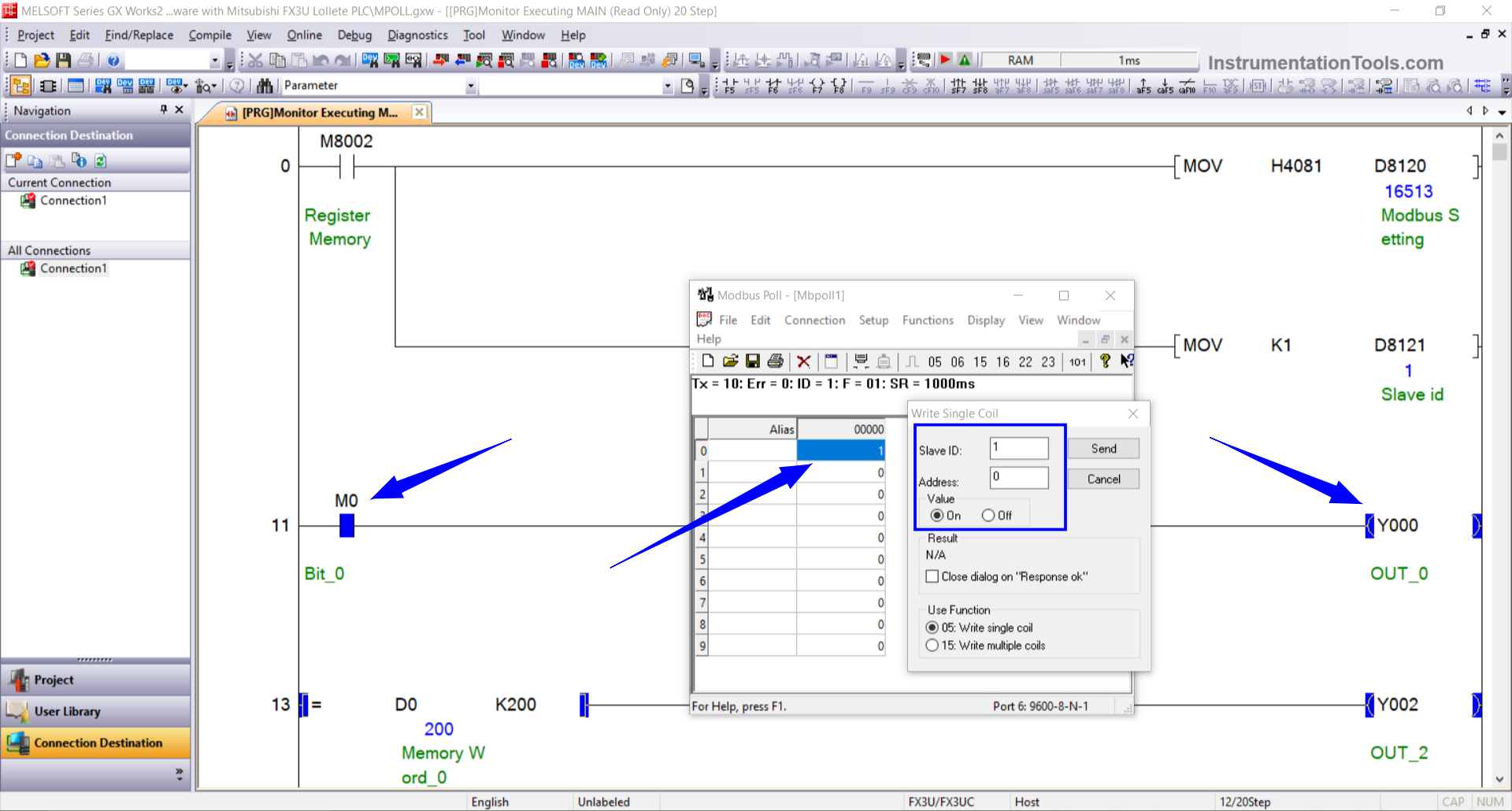

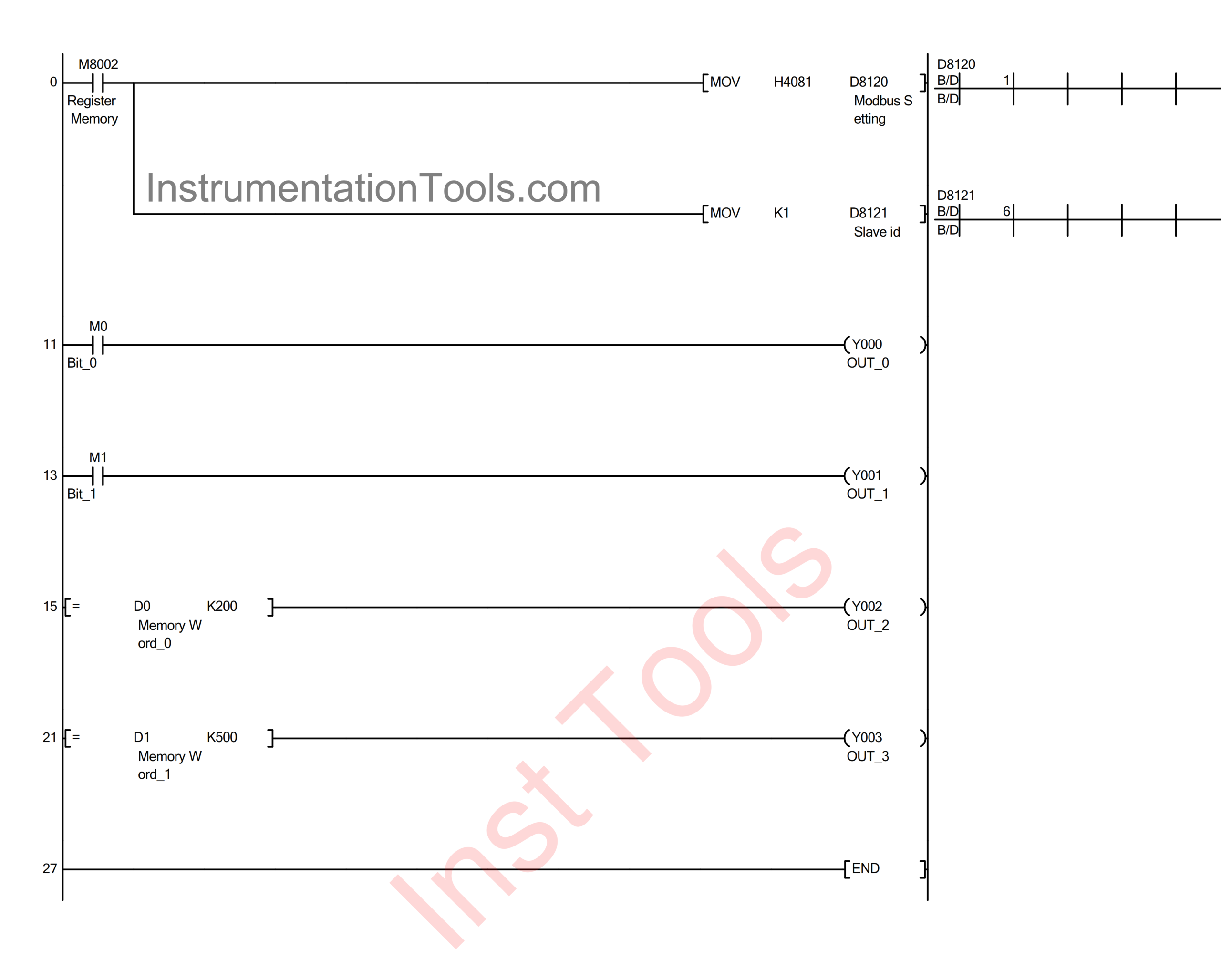

This program sets the PLC memory registers when used as a Slave. The bit memory Bit_0 (M0) and the word memory Memory_Word_0 (D0) will be controlled via Modbus Poll software.
When the NO contact of the Register Memory (M8002) is ON, the MOV instruction will transfer the value H4081 to the word memory Modbus Setting (D8120) and K1 to the word memory Slave ID (D8121).
When the NO contact Bit_0 (M0) is in a HIGH state, the output OUT_0 (Y000) will turn ON.
When the value in the word memory Memory_Word_0 (D0) equals “200”, the output OUT_2 (Y002) will turn ON.

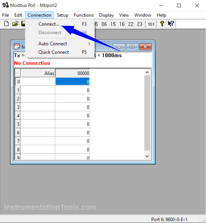

1. Open Modbus Poll Software
Click Connection → Click Connect, or press F3.

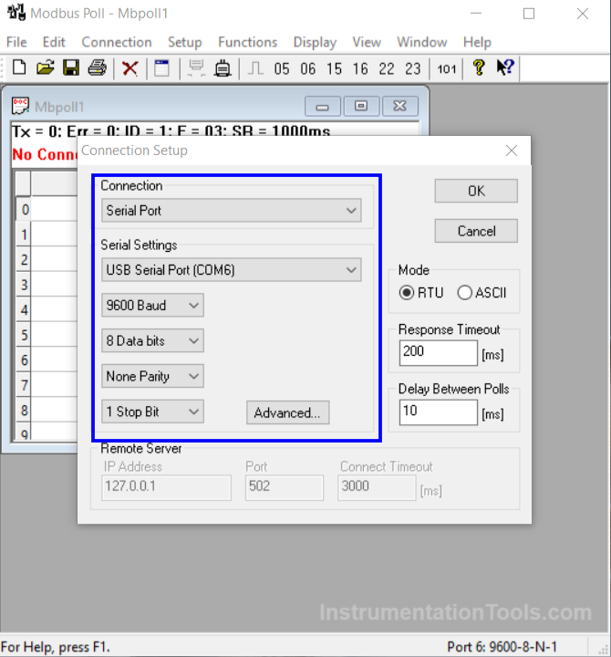

2. Configure the Connection:
- Connection: Serial Port
- Serial Settings: COM 6
- Baudrate: 9600
- Data Bits: 8
- Parity: None
- Stop Bit: 1
- Mode: RTU
- Response Timeout: 200 ms
Click OK.

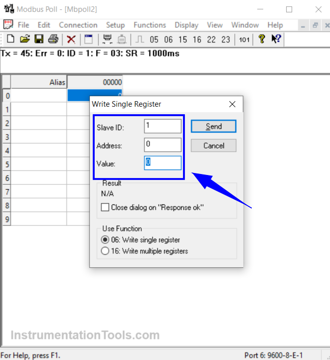

3. Sending Data from Modbus Poll
To send data, enter the value in the Modbus Poll Address field.
Set the value, Address: 0, Slave ID: 1 → Click Send. The data entered will automatically be received by the PLC and can be monitored in GX Works2.
4. Changing the Data Type
To change the type of data sent, open the Function menu → select 06: Write Single Register to send decimal data, or select 05: Write Single Coil to send bit data.
Simulation Result
1. Single coil simulation result
2. Holding register simulation result
