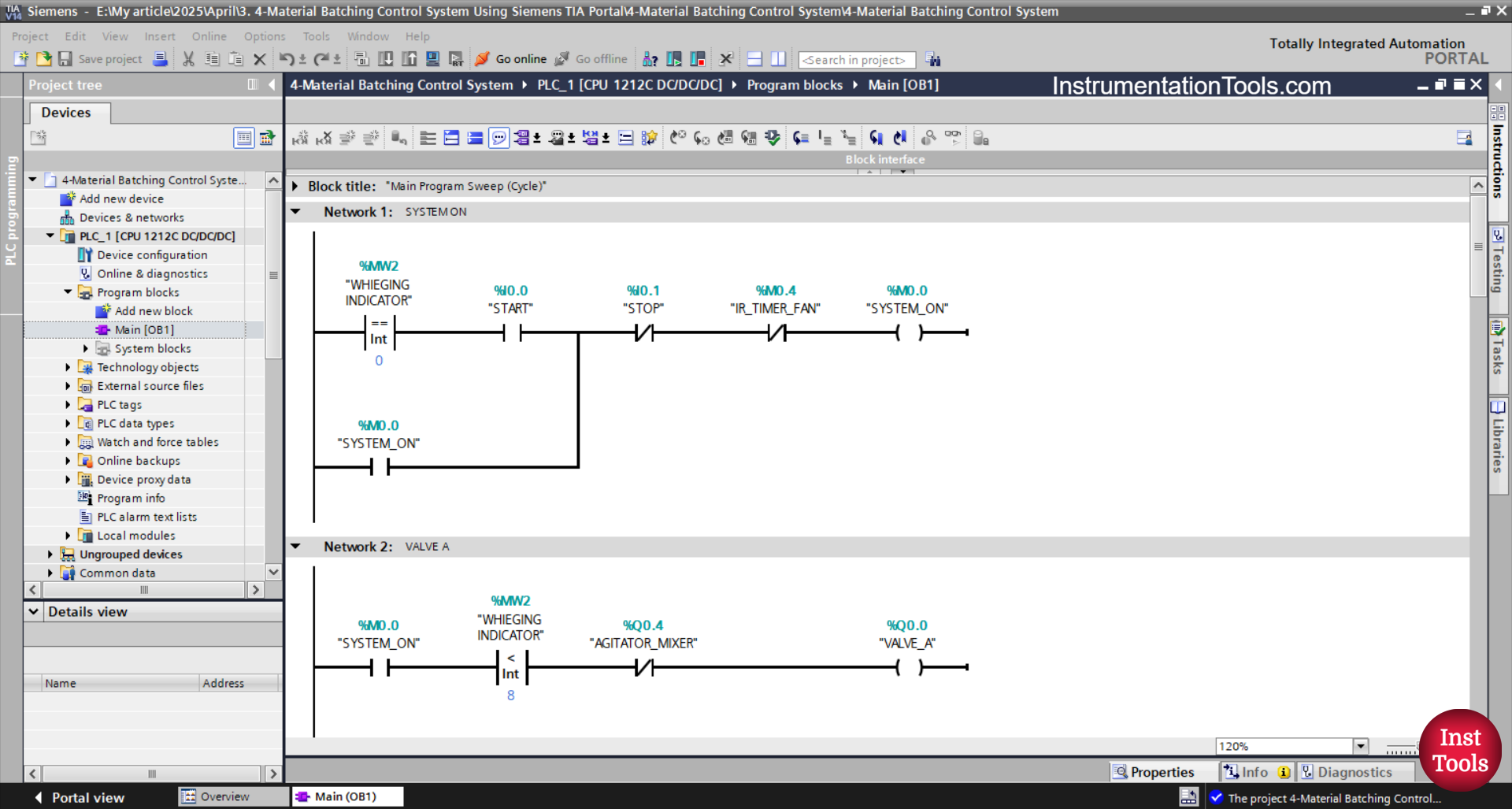

NETWORK 1 (SYSTEM ON)
In this Network, the memory bit SYSTEM_ON (M0.0) will be in a HIGH state if the value in the memory word WEIGHING INDICATOR (MW2) is Equal to “0” and the START(I0.0) button is pressed. The S memory bit SYSTEM_ON (M0.0) will remain in a HIGH state even though the PB_START (I0.0) button has been released, because it uses Latching.
If the STOP (I0.1) button is pressed or the NC contact of the memory bit IR_TIMER_ FAN (M0.4) is in a HIGH state, then the memory bit SYSTEM_ON (M0.0) will return to a LOW state.
NETWORK 2 (VALVE A)
In this Network, the output of VALVE_A (Q0.0) will be OPEN when the NO contact of the memory bit SYSTEM_ON (M0.0) is in HIGH state and the value of the memory word WEIGHING INDICATOR (MW2) is Less Than “8”.
The output of VALVE_A (Q0.0) will be CLOSED when the NC contact of AGITATOR_MIXER (Q0.4) is in HIGH state.

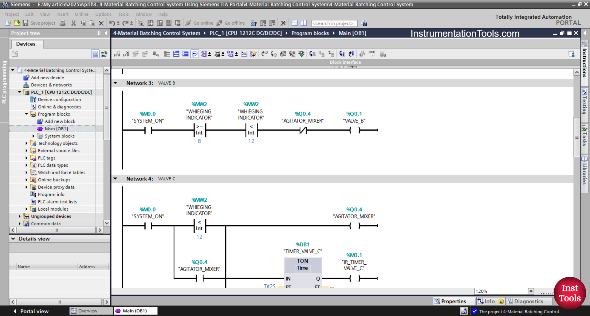

NETWORK 3 (VALVE B)
The output of VALVE_B (Q0.1) will be OPEN when the NO contact of the memory bit SYSTEM_ON (M0.0) is in HIGH state and the value of the memory word WEIGHING INDICATOR (MW2) is Greater than or Equal to “8” and Less than “12”.
If the NC contact of AGITATOR_MIXER (Q0.4) is in HIGH state, then the output of VALVE_B (Q0.1) will be CLOSED.

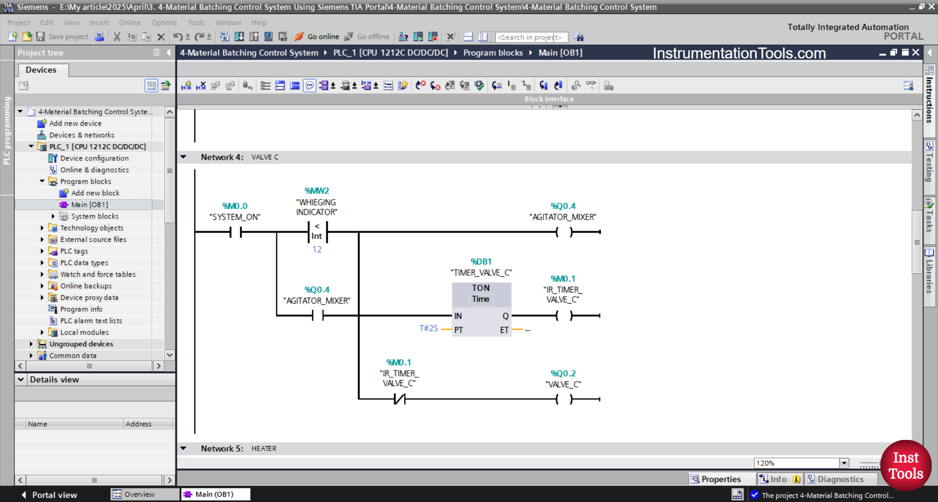

NETWORK 4 (VALVE C)
The AGITATOR_MIXER (Q0.4) output will be ON and the VALVE_C (Q0.2) output will be OPEN when the NO contact of the memory bit SYSTEM_ON (M0.0) is in HIGH state and the value of the memory word WEIGHING INDICATOR (MW2) is Equal to “12”.
The TIMER_VALVE_C (DB1) timer will start counting for 2 seconds.
After finishing counting, the VALVE_C (Q0.2) output will be CLOSED because of the Interlock of the memory bit IR_TIMER_VALVE_C (M0.1).

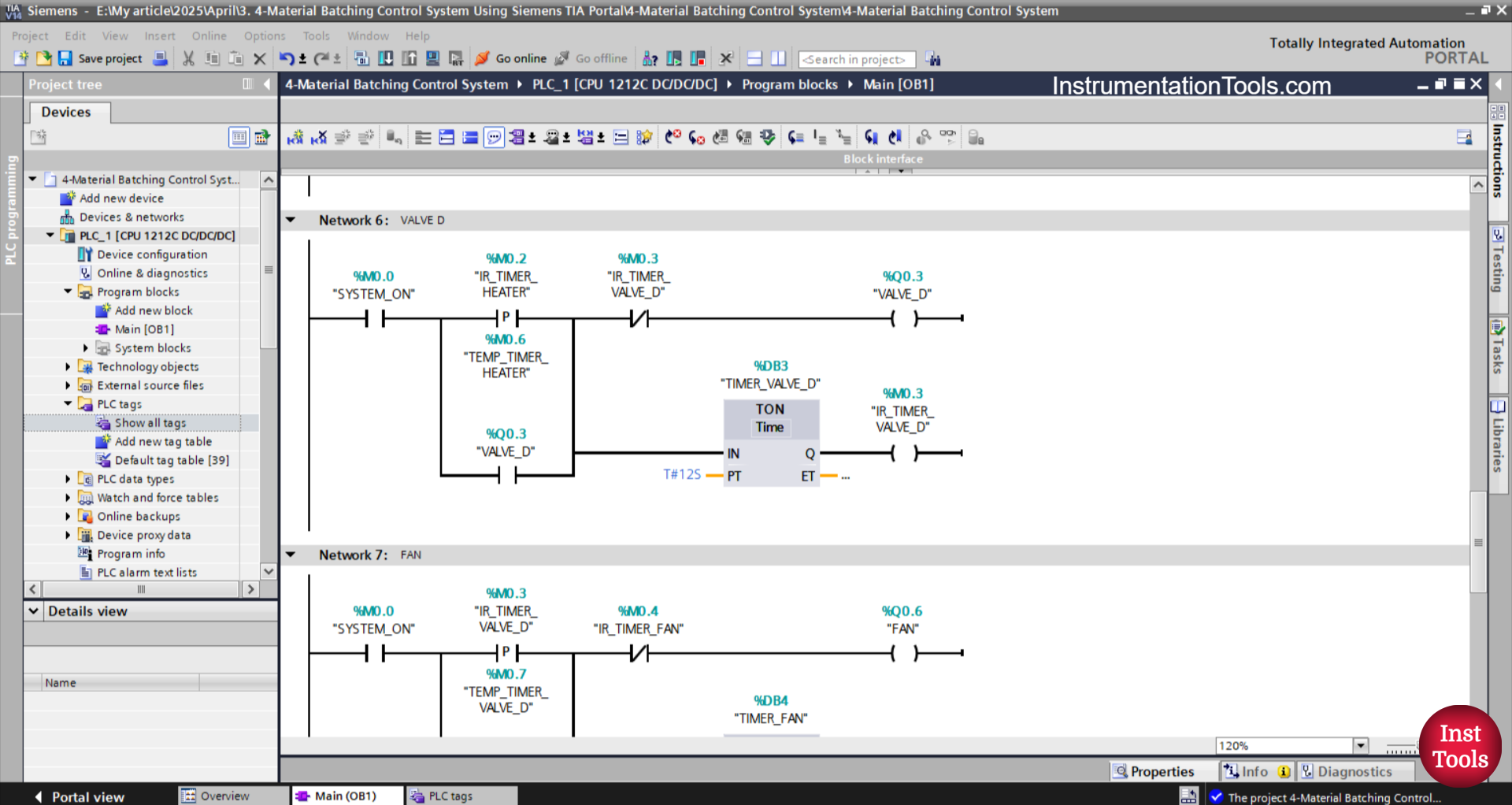

NETWORK 6 (VALVE D)
The output of VALVE_D (Q0.3) will be OPEN when the NO contact of the memory bits SYSTEM_ON (M0.0) and IR_TIMER_HEATER (M0.2) are in the HIGH state. Although the NO contact of the memory bit IR_TIMER_HEATER (M0.2) is in the LOW state, the output of VALVE_D (Q0.3) will remain OPEN because it uses Latching.
The TIMER_ VALVE_D (DB3) timer will start counting for 12 seconds.
After finishing counting, the output of VALVE_D (Q0.3) will be CLOSE because of the Interlock of the memory bit IR_TIMER_ VALVE_D (M0.3).
NETWORK 7 (FAN)
The output FAN (Q0.6) will be ON when the NO contact of the memory bits SYSTEM_ON (M0.0) and IR_TIMER_ VALVE_D (M0.3) are in the HIGH state. The FAN output (Q0.6) will remain ON even though the NO contact of the memory bit IR_TIMER_ VALVE_D (M0.3) is in the LOW state. Because it uses Latching.
The TIMER_ FAN (DB4) timer will start counting for 12 seconds.
After finishing counting, the output FAN (Q0.6) will be OFF because of the Interlock of the memory bit IR_TIMER_ FAN (M0.4).
