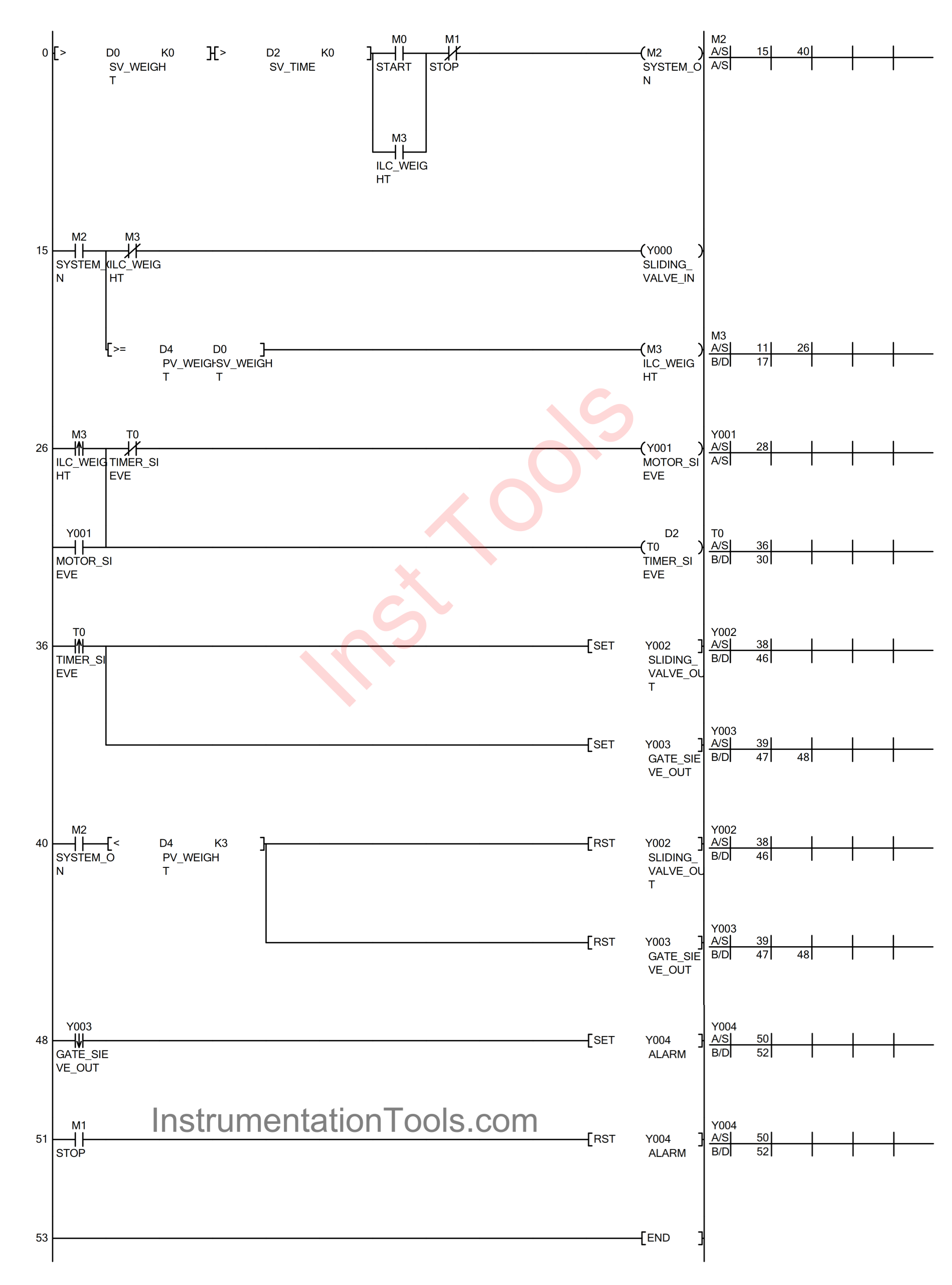

Mitsubishi PLC Based Logic

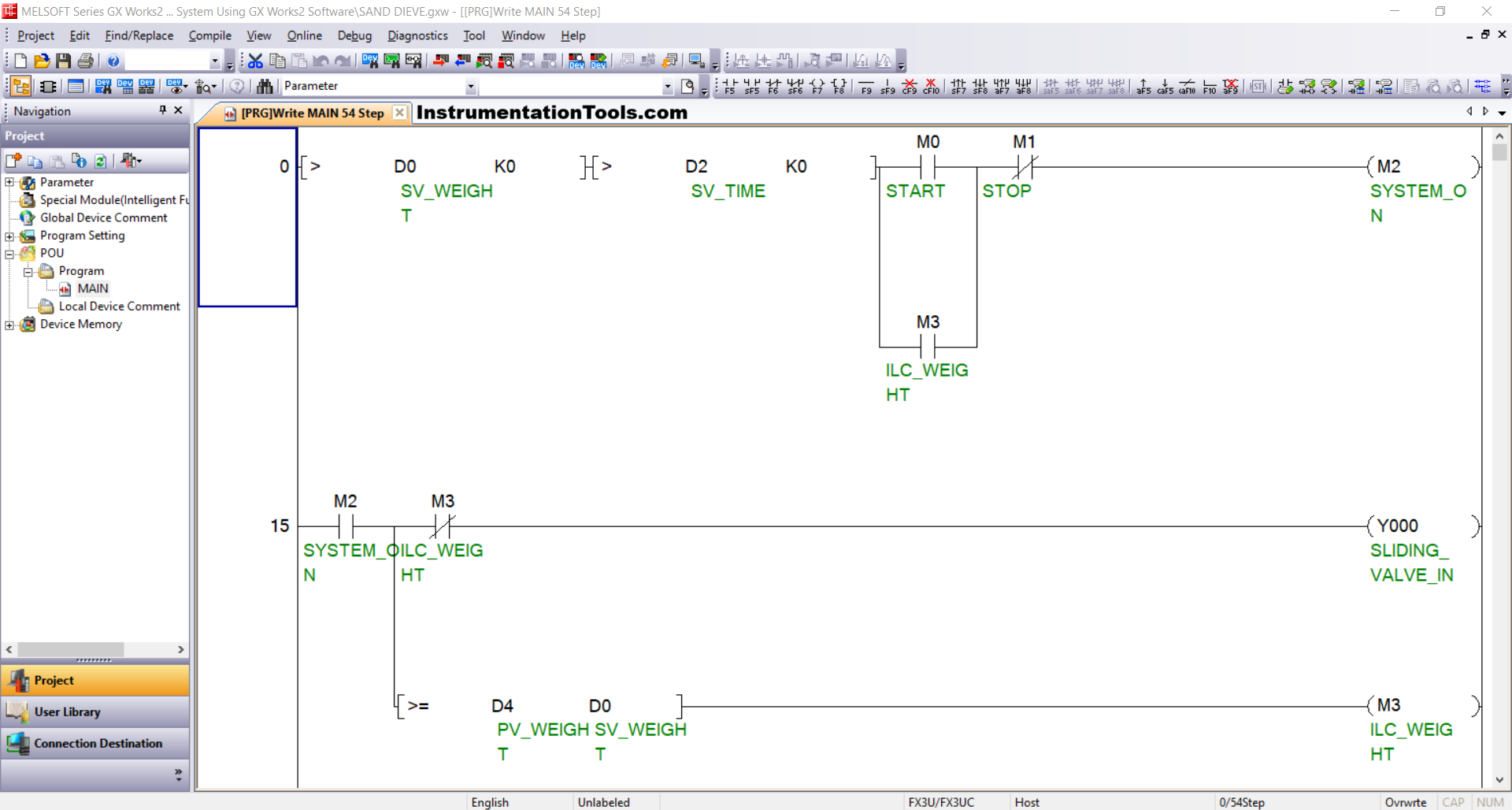

RUNG 0
In this Rung, the memory bit SYSTEM_ON (M2) memory bit will be in a HIGH state if the START (M0) button is pressed and the value in the SV_WEIGHT (D0) and SV_TIME (D2) memory words is greater than zero “0”. Even though the START(M0) button has been released, the memory bit SYSTEM_ON (M2) will remain in a HIGH state. Because it uses Latching.
If the STOP(M1) button is pressed, the memory bit SYSTEM_ON (M2) will be in a LOW state.
RUNG 15
In this Rung, the SLIDING_VALVE_IN (Y000) output will be OPEN if the NO contact of the memory bit SYSTEM_ON (M2) is in a HIGH state.
The memory bit ILC_WEIGHT (M3) will be in HIGH state when the value in the memory word PV_WEIGHT (D4) is greater than or equal to SV_WEIGHT (D0).
The SLIDING_VALVE_IN (Y000) output will be CLOSED due to the Interlock.

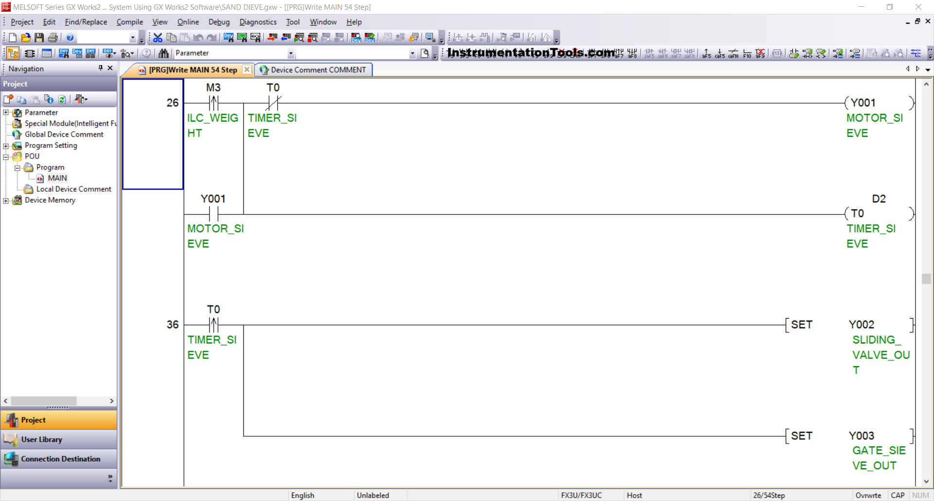

RUNG 26
In this Rung, the MOTOR_SIEVE (Y001) output will be ON, and the TIMER_SIEVE (T0) timer will start counting when the NO contact of the memory bit ILC_WEIGHT (M3) is in the HIGH state. Although the memory bit ILC_WEIGHT (M3) has been in the LOW state, the MOTOR_SIEVE (Y001) output will remain ON. Because it uses Latching.
The MOTOR_SIEVE (Y001) output will be OFF because of the interlock of the TIMER_SIEVE (T0) timer.
RUNG 36
The SLIDING_VALVE_OUT (Y002) and GATE_SIEVE_OUT (Y003) outputs will be OPEN when the NO contact of the TIMER_SIEVE (T0) timer is in the HIGH state.
Even though the NO contact of the timer TIMER_SIEVE (T0) has been in the LOW state, the output SLIDING_VALVE_OUT (Y002) and GATE_SIEVE_OUT (Y003) will remain OPEN. Because it uses the SET instruction.

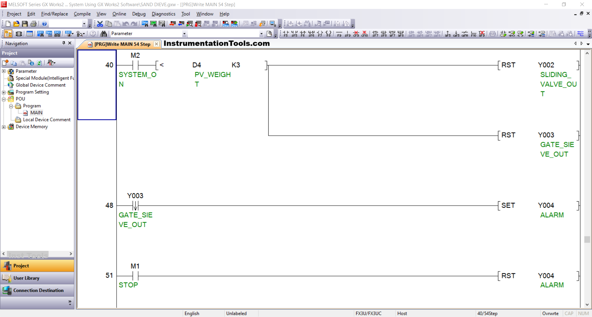

RUNG 40
In this Rung, the output SLIDING_VALVE_OUT (Y002) and GATE_SIEVE_OUT (Y003) will be CLOSED when the NO contact of the memory bit SYSTEM_ON (M2) is in the HIGH state and the value in the PV_WEIGHT memory word (D4) is less than “3”. Because it uses the RST instruction.
RUNG 48
When the NO contact of GATE_SIEVE_OUT (Y003) is in the HIGH state, the ALARM (Y004) output will be ON.
RUNG 51
If the STOP (M1) button is pressed, the ALARM (Y004) output will be OFF. Because it uses the RST instruction.
