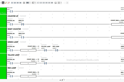

Jump instruction in ladder logic is used to skip some process or rungs according to the requirement. It is paired with Label which is used to limit the skipping the process.
Example – JUMP Instruction in PLC Ladder LogicPLC ProgramProgram DescriptionRUNG 0000RUNG 0001RUNG 0002 RUNG 0003RUNG 0004 RUNG 0005Rung 0007When JUMP condition is OFF :When JUMP condition is ON :Jumping BackwardConclusion:
Jump Instruction in PLC
Let’s study the working of jump instruction using an example.
There are seven motors used for various processes. On-demand base Motors 4, 5 & 6 are needed.
Design a program to skip motor 4, 5 & 6 when it does require for the process.
PLC Program
How to Use Jump Instruction in PLC Programming
PLC programming JMP and LBL
Program Description
RUNG 0000
The input I:0/0 is used to turn on  Motor 1.
RUNG 0001
The input I:0/1 is used to turn on  Motor 2.
RUNG 0002
The input I:0/2 is used to turn on  Motor 3.
 RUNG 0003
The input I:0/3 is used to initiate the jump function (Q2:0).
RUNG 0004
The input I:0/0 & I:0/4  is used to turn on  Motor 4.
 RUNG 0005
The input I:0/1 and I:0/5 is used to turn on  Motor 5.
Rung 0007
Label instruction is used to finish the jump function.
The input I:0/6 and I:0/2  is used to turn on  Motor 6.
jump instruction in ladder logic
LBL Instruction in PLC program
When Jump condition is not initiated or enabled, all outputs will turn ON/OFF according to respective input.
JMP instruction in PLC Programming
Rung 4, 5 & 6 are completely skipped till label function.
Jumping Backward
If we use label instruction first and then jump will perform jumping backward function.
Jump Instruction for Allen-Bradley
Jump in Programmable Logic controllers
Jump instruction resumes program execution before the label and after the jump instruction. In between rungs will work on respective inputs.
Conclusion:
The above-explained jump instruction is for example only. It may vary from real-time applications.
