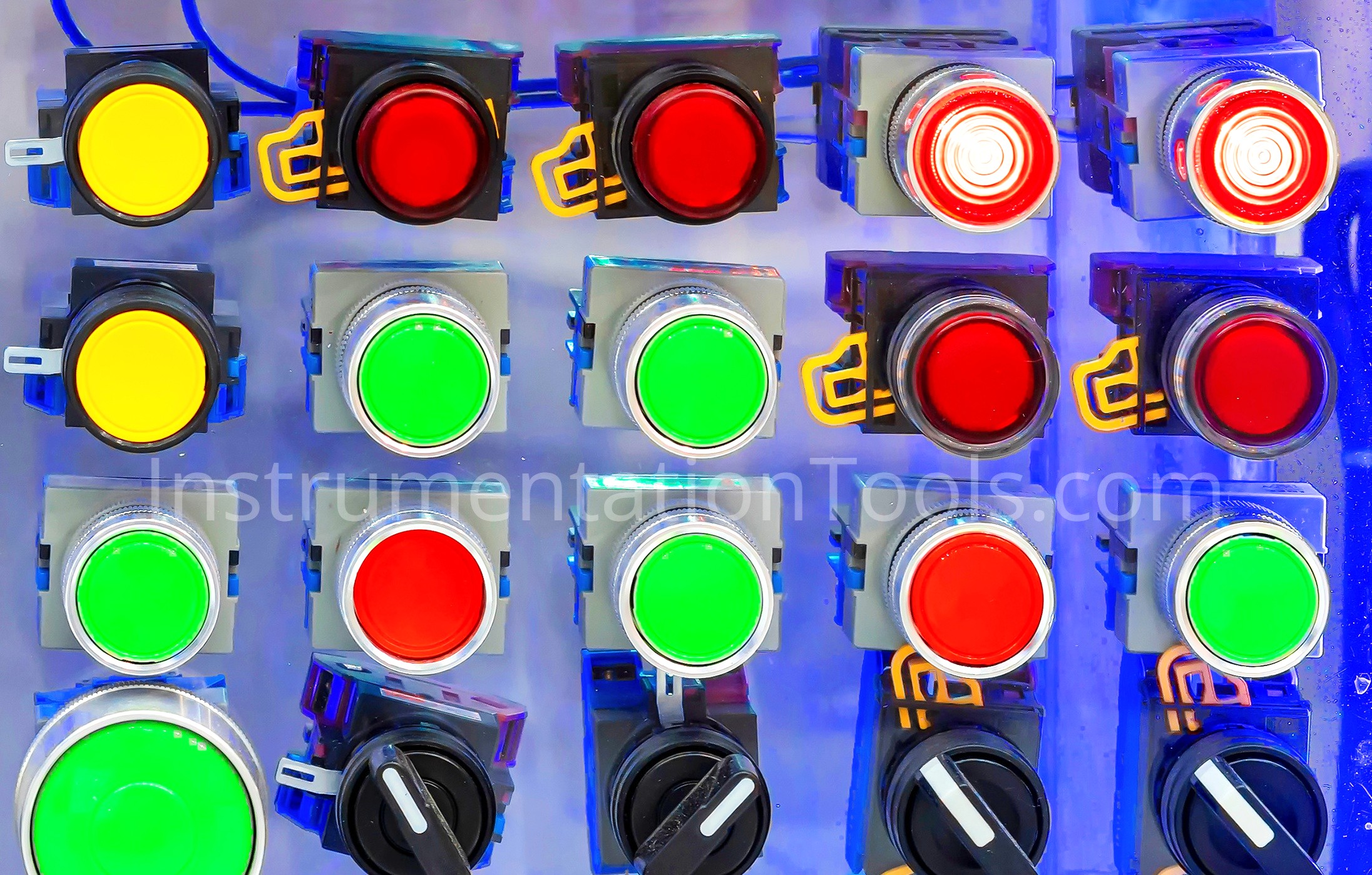

Emergency stop is a control signal which is used to block the flow of power supply to a certain circuit, or can be used as an input to a controller which will ask that to stop the logic. It comes in a toggle switch type and needs to be pressed for control. It thus remains pressed until released once again.
Basically, every control circuit has this input connected in series and in NC condition. In this case, the power supply will be given to the circuit under normal conditions. When the switch is pressed, the NC contact will open and thus block the supply to the further circuit. It will remain in this state until then user has again released the button and the open state becomes closed once again.
In the case of a controller like PLC, an auxiliary contact will be taken from this button and fed as an input to the PLC. Logic will be required to be written in the PLC where it will stop the process on this input going off. NC contact is used so that in case the wire breaks, then too the circuit will detect as input gone and halt the supply.
