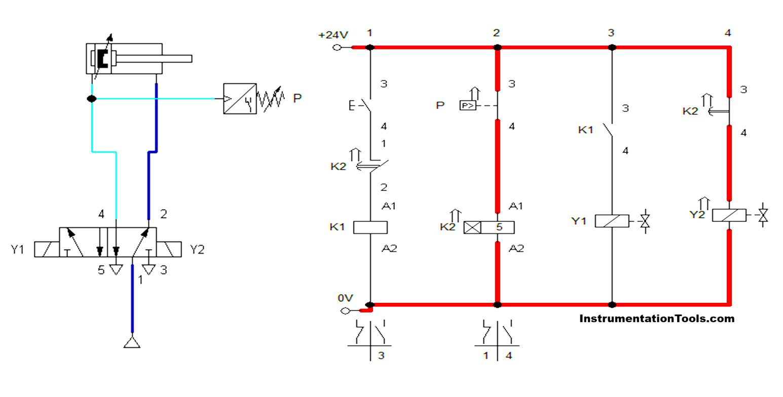

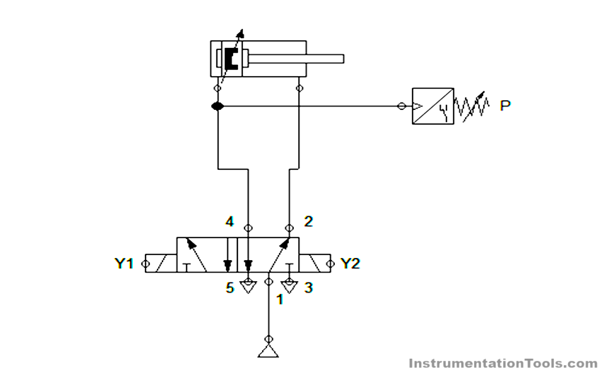

  • In a pneumatic circuit, an operating pressure of 6 bar is given to the system through the compressor
  • The output supply from the compressor is given to the 5/2 Direction control valve, which is connected to the double-acting cylinder. During that connection cylinder was in home position. And the Pressure sensor was connected to the extend stroke connection of the cylinder.

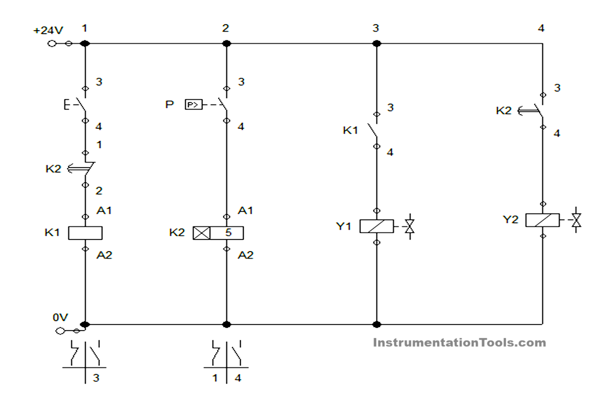

  • In an electric circuit, power supply of 24V DC is used. Thus, the whole system was operated with the 24V only.

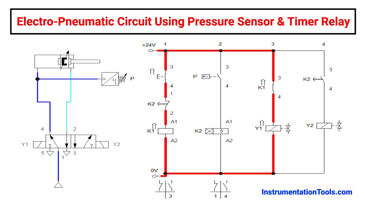

  • Once the start button is pressed, the relay K1 is activated, which activates the solenoid coil Y1. The activation of solenoid Y1 makes the cylinder to move forward.
timer relay in pneumatic circuit
  • Since the cylinder was extended forward, the pressure will be in the extended port where the pressure sensor was connected.

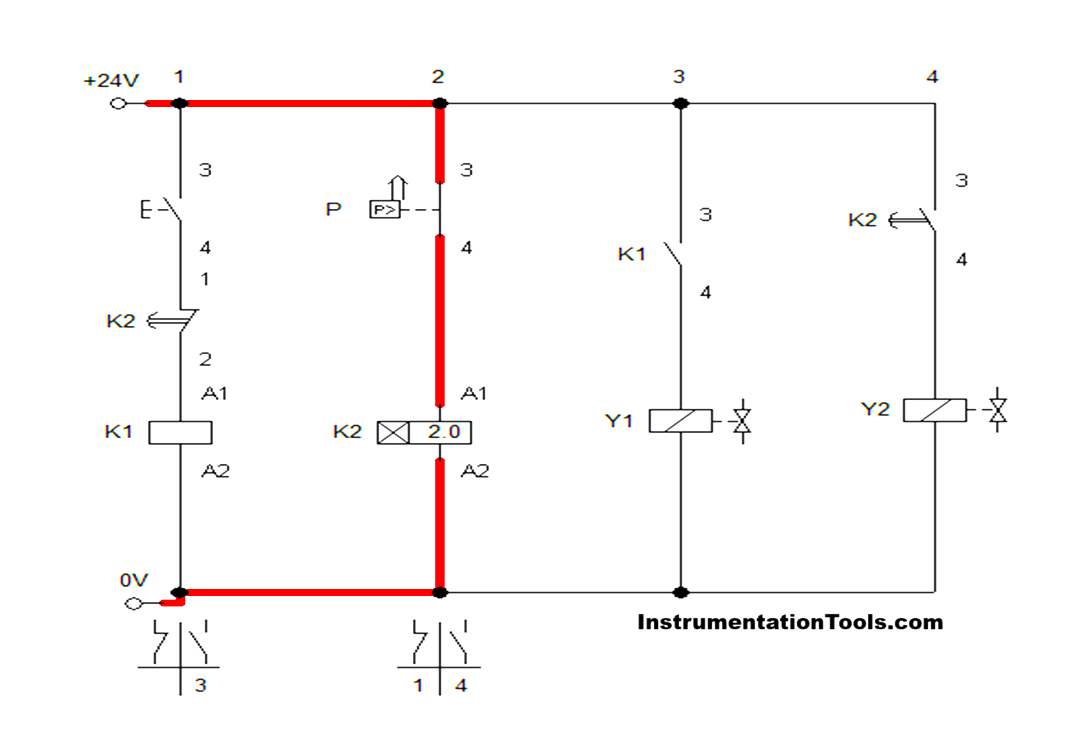

  • In the pressure sensor, the switching pressure of 5 bar is fixed. Since the switching pressure is less than the operating pressure, the pressure sensor connection was activated in the electrical circuit.

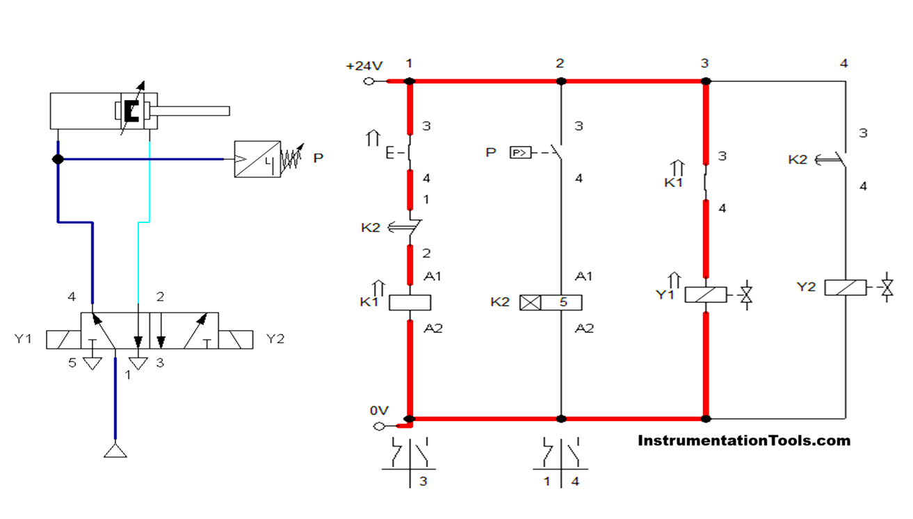

  • Activation of the pressure sensor causes the timer to activate. On-delay time of 5 second was set on the timer. Once the 5 seconds were completed on the timer, the timer connection makes the solenoid Y2 activate by breaking the connection of relay coil K1 and solenoid coil Y1.
electro-pneumatic relay logic
  •  Activation of solenoid coil Y2 causes the cylinder to retract and makes the cycle complete. Thus, the cylinder reaches its home position, and the process will continue after pressing the start button.
