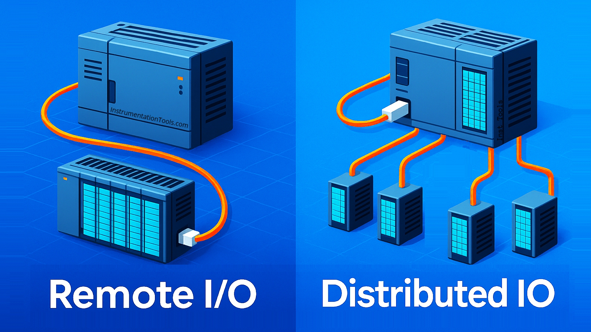

Difference Between Remote IO and Distributed IO Systems
How the Architectures Differ: At a Glance
Understanding the differences between these two architectures is essential for choosing the right one for your application.
You may refer to the side-by-side comparison below for a summary of differences:
FeatureRemote I/ODistributed I/O
Control Logic LocationCentralized in the PLC/controllerDecentralized or shared
Processing CapabilityMinimal to none at the I/O levelSmart I/O with local processing
Communication LoadHigher network dependencyReduced due to local decision-making
ScalabilityModerateHigh
Fault IsolationMore difficultEasier and localized
Setup ComplexitySimpler to install and configureMore complex but flexible
