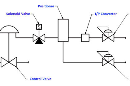

Control Valve Consists of the following elements:
1. Actuator
2. Positioner
3. Valve Body
Main Parts of Control Valve
Actuator:
The Actuator is the Upper Portion of the Cylinder, which allows the diaphragm to move the valve steam upward and downward.
Positioner:
The Positioner is nothing but an advanced I to P converter, which converts the 4-20mA signal to Pneumatic 3-15Psi, and allows the stem of the actuator for the movement to and fro.
