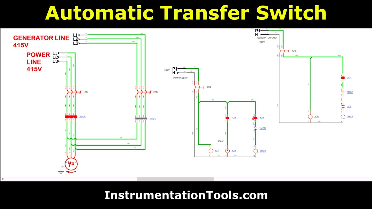

Simulation
Automatic Transfer Switch

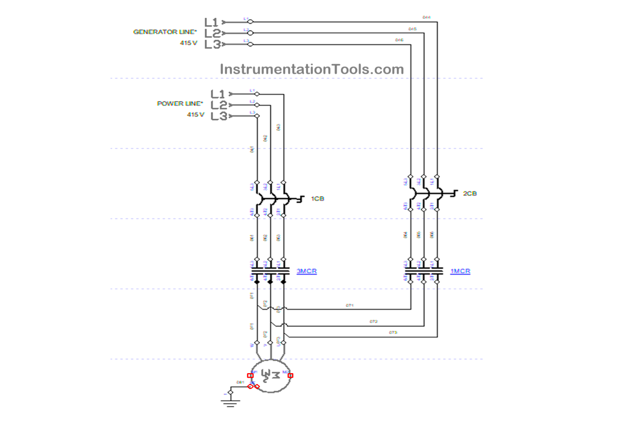

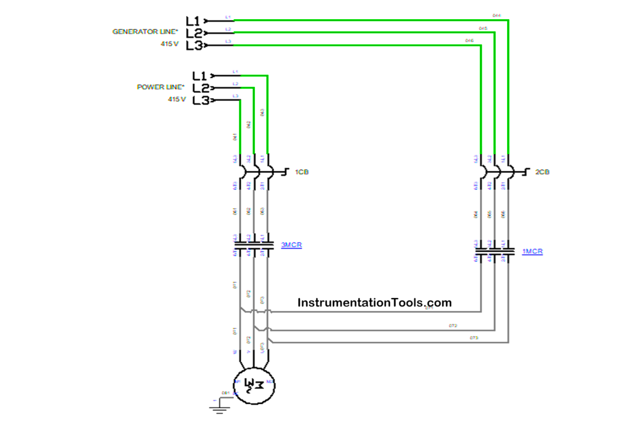

Power Circuit:
automatic transfer switch working principle

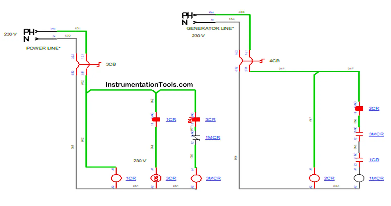

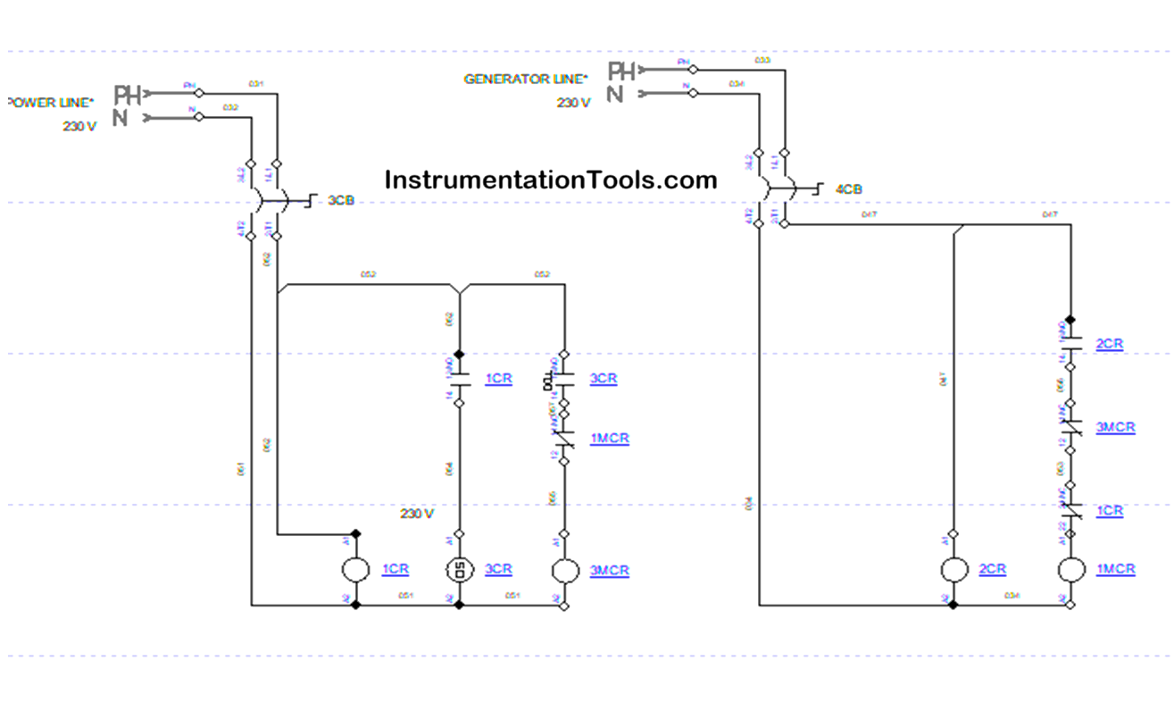

Control Circuit:
how does automatic transfer switch work

Three-phase supply of 415 V from both the Power Supply Line and the Generator was given to the circuit. Both the supply lines were connected to the separate MCBs, the Power Supply Line was connected to 1 CB, and the Generator line was connected to 2 CBs.
automatic transfer switch for generator backup
Then both the MCBs were connected to the Contactor, which contacts the load, i.e., the Motor. 1 CB was connected to the contactor 1 (3 MCR), and 2 CB was connected to the contactor 2 (1 MCR).
While operating, both the MCBs 1 CB and 2 CB need to be in the ON condition for the automatic changeover. This completes the Main power circuit of the operation.
Single Phase supply of 230 V was given to the control circuit, likewise Power circuit in the control circuit also we are using two MCBs to control the contactor coils.
Power supply control line is directly connected to the two-pole circuit breaker 2CB, and the Generator line is directly connected to another two-pole circuit breaker 3CB.
The output of circuit breaker 3CB was directly connected to the relay coil 1 CR, timer coil 3CR, contactor coil 3 MCR, and its contacts.
Then the output of circuit breaker 4CB was directly connected to the relay coil 2 CR, contactor coil 1 MCR, and its contacts.

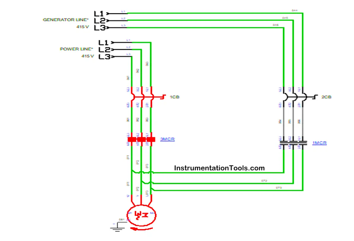

Power Supply of 415 V was given to the circuit breakers 1 CB and 2 CB, and both the MCBs were powered ON in the main circuit

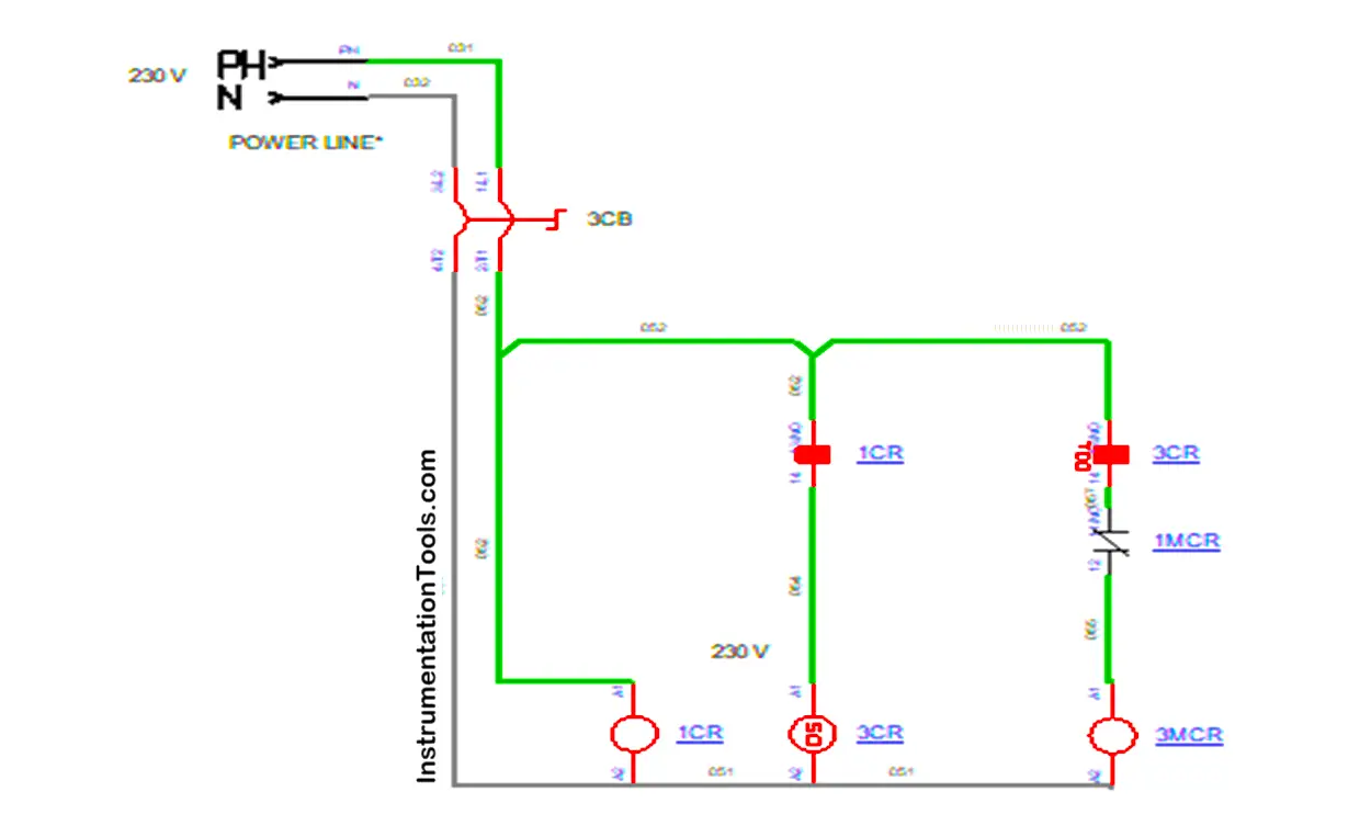

Power Supply of 230 V was given to the circuit breakers 3 CB and 4 CB, and both the MCBs were powered ON in the control circuit.
Because of the power supply given to the circuit breaker, the 3 CB Relay coil 1CR got energized, which makes its contact close and energize the timer 3 CR. The contacts of the timer get closed after 2 2-second of delay.

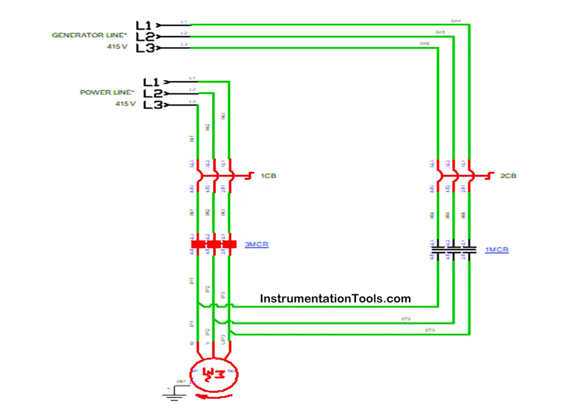

Once the timer contact gets closed, it will activate the contactor coil 3 MCR, which will make the contactor 3 MCR activate and which will energize the load, and the Motor will start rotating.
generator auto transfer switch function
At the same time, the Generator Line MCB 4CB also turned on, but the contactor coil will not get energized since the normally closed contact of Contactor 3 MCR was connected in series connection.

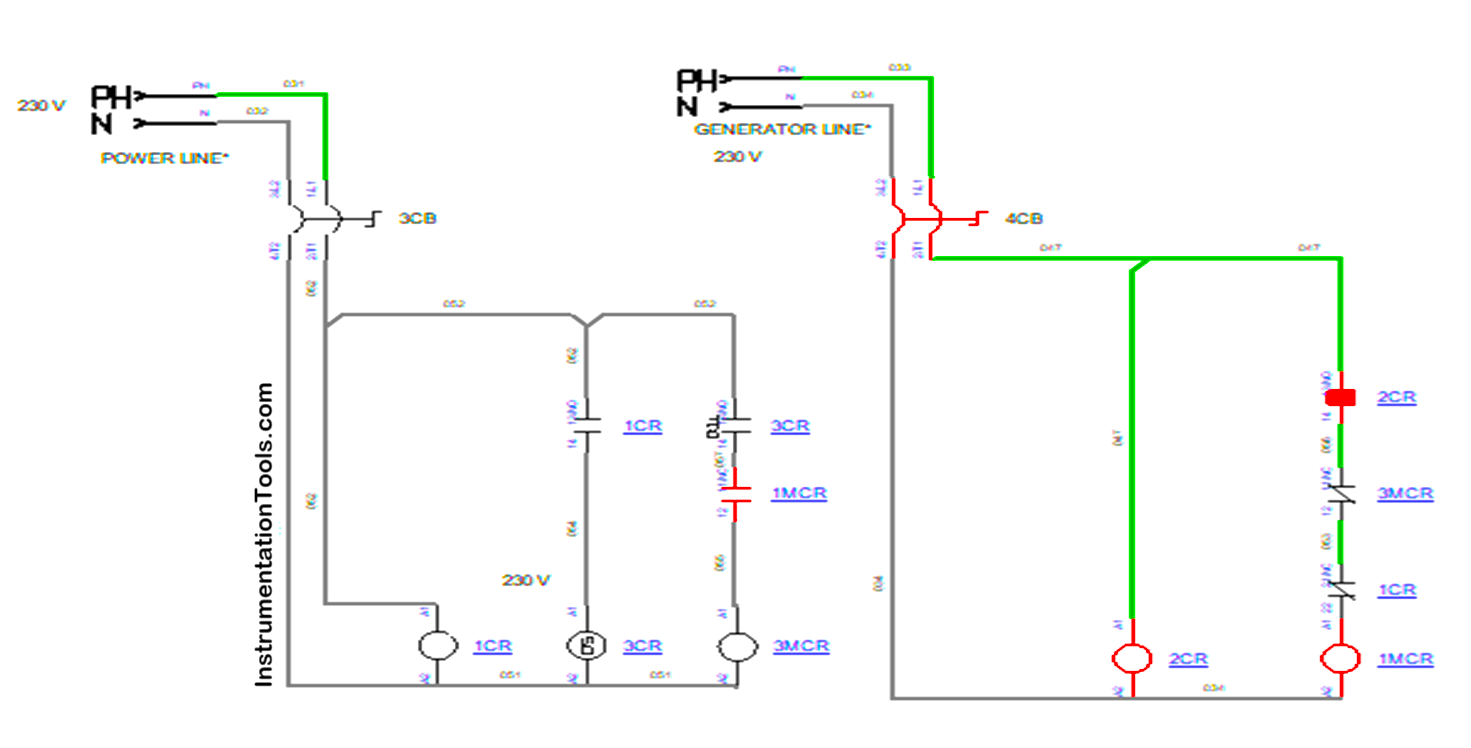

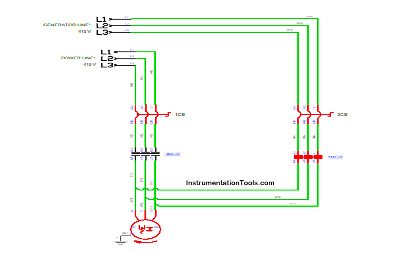

Once the power is interrupted in the Power Supply line means the generator power will energize the contactor coil 1 MCR, and the motor rotates without stopping because of the continuous supply with the help of the backup generator supply. There will be no time gap or manual operation.
automatic changeover switch explained
smart automatic transfer switch design
Then, after the Power supply was rectified in the main line, the contactor 3 MCR will get activated and cut the supply to contactor 1 MCR, which means the load will work with the main power supply.
