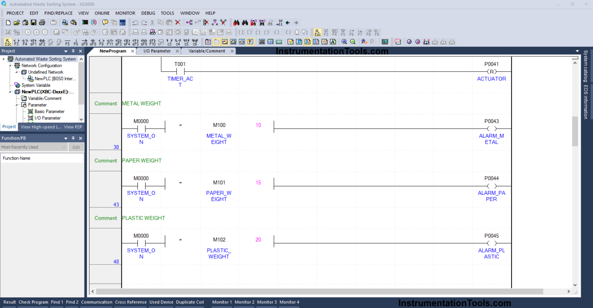

RUNG 38 (METAL WEIGHT)
When the NO contact of the memory bit SYSTEM_ON (M0000) is in the HIGH state and the value in the memory word METAL_WEIGHT (M100) is Equal to “10”, then the output ALARM_METAL (P0043) will be ON.
RUNG 43 (PAPER WEIGHT)
When the NO contact of the memory bit SYSTEM_ON (M0000) is in the HIGH state and the value in the memory word PAPER_WEIGHT (M101) is Equal to “15”, then the output ALARM_PAPER (P0044) will be ON.
RUNG 48 (PLASTIC WEIGHT)
When the NO contact of the memory bit SYSTEM_ON (M0000) is in the HIGH state and the value in the memory word PLASTIC_WEIGHT (M101) is Equal to “20”, then the output ALARM_PLASTIC (P0045) will be ON.
