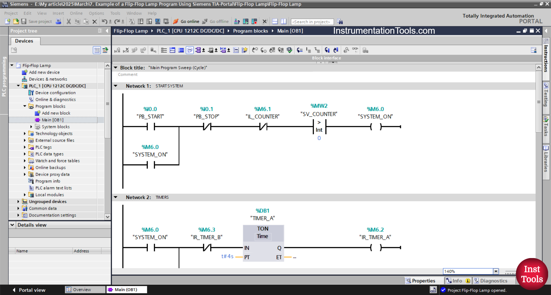

NETWORK 1 (START_SYSTEM)
In this Network, the memory bit SYSTEM_ON (M6.0) will be in a HIGH state if the PB_START (I0.0) button is pressed and the value in the SV_COUNTER (MW2) word memory is Greater Than zero “0”. Even though the PB_START (I0.0) button has been released, the memory bit SYSTEM_ON (M6.0) will remain in a HIGH state. Because it uses Latching.
If the PB_STOP (I0.1) button is pressed or the NC contact of the memory bit IL_COUNTER (M6.1) is in a HIGH state, then the memory bit SYSTEM_ON (M6.0) will return to a LOW state.

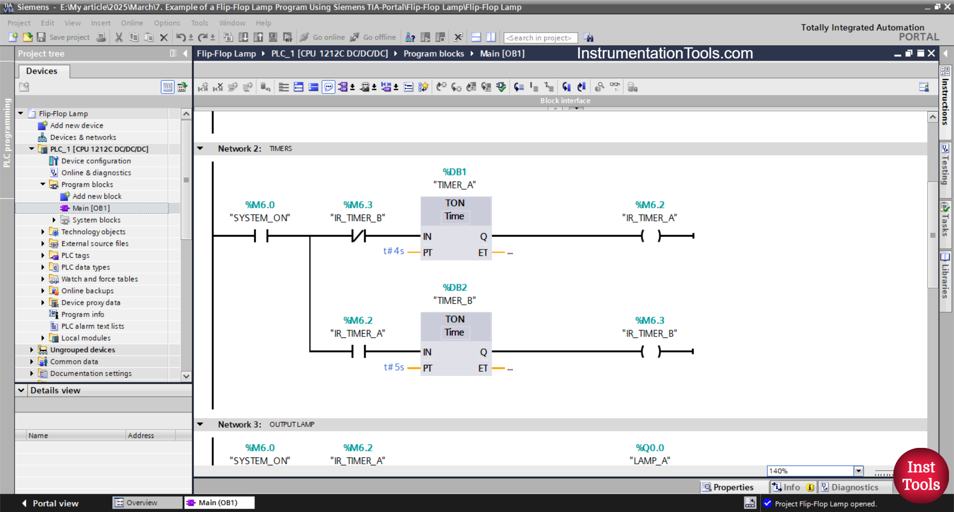

NETWORK 2 (TIMERS)
In this Network, when the NO contact of the memory bit SYSTEM_ON (M6.0 in a HIGH state, the timer TIMER_A (DB1) will start counting up to 4 seconds.
Once the timer TIMER_A (DB1) completes its countdown, the memory bit IR_TIMER_A (M6.2) will switch to a HIGH state, and the timer TIMER_B (DB2) will begin counting up to 5 seconds.
When the timer TIMER_B (DB2) finishes counting, the memory bit IR_TIMER_B (M6.3) will switch to a HIGH state, and TIMER_A (DB1) will turn OFF due to the interlock from the memory bit IR_TIMER_A (M6.2).
Shortly after, the timer TIMER_B (DB2) will also turn OFF, and the system will repeat the process.
NETWORK 3 (OUT LAMP)
In this Network, the output LAMP_A (Q0.0) will be ON when the NO contact of the memory bit SYSTEM_ON (M6.0) is in the HIGH state and the NC contact of the memory bit IR_TIMER_A (M6.2) is in the LOW state.
The output LAMP_B (Q0.1) will be ON when the NO contact of the memory bit IR_TIMER_A (M6.2) is in the HIGH state.

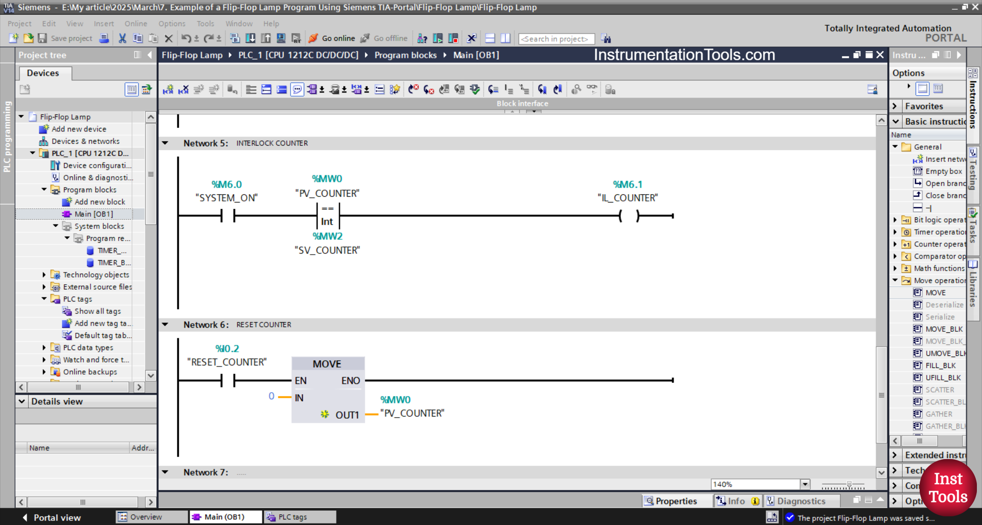

NETWORK 5 (INTERLOCK COUNTER)
Memory bit IL_COUNTER (M6.1) will be in HIGH state if the NO contact of memory bit SYSTEM_ON (M6.0) is in HIGH state and the value of memory word PV_COUNTER (MW0) is Equal To SV_COUNTER (MW2).
NETWORK 6 (RESET COUNTER)
The value in memory word PV_COUNTER (MW0) will be zero “0” when the RESET_COUNTER (I0.2) button is pressed.
MOV instruction moves the value “0” to memory word PV_COUNTER (MW0).
