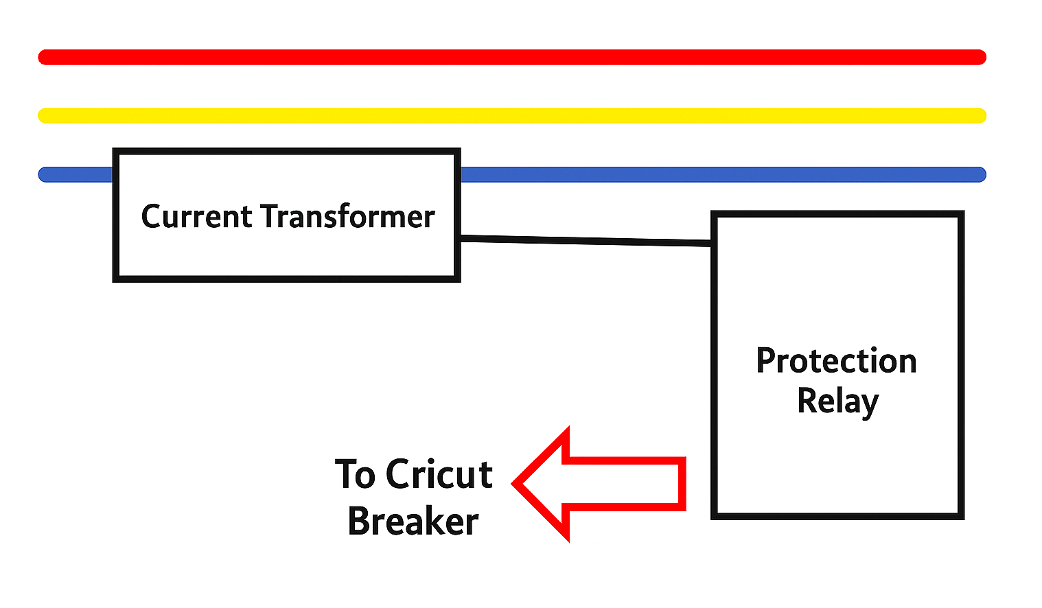

Protection relays are a very important part of electrical systems. They mostly play the role to prevent the circuits from overcurrent. Overcurrent causes a lot of problems due to thermal heating, which damages the components quickly. And as the loads cannot withstand higher current than it’s rating, the internal circuits are damaged over time or even instantaneously. So, protection relays are required in the electrical panel. Apart from overcurrent, protection relays are also categorised to protect from earth fault, abnormal voltage, or issues related to distance which can cause differential issues in transformers or other heavy voltage loads. In overcurrent, the four most used common types of protection relays are 50, 50N, 51, and 51N. In this post, we will understand these types of protection relays.

If we think that overcurrent can occur any time and damage the electrical circuit, then theoretically yes; the relay will be required in all the panels. But practically, it is not the case. They are required in panels where a large amount of current flows normally (typically in combination with circuit breakers), as for smaller amounts of current, a normal breaker will do the job. Circuit breakers have certain limitations when used for higher currents, like not sensing abnormal currents, not setting precise time-current curves, or no directional protection, which occur usually as the current increases. So, protection relays are mostly required in MV (medium voltage) and HV (high voltage panels) where it’s combination with the breaker will prevent overcurrent (because a relay can just detect and give a signal, but cannot trip the circuit, which requires the mechanical action of breaker to do the job).
The most important thing to note is that protection relays are always powered by a current transformer’s secondary winding, which is of a low current value. You cannot directly feed primary incomer current (which is huge) to the relay.

Now, let us see the first type of overcurrent relay – 50. 50 is the ANSI device number, which is denoted for instantaneous overcurrent. This relay has a fixed and a very minute time delay (typically around less than 0.1 seconds) for sensing overcurrent in the circuit. As soon as it is sensed, the relay will trip the breaker or send a signal to some external controller instantaneously. For this reason, a 50 relay is used when the application is very critical and requires an instant trip in the case of overcurrent due to short circuit or any other related reason. This depends when you know that such current spikes are rare and do not occur in the system frequently. In that case, a sudden spike will cause overcurrent and will thus require immediate tripping. A 50 relay is thus designed for phase overcurrent, will be required to be installed separately for each phase, and detects phase-to-phase overcurrent or phase-to-neutral overcurrent.
