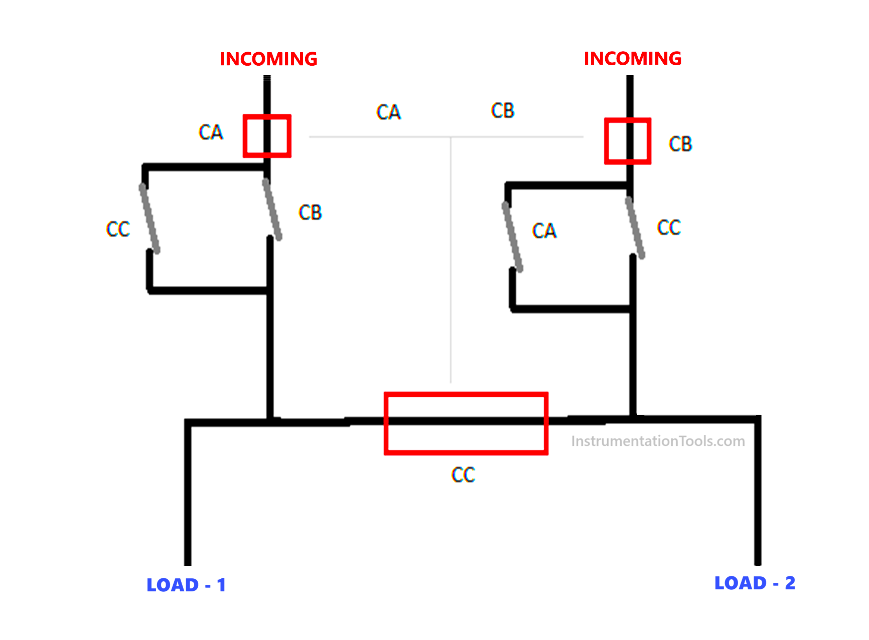

As the name implies, the switchgear electrical circuit is designed through electrical wiring interlocks, which will make or break the circuit path according to the wiring done. For example, refer to the below image for understanding. We saw a general rule earlier that two incomers cannot feed to the same load at the same time. This can be explained better through electrical interlocks.
What are Switchgear Interlocks?
In the above image, the red box is the circuit breaker and the grey lines are the auxiliary NC contacts from the corresponding circuit breaker. The black line is the power line. As you can see, only the following conditions can work due to the wiring done:
  1. CA and CB can work with CC interlocked or not allowed to power, thus passing incoming supply to both the loads separately from both the incomers.
  2. CA and CC can work with CB interlocked or not allowed to power, thus passing incoming supply to both the loads only from CA incomer.
  3. CB and CC can work with CA interlocked or not allowed to power, thus passing incoming supply to both the loads only from CB incomer.
Due to this interlocking, open command will always remain with the third circuit breaker, and it will not allow two incomers to merge with each other. So, electrical interlocking concerns placing the correct auxiliary contacts in the path of power supply, for a safe and desired operation.
