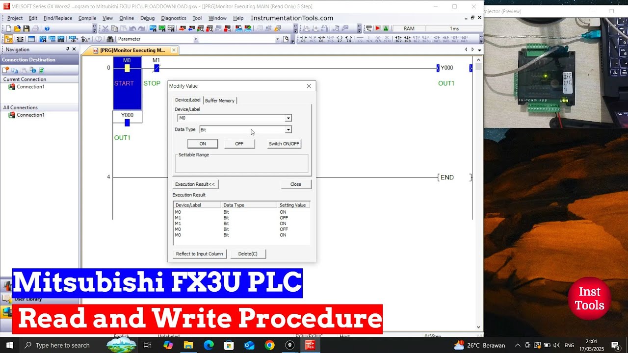

In the video below, we have shown you how to do PLC program read and write with real hardware.
Mitsubishi FX3U PLC Program Read and Write Procedure

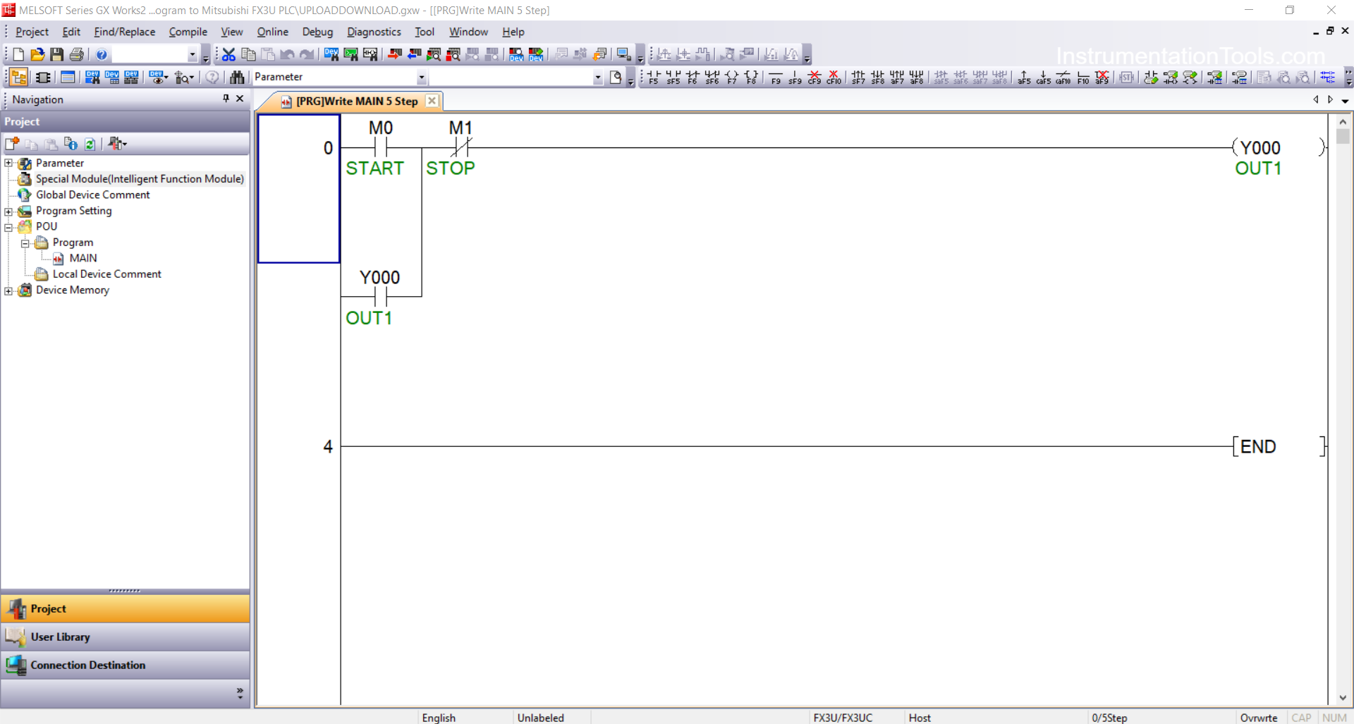

1. Open the project you want to write.
Mitsubishi FX3U PLC program upload

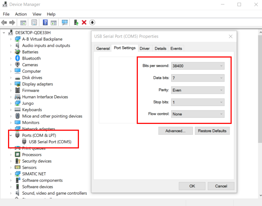

2. Ensure the PLC connection is active by checking the connected port in the Device Manager.
In the image below, the USB to Serial RS-232 cable is connected to Port “5” with the following settings: Bit Per Second “38.4 Kbps”, Data Bits “7”, Parity “Even”, and Stop Bits “1”.

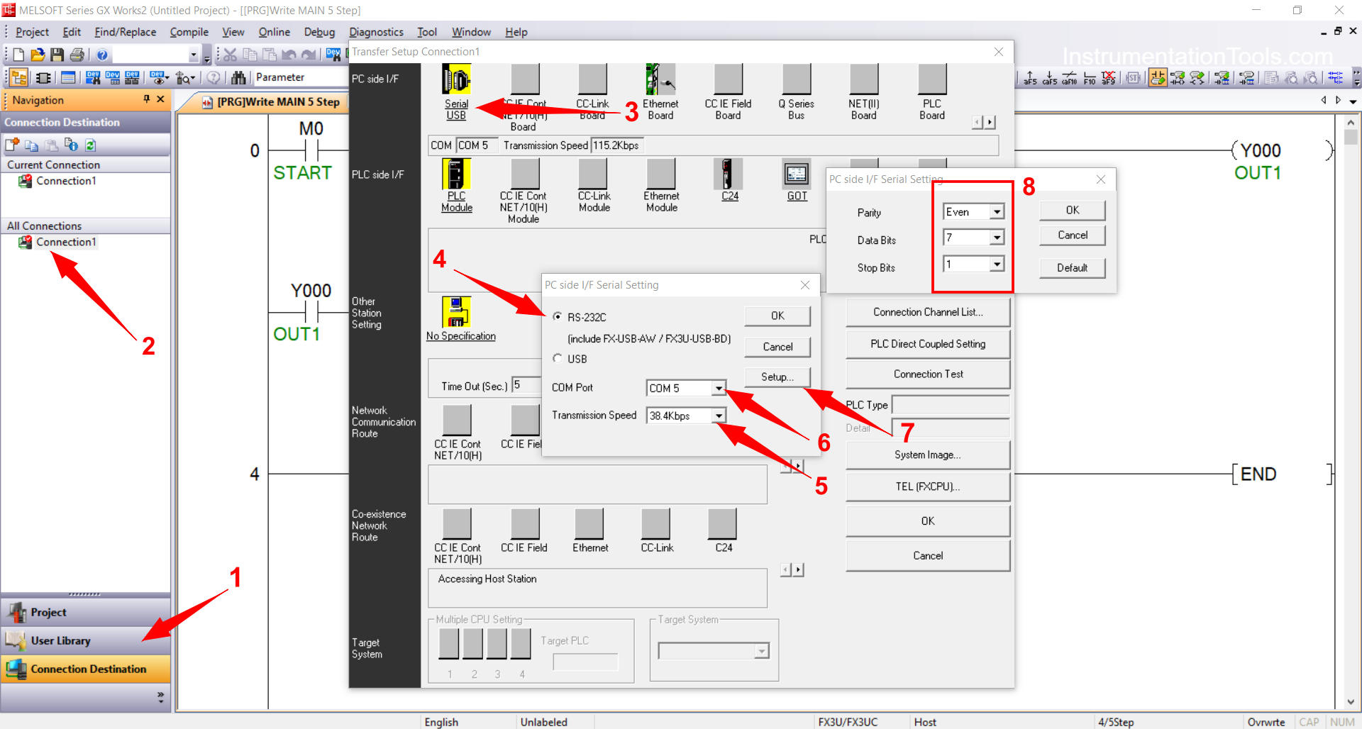

3. Match the PLC communication settings in GX Works2 software with the settings from the Device Manager:
  • Connection Detection → Connection1 → Serial USB → RS-232C → COM Port “5”
  • Transmission Speed: “38.4 Kbps”
  • Setup → Parity: “Even” → Data Bits: “7” → Stop Bits: “1”

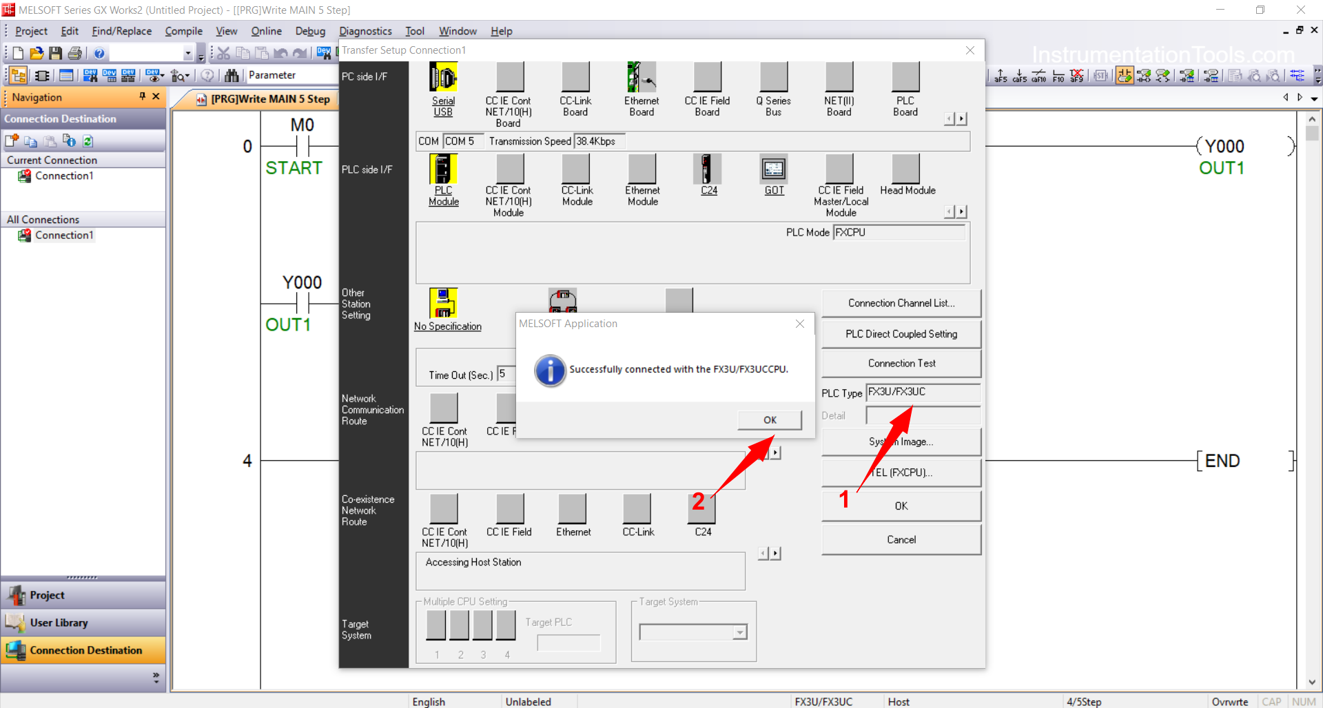

4. Click “Connection Test” to verify that the PC is connected to the PLC. If a pop-up window appears saying “Successfully Connected with the FX3U/FX3UCCPU”, it means the connection is established.

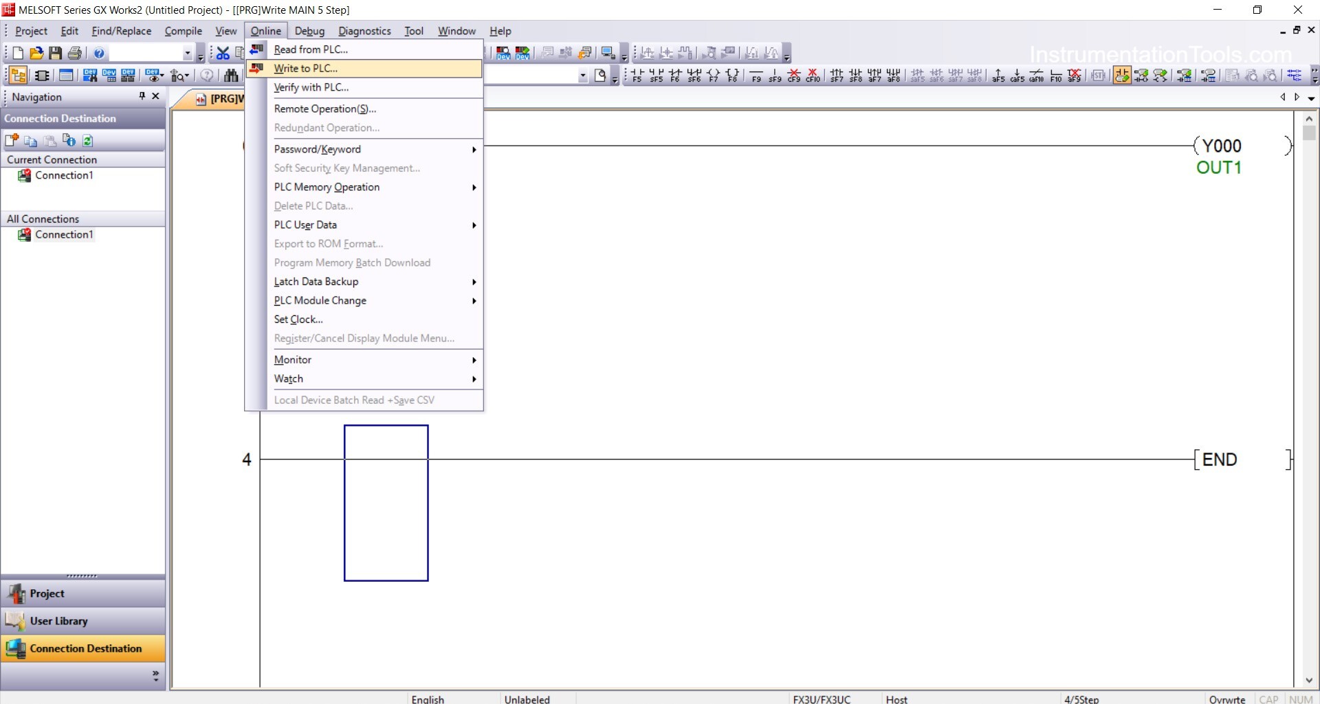

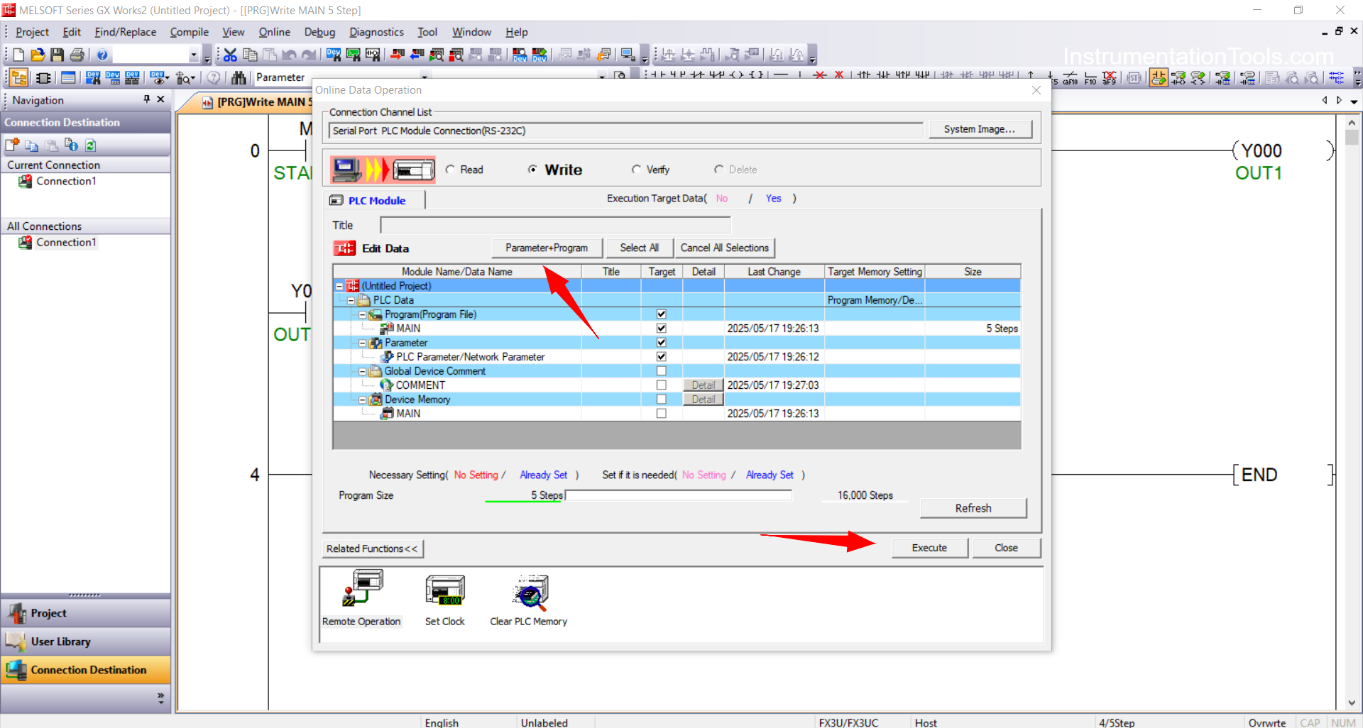

5. Click “Online” → “Write to PLC”.
Write to PLC

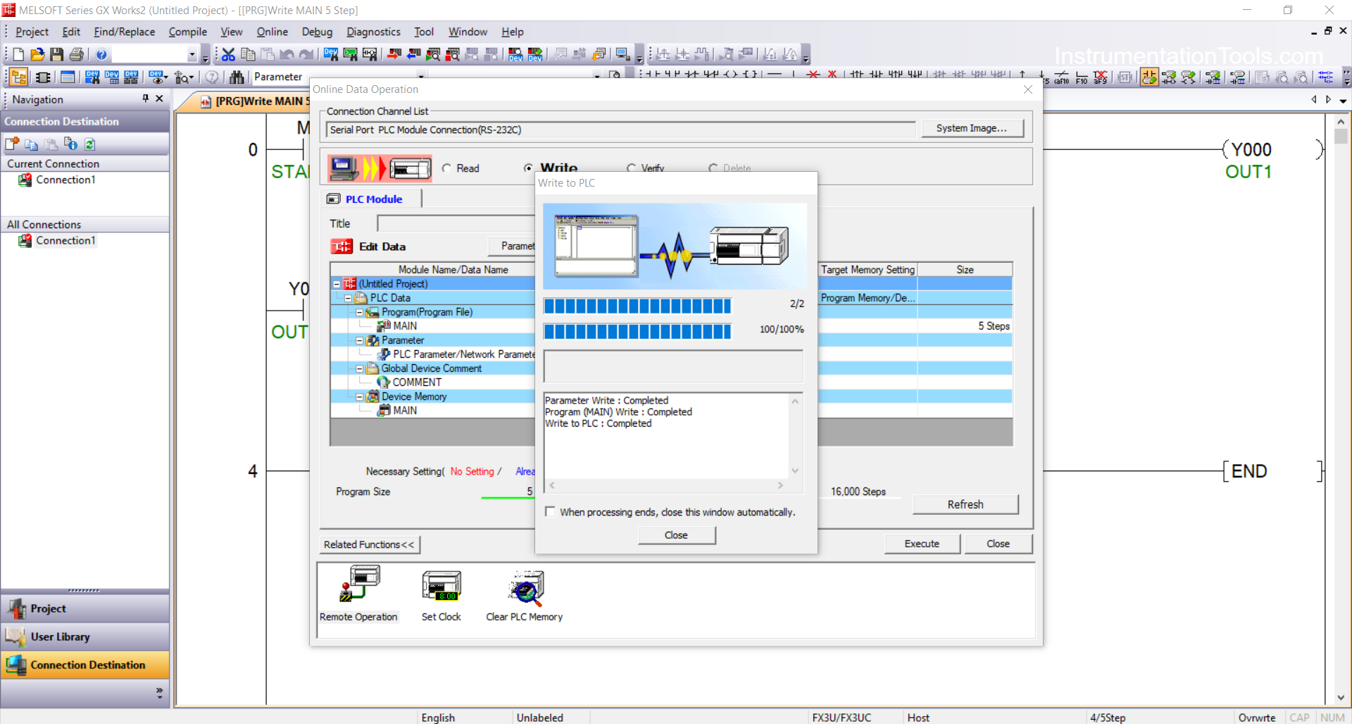

6. Select the parts of the program you want to transfer to the PLC (e.g., Program, Parameters, etc.), then click “Execute”.
Program transfer to the PLC
7. If a pop-up window appears as shown below, it indicates the Write process was successful.

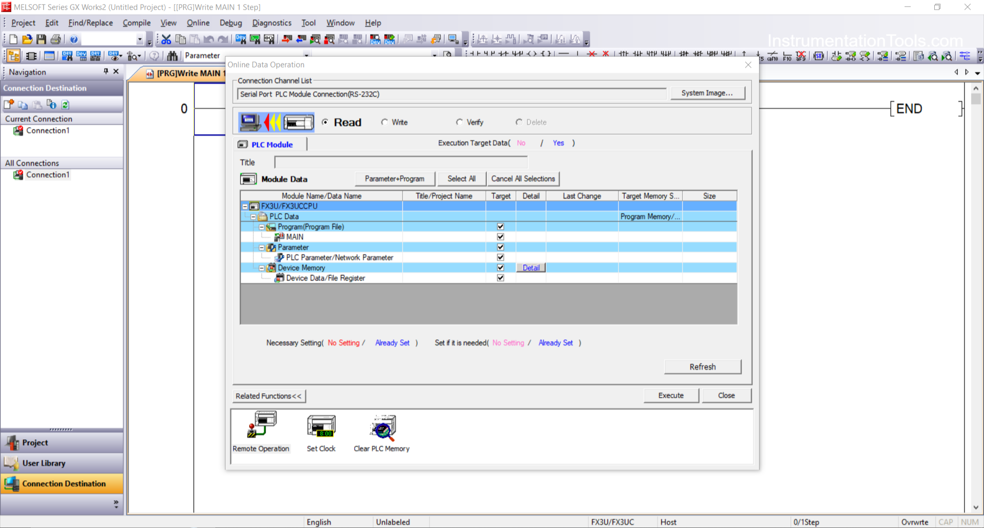

Read PLC Program

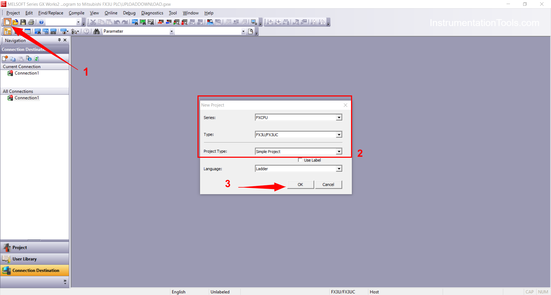

1. Open GX Works2.
2. Click “Project” → “New” to create a new project. Choose the appropriate PLC type (FX, Q, L) and CPU version. Click “OK”.
GX Developer upload download

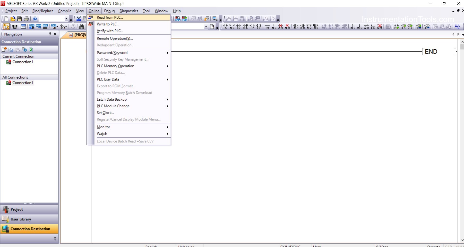

3. Once the project is created, click “Online” → “Read from PLC”.
Read from PLC
4. Select the sections you want to read (usually: Program, Parameters, Device Memory, etc.), then click “Execute”.
program will be read from the PLC to the PC
5. The program will be read from the PLC to the PC.
6. Save the project by clicking “File” → “Save As”.
