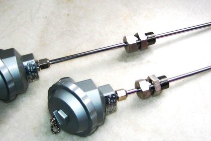

HOW TO DETERMINE THE MEASURING JUNCTION TEMPERATURE
- Measure the “VD” millivoltage as shown above.
- Measure the actual temperature of the reference junction with a thermometer.
- Go to the table for the thermocouple being used and look up the millivoltage produced at that temperature.
- Add that millivoltage to the millivoltage measured as “VD” to get a total.
- Find that millivoltage total in the reference table. The corresponding temperature is the temperature of the measuring junction.
Example #1 Type “T” Thermocouple
Measured “VD” = 3.41 mV
Reference Junction Temperature = 22°C (71.6°F)
- From the table; 22°C = 0.87 mV.
- Adding 0.87 mV to 3.41 mV = 4.28 mV.
- Finding 4.28 mV In the table; the corresponding temperature is 100°C (212°F) and is the temperature of the measuring junction.
Example #2 Type “T” Thermocouple
Measured “VD” = 4.47 mV
Reference Junction Temperature = -5°C (23°F) (lower than the table reference of 0°C)
- From the table; 5°C = -0.193 mV
- Adding -0.193 mV to +4.47 mV = +4.28 mV
