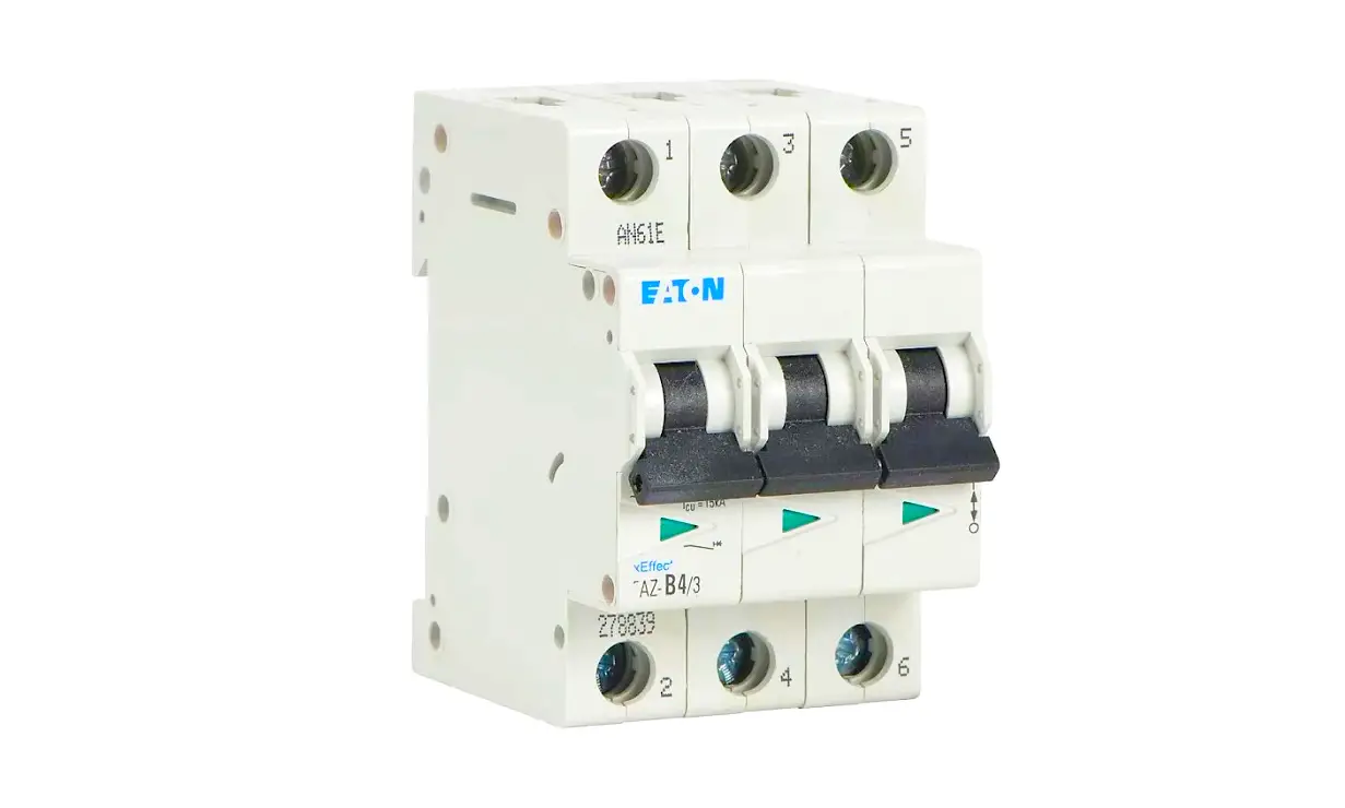

What is a UL 1077 circuit breaker?
UL 1077 Miniature circuit breaker
A UL 1077 circuit breaker is used as a secondary component in electrical circuits for protection.
This means, that once you have taken power from a source and then fed a small rated load, that level will have a UL 1077 circuit breaker. It thus ensures that your incoming supply from a further UL 489 circuit breaker to then single phase supplies and step-down transformers will not hamper any further small electrical load inside.
Due to this, its usage is less frequent, as it depends on the usage of load in the diagram. As they deal in less incoming power, they do not undergo a stringent test before releasing them in the market for use. That is why, these circuit breakers are also termed as sub-branch breakers, as they control the power supplied to a branch load.
So, almost all the control panels that have electronic loads like PLC, SMPS, relays, instruments, communication modules, or contactors for small-rated motors will have these circuit breakers before passing the supply to these loads mentioned. That is why, they are usually lower in current ratings.
