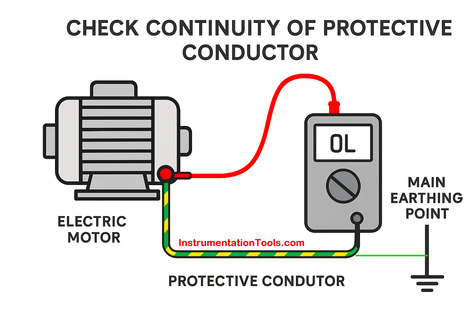

Now, let us come to the main topic. First of all, to check our thing, you will require two main settings in a multimeter – continuity and resistance.
Let us consider the scenario like this – there is an electrical panel which has the following components: of motor cabinet and an earth bar. The motor cabinet has an earthing point, which allows the earthing wire to be connected. We will connect one end of the wire to the motor cabinet point, and the other end to the earth bar. We will assume that we have already checked the continuity between the earth bar and the main plant earthing pit. So, any wire connected to the earth bar automatically ensures that your earthing point has been safely grounded to the main ground pit of your factory.
First of all, you need to power off the whole panel. Now, you need to connect one end of the multimeter to the motor cabinet earthing point and the other end to the earth bar. Set the multimeter setting to continuity. If there is a beep sound, that means the wire has been properly connected to both joints. Now, set the multimeter setting to resistance. The value should be less than 1 ohm. This will ensure that a low-resistance path will be provided to any leakage current happening in the motor equipment, thus allowing for safe passage of that leakage current to ground. Out of the two criteria of continuity or resistance, if any one fails, then the continuity of a productive conductor overall has failed. Refer to the image below for more details.
How to Check the Continuity of Protective Conductors
As the distance between two points increases, a slight increase in resistance will be expected. For example, 0.3 ohms can become 0.4 ohms. But the maximum tolerable resistance must always be less than 1 ohms, and should not increase beyond that point.
Practically speaking, the distance between the main earth pit and any earthing point on a panel or point is large and usually more than 5 meters. A multimeter probe is usually 1-2 meters. So, you have to use long wires with alligator clips to make a long and continuous probe connection. You can even use a loop impedance tester, which can check continuity for earth connections. But be it anything, be sure to do all your testing in a power-disconnected state, for safety purposes and also, best results. So, due to the sensitivity of the earth wire conductor or protective conductor, its continuity and resistance checking play a very important role in electrical systems.
