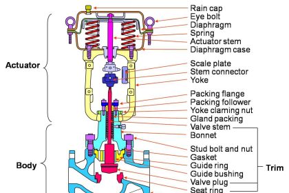

Pneumatic:
Pneumatic actuators utilize an air signal from an external control device to create a control action via a solenoid. These are commonly available in two main forms: piston actuators and diaphragm actuators.
  • Piston actuators  –  Piston  actuators  are  generally  used  where  the  stroke  of  a diaphragm actuator would be too short or the thrust is too small. The compressed air is applied to a solid piston contained within a solid cylinder. Piston actuators can be single acting or double acting, can withstand  higher input pressures,  and can offer smaller cylinder volumes which can act at high speed.
  • Diaphragm actuators – Diaphragm actuators have compressed air applied to a flexible membrane called the diaphragm. These types of actuators are single acting, in that air is only supplied to one side of the diaphragm, and they can be either direct acting (spring-to-retract) or reverse acting (spring-to-extend).
Their range of applications  is enormous. For example, the smallest can deliver a few inch- pounds  of torque where the largest  are capable  of producing  in excess  of a million inch- pounds of torque.
