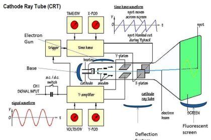

It has been mentioned earlier that the time domain oscilloscopes require a sweep generator that is linear with time for the x-axis display. The motion of spot on the screen from extreme left to extreme right is called sweep.
The generator which generates a waveform which is responsible for the movement of spot on screen horizontally is called time base generator or sweep generator. The sweep circuit along with the display gating functions is called time bases.
The linear sweep moves the spot from left to right while the movement of spot from right to left is not visible. This portion of waveform generated by time base is called flyback or retrace. During this time, the cathode ray tube is blanked.
The time base generator also controls the rate at which the spot moves, across the screen. This rate is to be adjusted from front panel control.
Why sweep generator is called time base generator?
All the time dependent waveforms need x-axis to be calibrated as time axis. The sweep generator produces the movement of spot on screen such that it acts as a time axis or time base for the waveforms to be displayed. Hence the sweep generator is also called time base generator.
The two front panel controls which are used to control rate and duration of time base waveform are time/division and time variable control.
Note: the trigger circuit ensures that the horizontal sweep starts at the same point of the vertical input signal.
