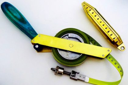

Surface Detector Level Gauges (Plumb-bob)
