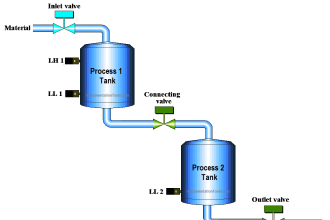

Example 1 A simple analogy of a control system
In the process example shown (Figure 1), the operator manually varies the flow of water by opening or closing an inlet valve to ensure that:
- The water level is not too high; or it will run to waste via the overflow.
- The water level is not too low; or it will not cover the bottom of the tank.
The outcome of this is that the water runs out of the tank at a rate within a required range. If the water runs out at too high or too low a rate, the process it is feeding cannot operate properly.
At an initial stage, the outlet valve in the discharge pipe is fixed at a certain position.
The operator has marked three lines on the side of the tank to enable him to manipulate the water supply via the inlet valve. The 3 levels represent:
- The lowest allowable water level to ensure the bottom of the tank is covered.
- The highest allowable water level to ensure there is no discharge through the overflow.
- The ideal level between 1 and 2.
The Example (Figure 1) demonstrates that:
- The operator is aiming to maintain the water in the vessel between levels 1 and 2. The water level is called the Controlled condition.
- The controlled condition is achieved by controlling the flow of water through the valve in the inlet pipe. The flow is known as the Manipulated Variable, and the valve is referred to as the Controlled Device.
- The water itself is known as the Control Agent.
- By controlling the flow of water into the tank, the level of water in the tank is altered. The change in water level is known as the Controlled Variable.
- Once the water is in the tank it is known as the Controlled Medium.
- The level of water trying to be maintained on the visual indicator is known as the Set Value (also known as the Set Point).
- The water level can be maintained at any point between 1 and 2 on the visual indicator and still meet the control parameters such that the bottom of the tank is covered and there is no overflow. Any value within this range is known as the Desired Value.
- Assume the level is strictly maintained at any point between 1 and 2. This is the water level at steady state conditions, referred to as the Control Value or Actual Value.Note: With reference to (7) and (8) above, the ideal level of water to be maintained was at point 3. But if the actual level is at any point between 1 and 2, then that is still satisfactory. The difference between the Set Point and the Actual Value is known as Deviation.
- If the inlet valve is closed to a new position, the water level will drop and the deviation will change. A sustained deviation is known as Offset.

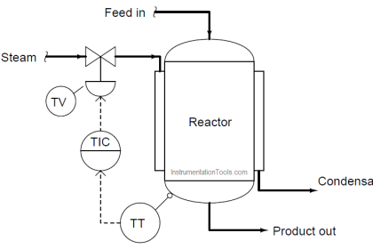

Elements of a temperature control system
Example 1 depicted a simple manual level control system. This can be compared with a simple temperature control example as shown in Example 3 (manually controlled) and Figure 3. All the previous factors and definitions apply.
Example 3 Depicting a simple manual temperature control system
The task is to admit sufficient steam (the heating medium) to heat the incoming water from a temperature of T 1; ensuring that hot water leaves the tank at a required temperature of T 2.

Automatic control
A controlled condition might be temperature, pressure, humidity, level, or flow. This means that the measuring element could be a temperature sensor, a pressure transducer or transmitter, a level detector, a humidity sensor or a flow sensor.
The manipulated variable could be steam, water, air, electricity, oil or gas, whilst the controlled device could be a valve, damper, pump or fan.
For the purposes of demonstrating the basic principles, this Tutorial will concentrate on valves as the controlled device and temperature as the controlled condition, with temperature sensors as the measuring element.
Components of an automatic control

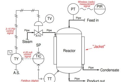

Figure 4 illustrates the component parts of a basic control system. The sensor signals to the controller. The controller, which may take signals from more than one sensor, determines whether a change is required in the manipulated variable, based on these signal(s). It then commands the actuator to move the valve to a different position; more open or more closed depending on the requirement.
Controllers are generally classified by the sources of energy that power them, electrical, pneumatic, hydraulic or mechanical.
An actuator can be thought of as a motor. Actuators are also classified by the sources of energy that power them, in the same way as controllers.
