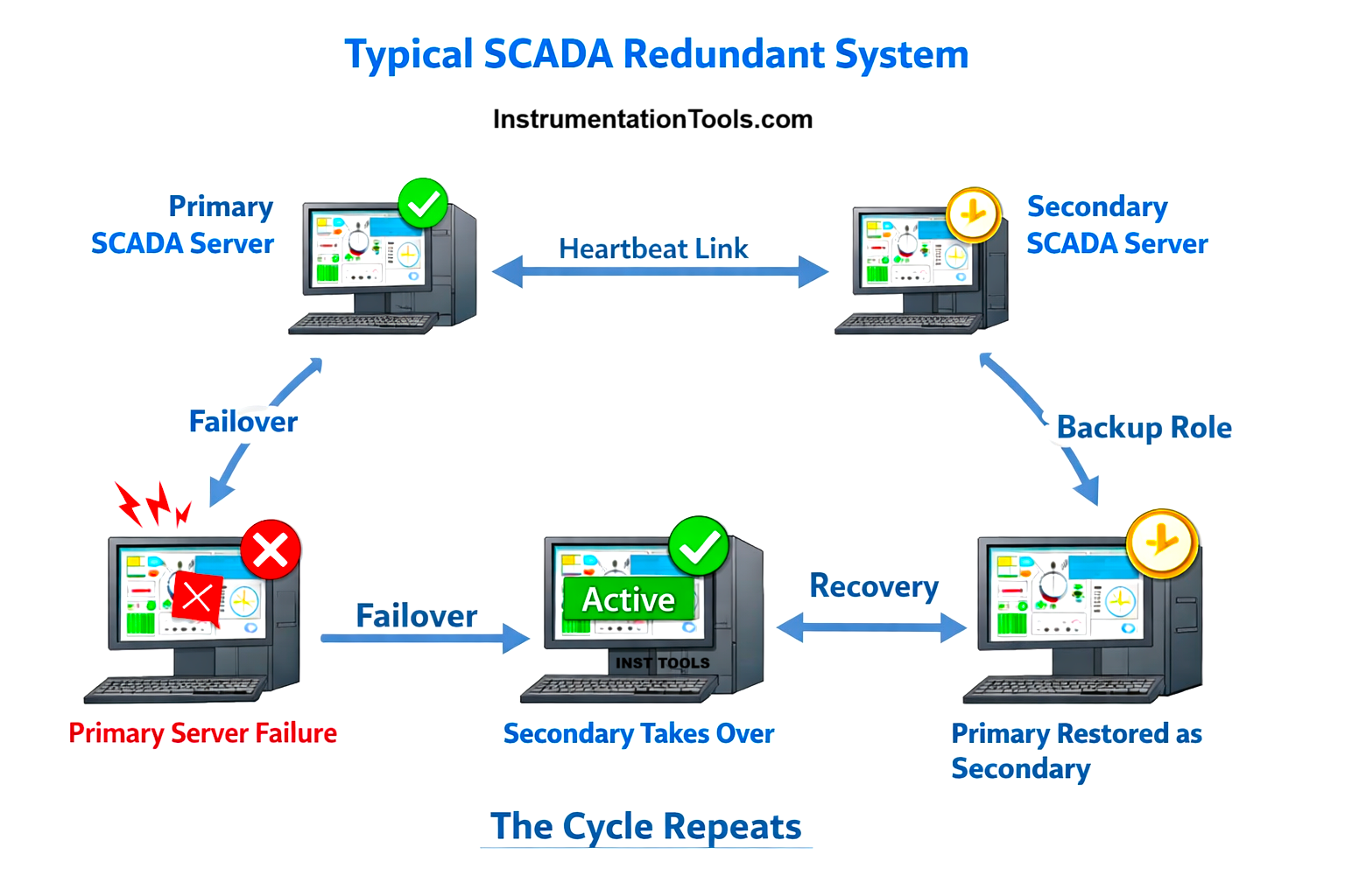

What is the basic architecture of SCADA redundancy?
Refer to the image below. As you can see, any typical SCADA redundant system will look like this. Two servers will talk to each other, with one primary and the other as secondary. If the primary SCADA PC fails for any reason, the secondary PC will immediately take over and become the primary PC. When that failed primary PC has again been restored, then it will now become secondary and support the new primary PC as a backup. In this way, the cycle repeats. But this is a very upper idea and not a deep concept.
To understand how basic architectural redundancy works, first let us understand the architecture itself. The two PCs are having the communication drivers configured individually for the same PLC. So, the secondary PC is directly communicating with the PLC and working live in the plant. It does not directly collect data from the primary PC. Till this part, everything is clear. Let’s now understand the concept more properly with each topic.
