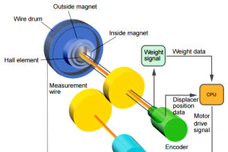

Explain the working of an enraf level gauge.
Enraf level gauge is based on the servo powered null balance technique.
A displacer serves as continuous level sensing element. A two phase motor controlled by a capacitive balance system winds unwinds the the measuring wire until the tension in the weight springs is in balance with the weight of the displaced part immersed in the liquid.
The sensing system in balance measures the two capacitance formed by the moving central sensing rod provided by the two capacitor plates and the si plates.
