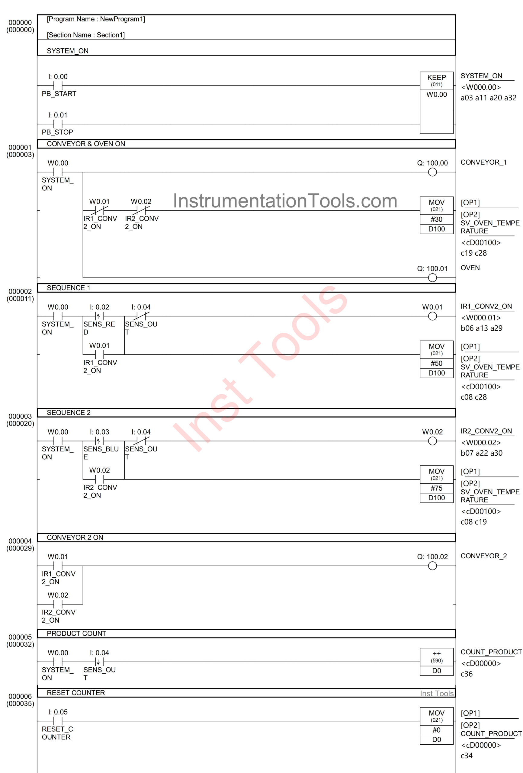

Explanation of PLC Logic

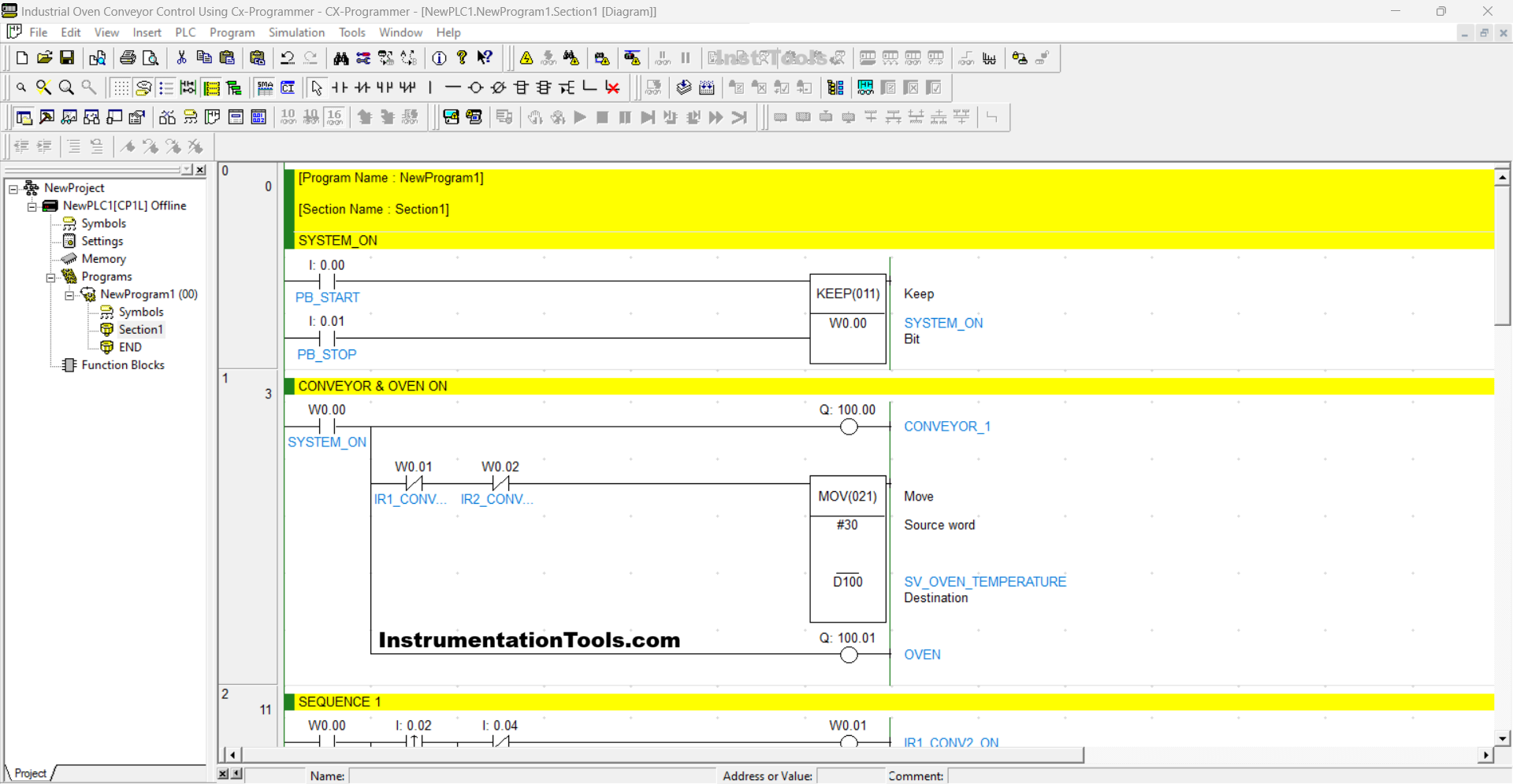

RUNG 0 (SYSTEM_ON)
In this Rung, when the PB_START (0.00) button is pressed, the memory bit SYSTEM_ON (W0.00) will be in the HIGH state. Because it uses the KEEP(011) instruction, the memory bit SYSTEM_ON (W0.00) will remain in the HIGH state even though the PB_START (0.00) button has been released.
The memory bit SYSTEM_ON (W0.00) will be in the LOW state if the PB_STOP (0.01) button is pressed.
RUNG 1 (CONVEYOR & OVEN ON)
In this Rung, when the NO contact of memory bit SYSTEM_ON (W0.00) is in the HIGH state, the CONVEYOR_1 (100.00) and OVEN (100.01) outputs will be ON. The MOV instruction will move the value “30” to the memory word SV_OVEN_TEMPERATURE (D100).
If the NC contacts of memory bits IR1_CONV2_ON (W0.01) and IR2_CONV2_ON (W0.02) are in the HIGH state, then the MOV instruction will stop and move the value “30” to the memory word SV_OVEN_TEMPERATURE (D100).

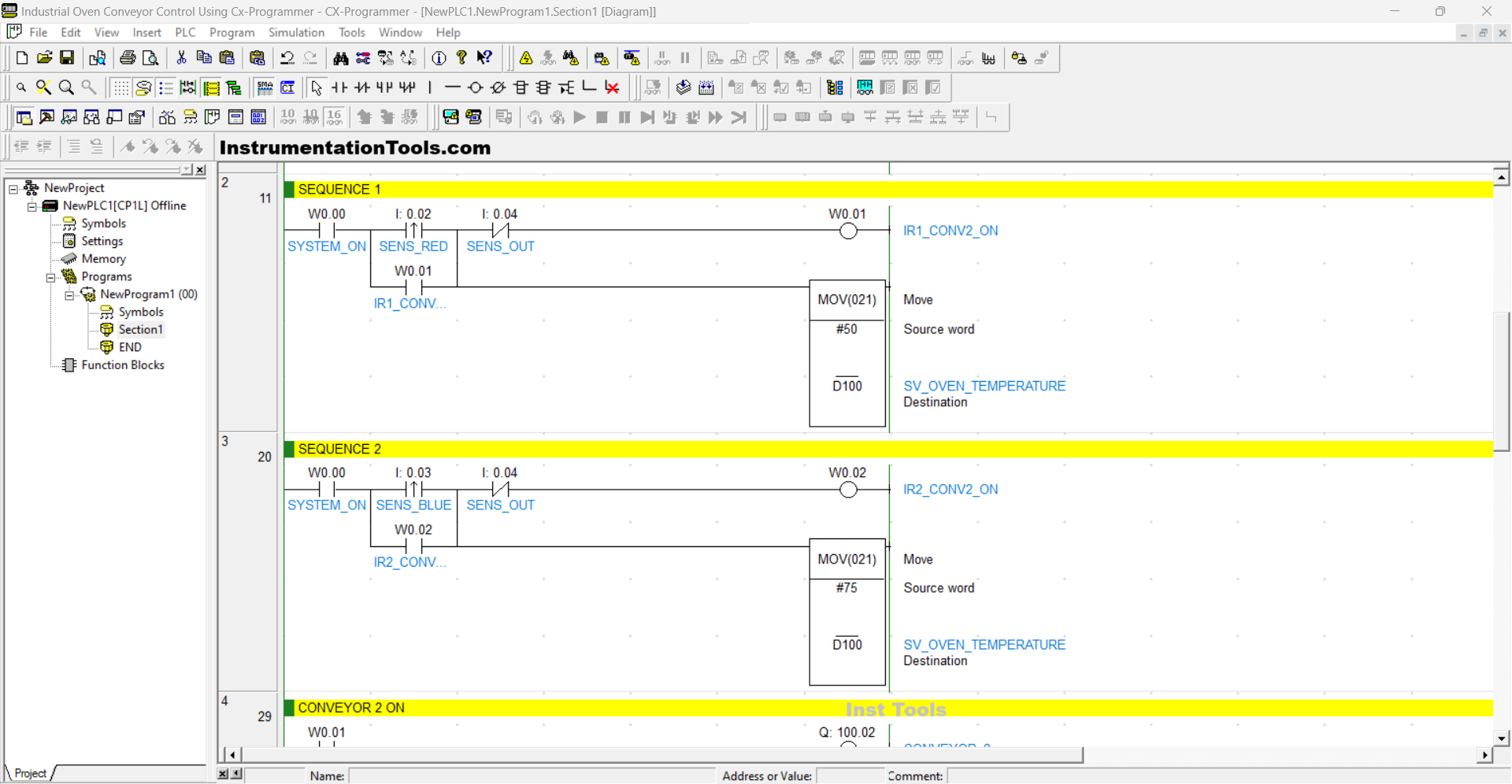

RUNG 2 (SEQUENCE 1)
In this Rung, when the NO contact of memory bits SYSTEM_ON (W0.00) and Sensor SENS_RED (0.02) are in the HIGH state, then the memory bit IR1_CONV2_ON (W0.01) will be in the HIGH state and the MOV Instruction will move the value “50” to memory word SV_OVEN_TEMPERATURE (D100).
Because it uses Latching, the memory bit IR1_CONV2_ON (W0.01) will remain in the HIGH state even though the SENS_RED (0.02) Sensor is in the LOW state.
RUNG 3 (SEQUENCE 2)
In this Rung, when the NO contact of memory bits SYSTEM_ON (W0.00) and SENS_BLUE (0.03) are in the HIGH state, then the memory bit IR2_CONV2_ON (W0.02) will be in the HIGH state and the MOV Instruction will move the value “75” to memory word SV_OVEN_TEMPERATURE (D100).
Because it uses Latching, the memory bit IR2_CONV2_ON (W0.02) will remain in the HIGH state even though the SENS_BLUE (0.03) Sensor is in the LOW state.

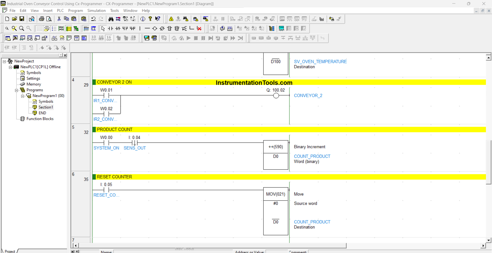

RUNG 4 (CONVEYOR 2 ON)
In this Rung, Output CONVEYOR_2 (100.02) will be ON if the NO contact of memory bit IR1_CONV2_ON (W0.01) or IR2_CONV2_ON (W0.02) is in the HIGH state.
RUNG 5 (PRODUCT COUNT)
In this Rung, when the NO contact of memory bit SYSTEM_ON (W0.00) and SENS_OUT (0.04) Sensor is in the HIGH state, the value in the memory word COUNT_PRODUCT (D0) will increase (+1).
RUNG 6 (RESET COUNTER)
In this Rung, when the RESET_COUNTER (0.05) button is Pressed, the MOV instruction will move the value “0” to the memory word COUNT_PRODUCT (D0).
