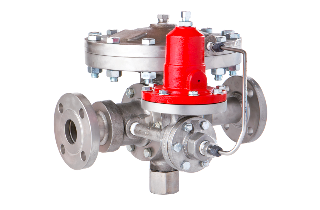

A Pilot Operated Back Pressure Regulator Valve is used in piping systems to maintain a steady upstream pressure by opening only when the pressure rises beyond a certain limit. To make sure the valve works correctly, we need to test it. This test helps us confirm whether the valve opens at the right pressure.
Set Pressure Test – Pilot Valve OnlyComplete Assembly (Pilot + Main Valve)
There are two ways to do this:
  • Testing only the pilot valve
  • Testing the complete assembly (both the pilot valve and main valve together)
Let’s look at both test procedures one by one in simple terms.
This test checks whether the pilot valve opens at the correct pressure.
Steps:
Mount the pilot valve on a test bench as shown in the setup diagram.
Find the set pressure value from the valve datasheet.
Slowly increase the supply pressure (air or water) by adjusting the needle valve.
Watch the main valve diaphragm port. If the pilot valve is working, you’ll see a sudden increase in pressure at this port.
If this happens exactly at the set pressure (as per the datasheet), the test is successful.
If not, reduce the pressure to zero and adjust the spring screw as per the manufacturer’s instructions.
Repeat the test until the pilot valve operates at the correct pressure.
Sample Picture
This test checks how the entire valve assembly behaves together.
Steps:
Set up the complete valve assembly on the test bench (pilot + main valve).
Get the set pressure from the datasheet.
Gradually increase the inlet pressure using a needle valve.
Keep an eye on the valve. Note the pressure at which the main valve starts to open.
If it opens at the correct set pressure, the valve is working fine.
If not, go back and re-test the pilot valve (as explained earlier), because the pilot valve may be causing the issue.
