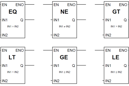

RUNG 0002
Greater than or equal and Less than or equal block is connected in series with Q1 (O:0/0),When accumulator value between 0 to 5  triggers Q1 turns ON.
RUNG 0003
Greater than or equal and Less than or equal block is connected in series with Q2 (O:0/1),When accumulator value between 6 to 10  triggers Q2 turns ON.
Rung 0004
Greater than or equal and Less than or equal block is connected in series with Q3 (O:0/2),When accumulator value between 11 to 15  triggers Q3 turns ON.
Rung 0005
Greater than or equal and Less than or equal block is connected in series with Q4 (O:0/3),When accumulator value between 16 to 20  triggers Q4 turns ON.
Rung 0006
When T4:0 accumulator value reaches 20,outputs Q5.Q6,Q7 & Q8 turns ON along with timer T4:1 which presets for 20 second. Limit block is used turn OFF each output in respective sequence.
Each Limit block check with T4:1’s accumulator value, when it’s not in the limit its triggers the output to turn OFF.
