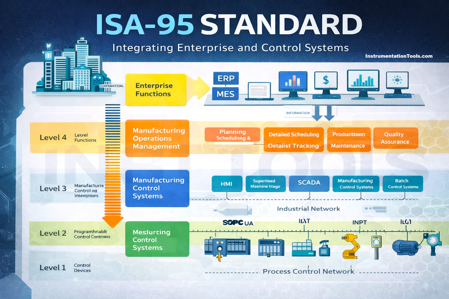

ISA-95 (IEC 62264) is a globally accepted standard that provides a structured framework for integrating business-level systems (ERP) with manufacturing and automation systems (MES, PLC, SCADA). Instead of focusing on control logic, it standardises terminology, models, and information flow to ensure smooth coordination between production planning and shop-floor execution. By clearly defining system boundaries and data exchange responsibilities, ISA-95 minimises custom integrations, improves consistency across platforms, and supports better production tracking, traceability, and operational efficiency in modern manufacturing environments. In this post, we will discuss the concept of ISA-95.
What is the ISA-95 standard?
ISA-95 is an international standard used to integrate business systems with manufacturing systems in an industrial environment. Its main goal is to create a clear and consistent link between ERP systems, which focus on planning and business operations, and MES and automation systems, which execute and monitor production on the shop floor. Rather than dealing with machine control or PLC programming, ISA-95 defines common terminology, models, and system boundaries. This ensures that all systems interpret data such as orders, materials, equipment, and production results in the same way.
By standardising information exchange, ISA-95 reduces integration complexity, avoids data mismatch, and improves visibility of manufacturing operations. It helps organisations keep production planning and actual execution aligned, especially in large, multi-line or multi-site manufacturing environments. In simple terms, ISA-95 provides a common language and structure to connect ERP, MES and PLC/SCADA. It does not define control logic, but defines who talks to whom, what data is exchanged, and at which level.

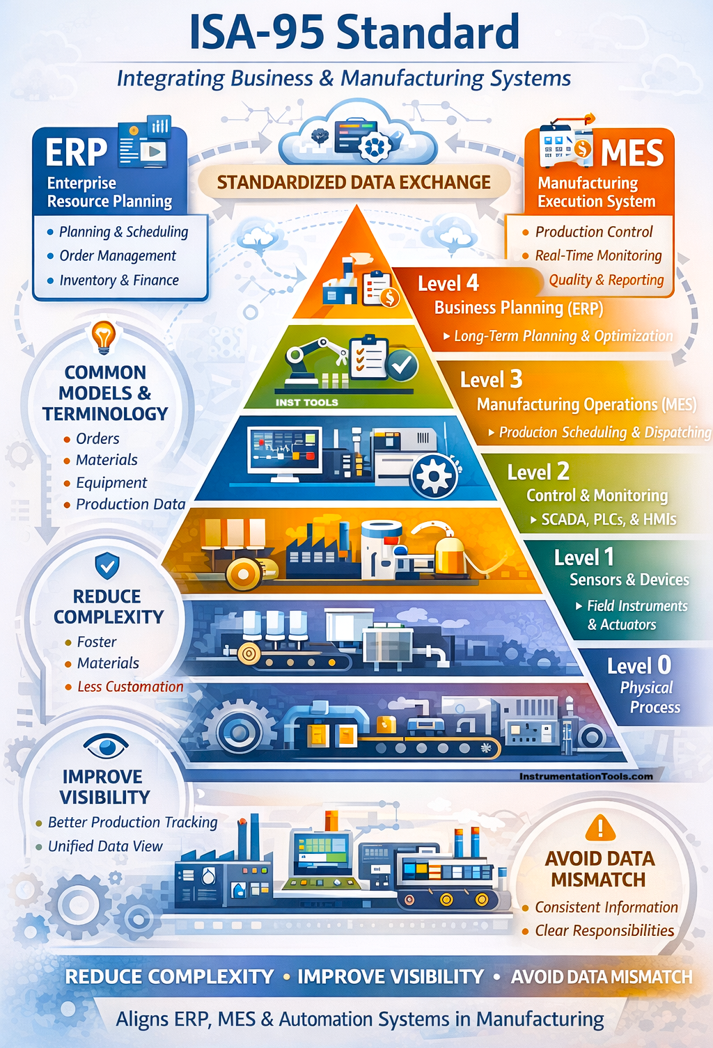

ISA-95 automation pyramid structure
The ISA-95 automation pyramid shows how a manufacturing system is structured from the shop-floor process up to business management systems. It helps explain which activities belong at which level and prevents mixing of responsibilities between control, operations, and business planning.
Level 0 – Process Execution
This level represents the actual physical process taking place in the plant. It includes actions such as heating, cooling, mixing, filling, cutting, pumping, or chemical reactions. No automation logic exists here; only the real process where raw materials are transformed into finished products.
Level 1 – Field Devices
Level 1 consists of devices that measure and act on the process. Sensors like temperature, pressure, and flow transmitters collect process data, while actuators such as valves, motors, and drives physically control the process. This level acts as the interface between the real process and the control system.
Level 2 – Control and Monitoring
At Level 2, control systems operate the plant in real time. This includes PLCs, DCS controllers, SCADA, and HMIs. Control logic, sequencing, alarms, interlocks, and operator commands are handled here. The primary focus is to keep the process running safely, efficiently, and within defined limits.
Level 3 – Manufacturing Operations Management (MES)
Level 3 manages how production is executed, rather than how machines are controlled. MES systems operate at this level, handling tasks such as scheduling production orders, tracking materials and batches, monitoring quality checks, coordinating maintenance activities, and calculating performance indicators like OEE. This layer connects business plans with actual shop-floor execution.
Operational areas at Level 3 include:
- Production management
- Quality management
- Maintenance management
- Inventory and material management
Level 4 – Business Planning Systems (ERP)
Level 4 focuses on enterprise-level planning and decision-making. ERP systems at this level manage customer orders, supply chain planning, procurement, inventory valuation, costing, and financial reporting. This layer sets production targets but does not interact directly with machines or control systems.
