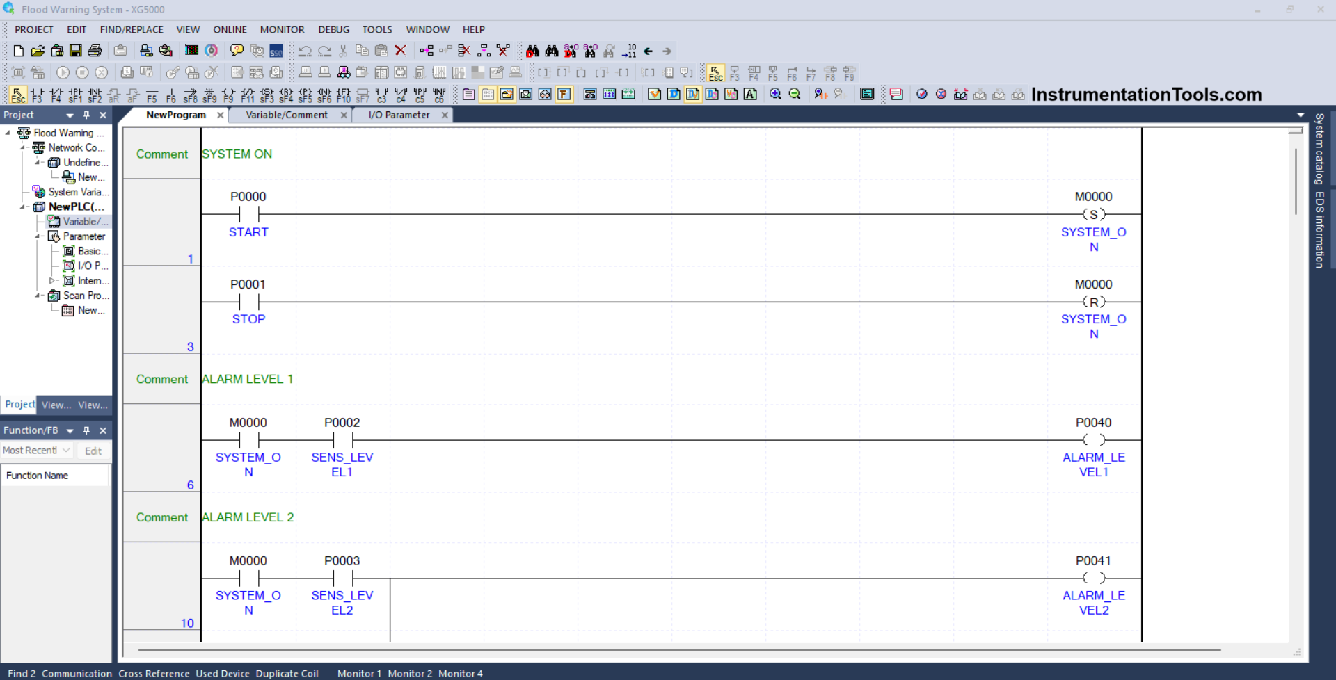

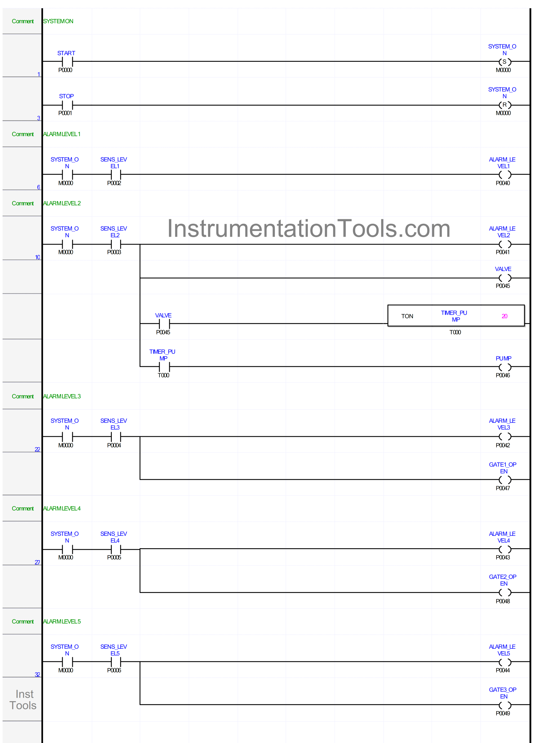

RUNG 1 (SYSTEM ON)
In this Rung, the memory bit SYSTEM_ON (M0000) will be in the HIGH state if the button START (P0000) Pressed. The memory bit SYSTEM_ON (M0000) will remain in the HIGH state even though the button START (P0000) has been Released, because it uses the SET Coil Instruction.
RUNG 3
In this Rung, if the button STOP (P0001) is Pressed, the memory bit SYSTEM_ON (M0000) will be in the LOW state. Because it uses the RESET Coil Instruction.
RUNG 6 (ALARM LEVEL 1)
In this Rung, the output ALARM_LEVEL1 (P0040) will be ON if the NO contact of the memory bit SYSTEM_ON (M0000) and the sensor SENS_LEVEL1 (P0002) are in the HIGH state.

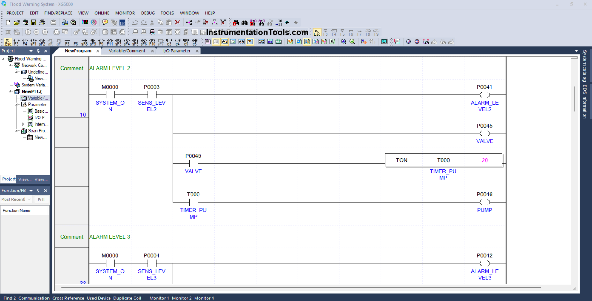

RUNG 10 (ALARM LEVEL 2)
In this Rung, the output ALARM_LEVEL2 (P0041) will be ON and the output VALVE (P0045) will be OPEN, when the NO contact of the memory bit SYSTEM_ON (M0000) and the sensor SENS_LEVEL2 (P0003) are in the HIGH state.
And when the NO contact of the VALVE (P0045) is in the HIGH state, the timer TIMER_PUMP (T0000) will Start counting up to 2 seconds. The output PUMP (P0046) will be ON after the TIMER_PUMP (T0000) Timer has finished counting.

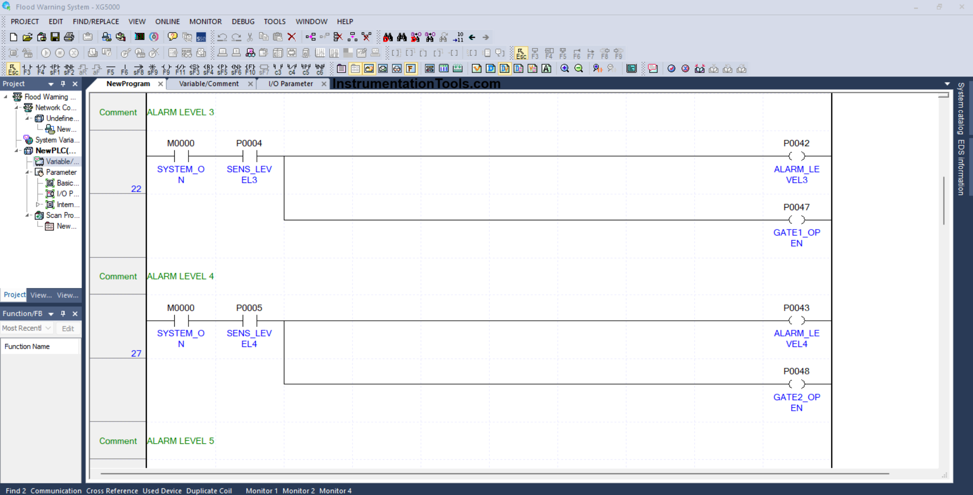

RUNG 22 (ALARM LEVEL 3)
In this Rung, the output ALARM_LEVEL3 (P0004) will be ON and the output GATE1_OPEN (P0047) will be OPEN if the NO contact of the memory bit SYSTEM_ON (M0000) and the sensor SENS_LEVEL3 (P0004) are in the HIGH state.

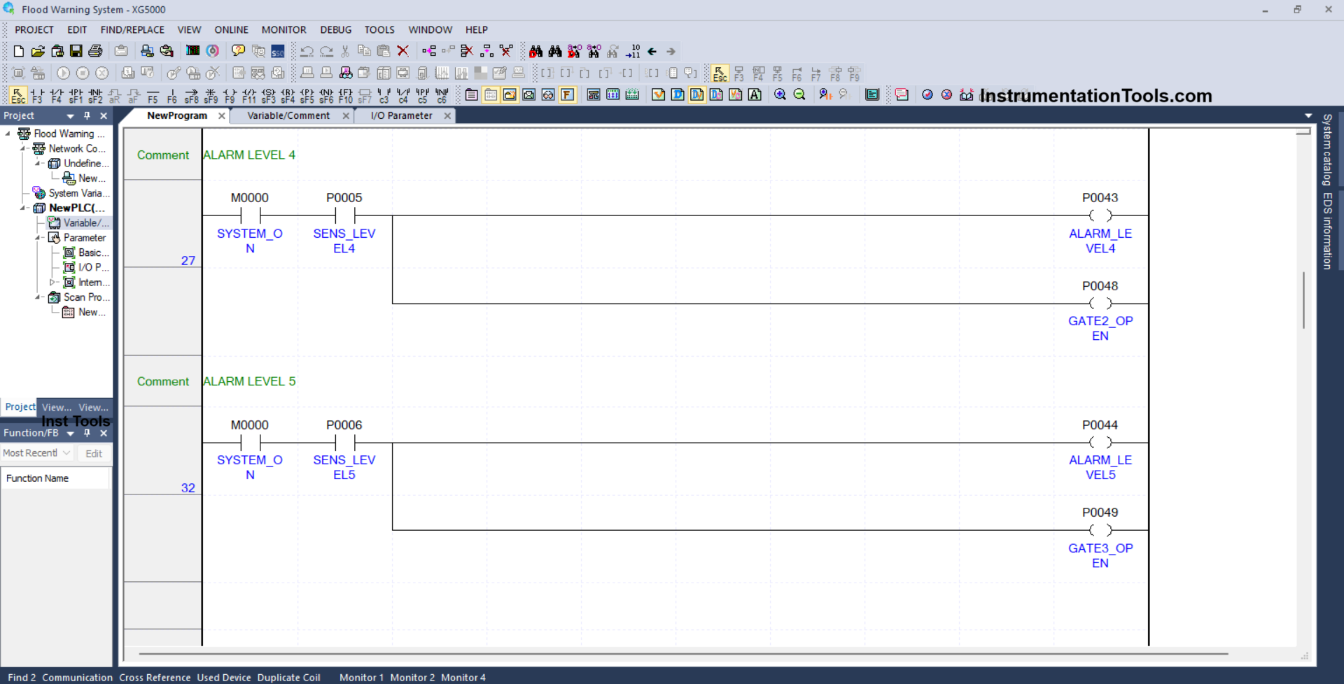

RUNG 27 (ALARM LEVEL 4)
In this Rung, the output ALARM_LEVEL4 (P0043) will be ON and the output GATE2_OPEN (P0048) will be OPEN if the NO contact of the memory bit SYSTEM_ON (M0000) and the sensor SENS_LEVEL4 (P0005) are in the HIGH state.
RUNG 32 (ALARM LEVEL 5)
In this Rung, the output ALARM_LEVEL5 (P0044) will be ON and the output GATE3_OPEN (P0049) will be OPEN if the NO contact of the memory bit SYSTEM_ON (M0000) and the sensor SENS_LEVEL5 (P0006) are in the HIGH state.
