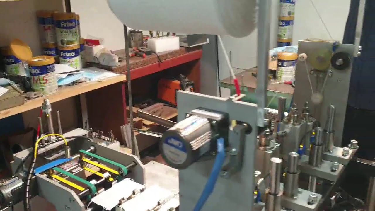

This article mainly focuses on the PLC-based mask-making third-generation machine using Wecon PLC and HMI.
The following are the different parts of the face mask machine.
Main Body of Face Mask Machine
Here mainly system works on the materials of the face mask. All the required raw materials will be collected.
The press material slice, that is to say, fold, press, and cut the non-woven fabric into one piece.
The main parts of this system are a PLC, HMI, VFD drive, photoelectric sensor, relay, and contactor.
ItemModelQtyDescription
PLCLX3V-1412MT114 Inputs, 12 Outputs
HMIPI3070i1RS485
Distributing Mechanism of the Face Mask
Pressing slice: feeding, that is, turning over the mask body after pressing the slice and sending it to the next stage for processing.
The below equipment is used for this process.
PLCLX3V-2424MT124 Inputs, 16 Outputs
HMIPI3070i1RS485
Face Mask Elastic Belt
After pressing and cutting the face mask body, the elastic belt is respectively welded/stitched on the left and right sides of the mask body and then automatically wrapped.
Face Mask Making Machine using PLC and HMI
The first generation face mask system is mainly composed of one servo and multiple cylinders; the third generation system is mainly composed of one servo and three steps to replace some cylinder functions.
The required components for this process are mentioned in the below table.
PLCLX3V-3624MT236 Inputs, 24 Outputs
IO ModuleL3V-16EYT2
HMIPI3070i2RS485
ServoVD1-075SE1G2750W
First Generation Face mask machine-related Components
HMIPI3070i2RS485
Third Generation Face mask machine-related Components
Mask Packing Machine
The equipment is mainly used for the packaging of finished face masks.
According to different feeding methods, the system can be applied to the machine with a chain and push plate as the feeding shaft and the automatic material handling machine with a belt as the feeding shaft.
WECON HMI Application in Face Mask Machine
By collecting the blanking signal of the respirator packaging machine, and online production with the respirator machine, a respirator packaging production line can be formed, which can greatly reduce the number of workers who place the packaging manually (at present, most of the control systems on the market can only realize the single machine function).
The below table shows the required equipment.
PLCLX3V-1616MT4H116 Inputs, 16 Outputs, 4 High-Speed Outputs
HMIPI3070i1RS485
ServoVD1-075SE1G3750W
